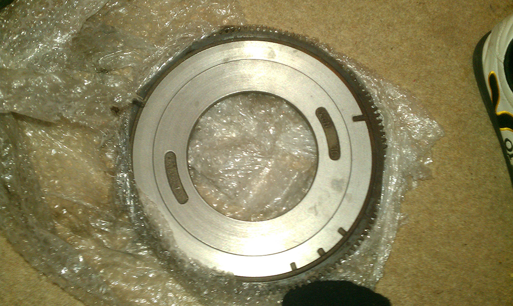

Does anybody know the standard weight of a verto flywheel? I had a go at lightening last night at work and got it down to 4.54 with ring gear
Is this good I should have weighed it before hand but time was short :)
Cheers Rick
Rickus
168 Posts
Member #: 9709
Cirencester, glos
This is it :)
