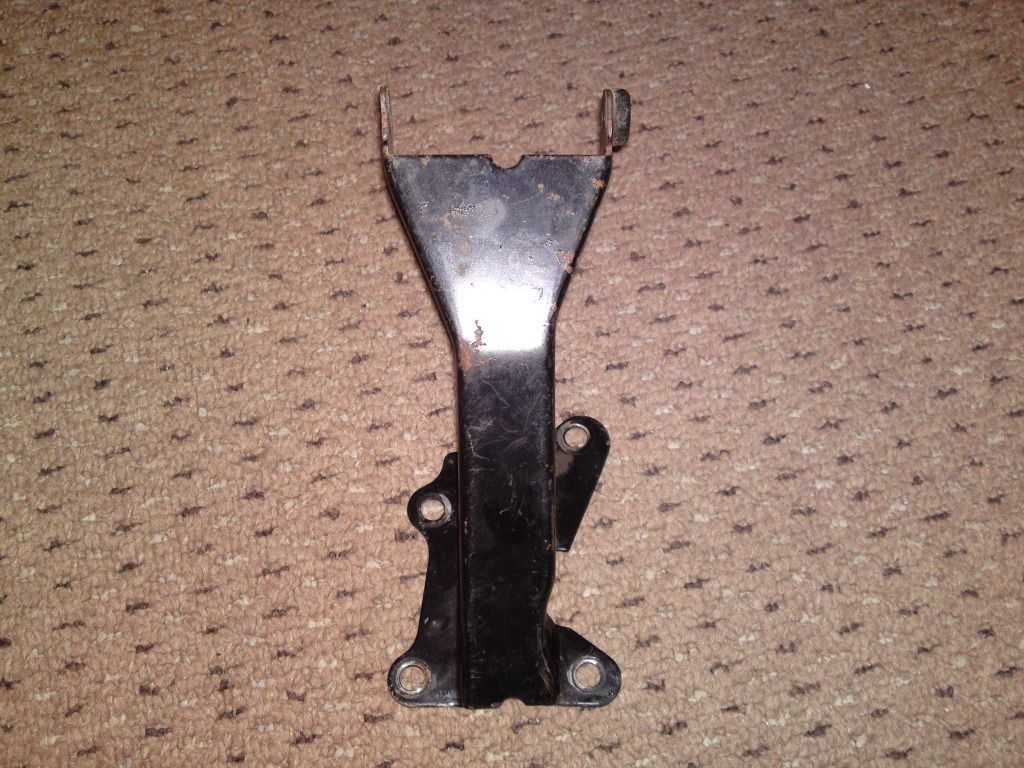

anyone seen one of these and know how they fit it came with a sticker on it saying mini clubman it seems to be the right angle for the clubman rad but nowhere for the engine mount to bolt to. is there a different type of mount i can use? really struggling to get a standard clubman lower rad bracket

Is that not just missing the long bolt that goes through the top for the rad?
The turbo build has finally started
Liam - there is nowhere for the engine mount to bolt to by the looksd of it; is it possibly off an 1100/1300 with a different engine mount position?
Can you not just cut and adjust a standard bracket?

yea i think im going to have to cut 1 will have todo it when i do the engine change. This bracket also remover the ally block on the side of the gear box

Thats very similar to a mk1 bracket, (green one top right) here. Offer it up to the engine/subframe, I bet you could just drill 3 holes at the bottom of the triangulated part then just weld some captive nuts on the back.

Just weighed the one top right in Simon's picture - 831 grams
Standard bracket with the alu block on the gearbox - 1255 grams.
Not a bad weight saving. will be even better after I've drilled some holes in it...
