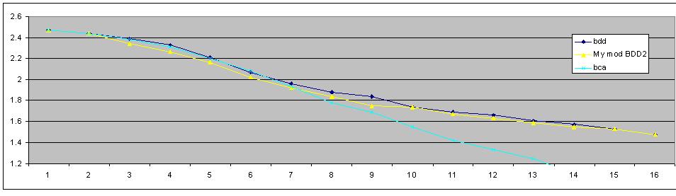

here we are,
these are actual measurements of the needle thickness measured every 3mm
i have searched the entire list on the link benny put up in the past, i have a rough idea of the shape i need but nothing off the shelf comes as close as the BDD i am still leaning out higher up but have a boost creep problem to sort before much more tweaking of it the carb will never read stations 14+ due to the mechanics of it so ignore anything after that
Edited by Brett on 13th Mar, 2012.

thanks Brett, thats very useful.
