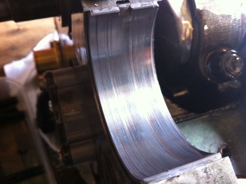

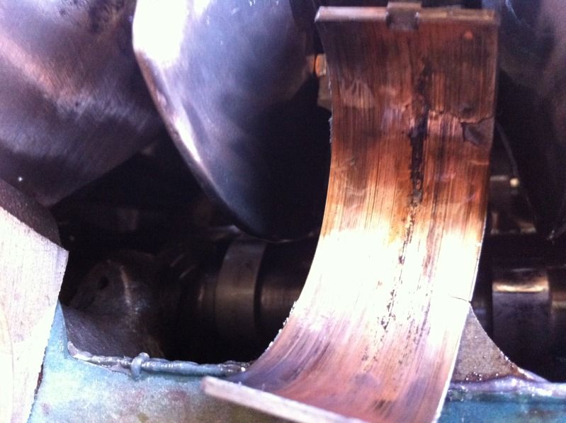

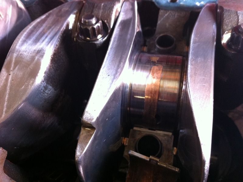

Right, after checking everything i possibly could with the engine in i have now taken the engine out and found the problem. The centre mains bearing has wiped due to no lubrication. I have taken the pressure relief valve out to find a lump of swarf behind the ball, meaning that the valve could of been stuck open and starving the crank of oil. The crank doesn't look to bad so hopefully a quick polish and some new bearings and it will be ok.

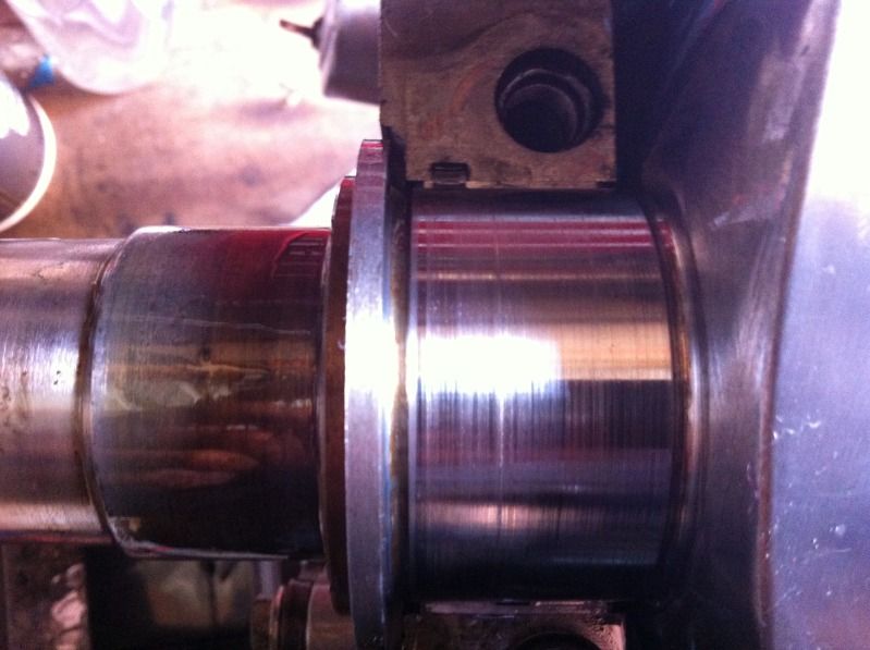

yep it must be from me machining for the dry deck. Although i was very careful. The crankshaft i think is now scrap because i noticed the flywheel has fretted on the taper and mullered it. Also there are a few scores on the big ends as well. So it will definitely need a regrind at best but not so sure about the taper

Get some pics of the taper up then!
