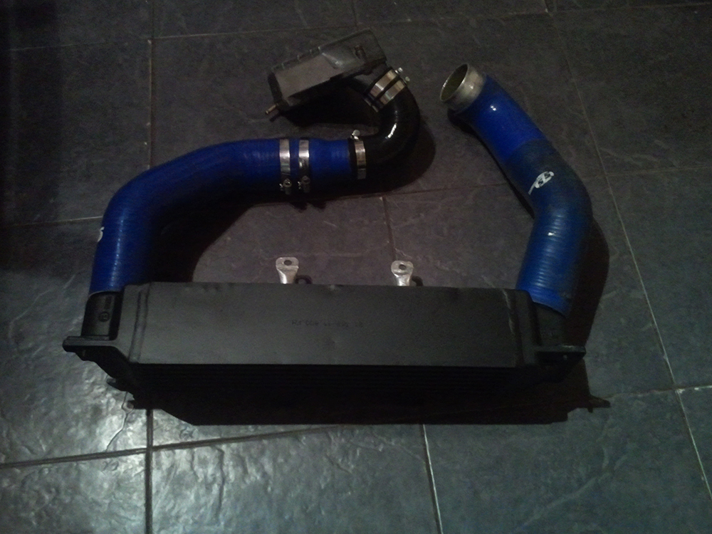

This is how I had mine on the frog:
a

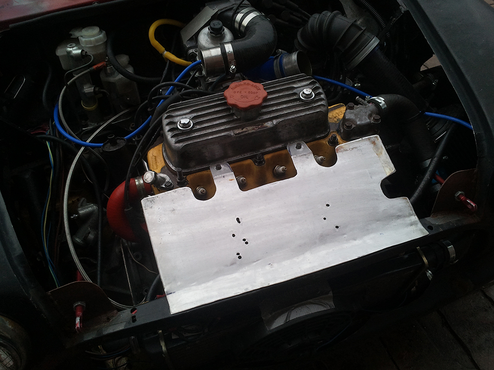

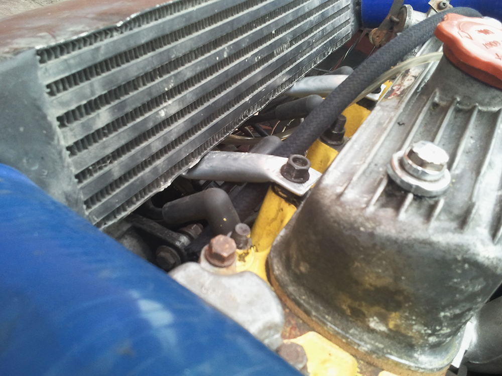

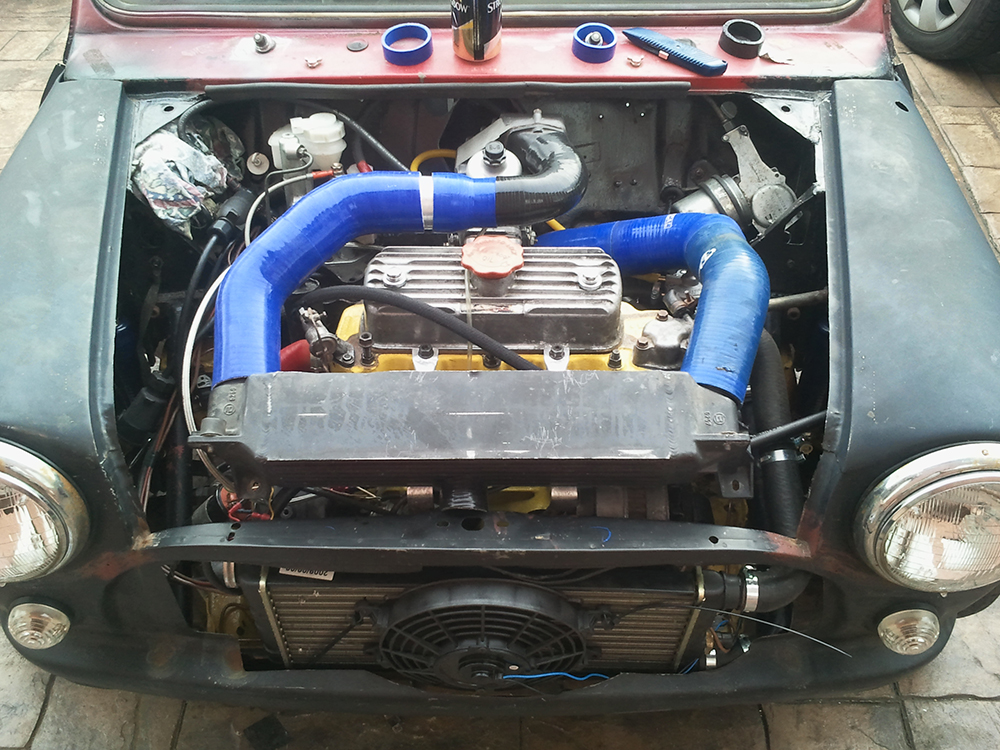

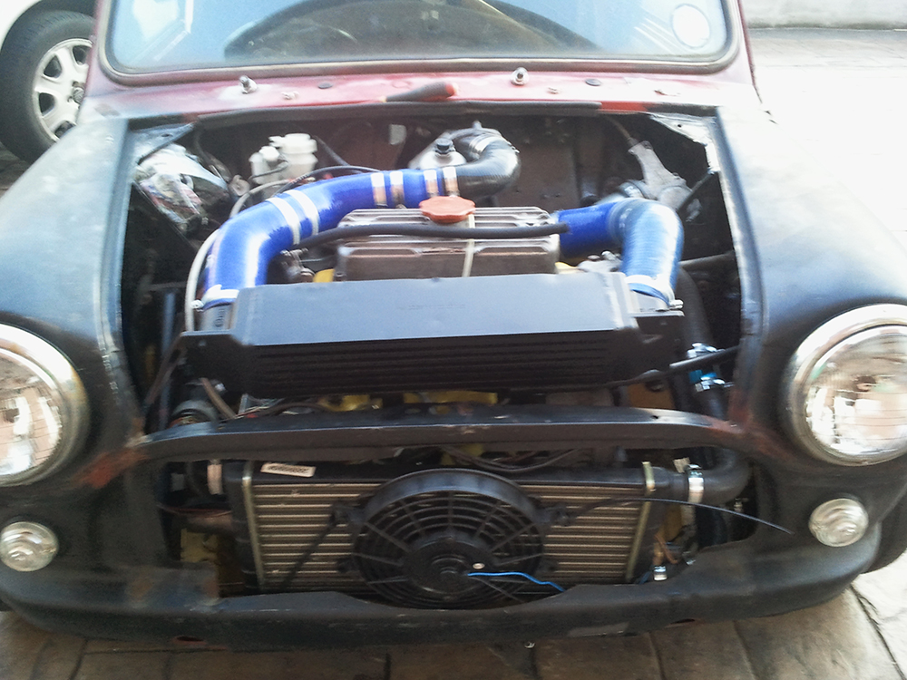

Made some small brackets for mine, should also be on my build thread.
these are my mountings mk1, i changed the 2 tubes for a sheet of ally that extended from the head studs to the slam panel mainly to help reduce heat soak. squashed tubes are literally screwed into the intercooler
the whole intercooler sits on/ bolts to the sheet ally in the last pic but now thats broke i will go back to the initial design with the tubes and some fibreglass ducting the whole intercooler will be essentially in its own little world *happy*, air in the front and out the top
