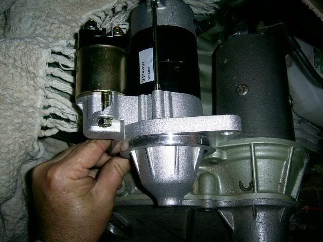

2.55kg for this type (including solenoid).
Saves heaps of room too over the Lucas inertia unit
On 24th Dec, 2008 Nic said:
One person says 3.8kg, another says 2.55kg. That is quite a difference, or is that not a standard pre-engaged unit?
I don't see how the pre-engaged saves room - that solenoid sticks out a long way???

I have a rover/honda 'hi-torque' starter for inertia ring gear converted by Eric (Wil H's chum). It weighs 3.9kg.

I know that. I got it because it's nice and compact against the block.
Good enough reason

Have you got a photo Andy? Keen to see how much space it saves.

Correct me if i'm wrong, but the hi-torque ones have a terminal in the front, so assuming plenty of clearance for this against an alloy intercooler, how much "front" room do you guys really think is being saved over an old inertia unit?
