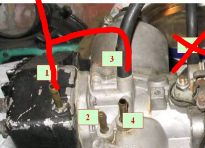

And ill make a pic of where to.drill

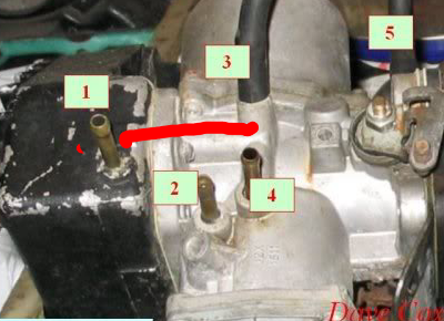

1 and 3 are linked internal on a turbo carb but not an NA carb (red line ) the hole is there on the NA but is not complete all the way through .. 3 then needs to be blocked
Bare with me these are made on a phone *happy*
There is no lean off on the NA carb so this is easy to do (drilling requires removing the carb)

righty. i went out today and realised the drilling dosnt go through from the plenum all the way. i decided to drill out the blank #4 and insert a stub and connected that to the t piece trick. ran loads better and even revved up. still coughing and spluttering a bit plus its a bit smokey, sure a correct needle and a set up on the rollers will be good!

right so you have drilled and inserted a no/4 what you done with 3/7?
it still needs to be blocked or it will act as an infinite lean off when on boost, i know because i use my ecu to control the flow through this when cruising
if you apply a vacuum to it whilst on cruise same again it leans off this can be controlled to give very good mpg
eg i do this and aim for around 16-18afr i get 45mpg @70m mph then when i floor it the ecu takes over the leanoff and the carb feeds fuel via the needle and jet
