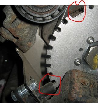

Set the engine to top dead centre on compression stroke with the missing tooth at 12 oclock, count back to the 9th tooth your senser should be set to the centre of that tooth.. Alan

I have checked the static timing and at tdc the missing tooth is inline with the sensor. Which is in position with the triggerwheels bracket.

At TDC the missing tooth should be 90 deg after the sensor shouldn't it?

thats not right mate, missing tooth at the top, senser should point to the 9th tooth back
