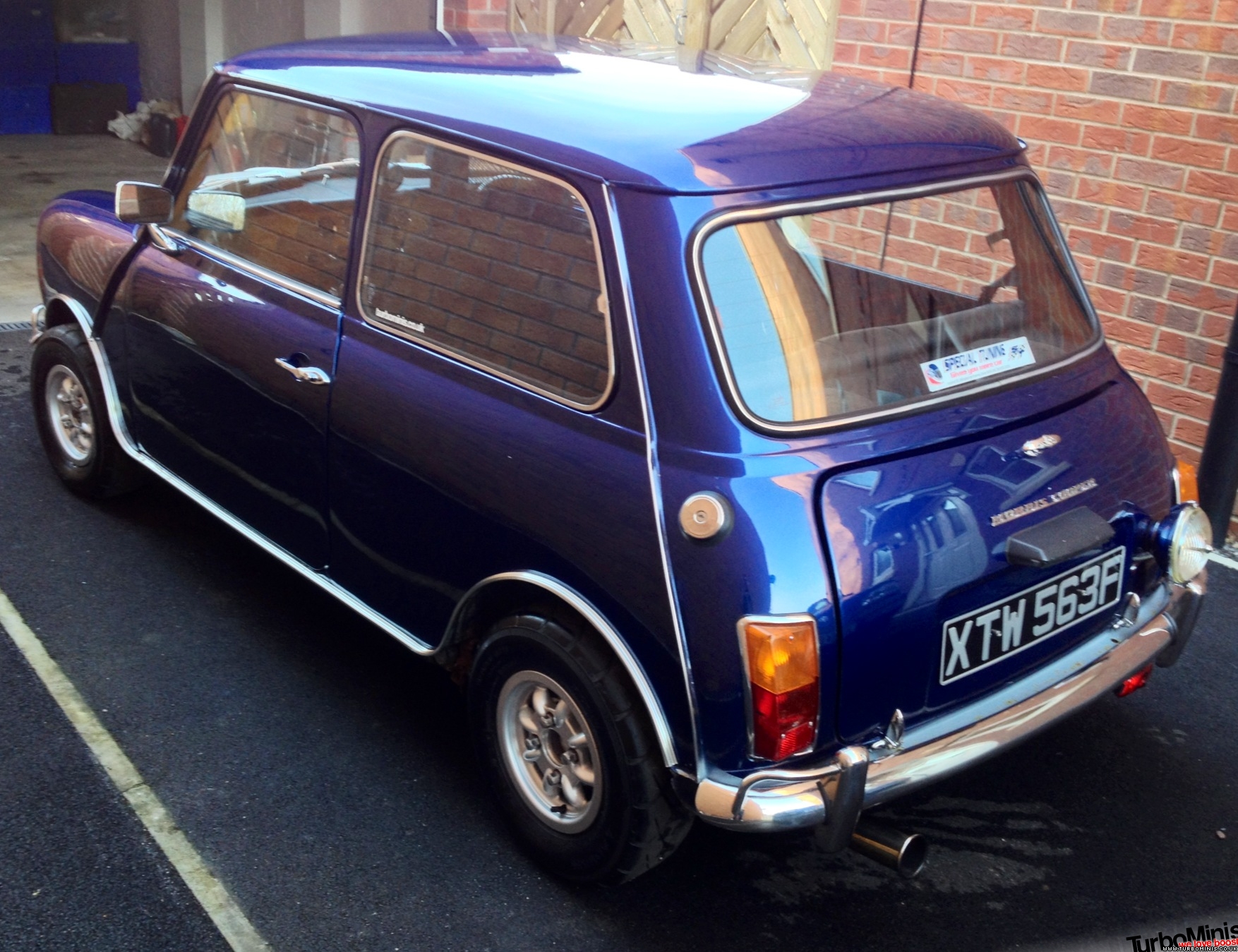

I'm sure some already know this but during last weekends TM Swap Shop when Rob got his Metro, Andy got his Pond Liner and someone else got a new toy *wink* I acquired this little beauty from Oli.

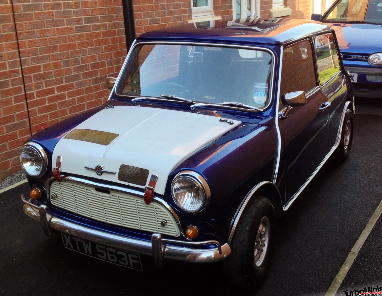

Plans are to keep it looking as it is now, although I'll probably go back to a MK1 Morris Cooper Grille. It has come with some paint so will get the bonnet in colour too.
I also love the retro dash Oli made for it *smiley*
Many thanks to Wil_h for his transport services!

Lovely looking car, but will you be able to put a standard bonnet on there, painted to match ?
I'd like to put a standard bonnet on there Dave, however it would really need some sort of ventilation in it for the intercooler.
You need to adjust the wipers.
It needs an engine first *wink*
