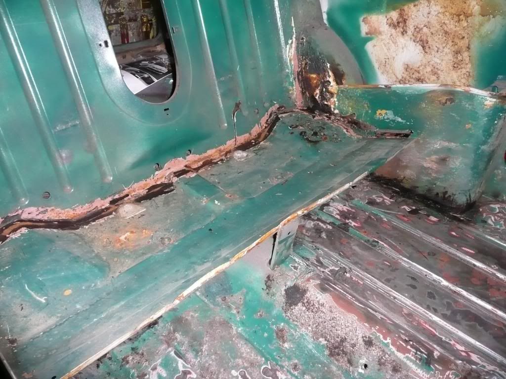

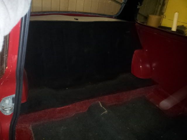

I went to install mt mini seats for a quick look at whatvtgere goin to look like but then realised ive a panen missibg or thecinterior doesnt fit. My back seat seams to have nothing to dit on. Its a 1985 mk3.
I took a picture off google of another car but need help on whst the panel is and where il get it or a link to itbon minispares
Can anyone help?
This is my red mini
http://i1300.photobucket.com/albums/ag94/c...zps7181e3fc.jpg
And this is one i saw the panelnon i need to sit my seatbon. Looks like he just welded it in ?
http://i1300.photobucket.com/albums/ag94/c...zps3cbccfea.jpg
Any direct linkscto the part ir details on how to sort it out much appreciated.

seat base and bins have been cut out, its a fair bit of work to put them back in

Looks like the "shelve" has been trimmed back and the pockets removed.
If you really want to add the weight back in, I would get the measurements of a whole rear seat panel, cut a piece of steel to match the bit you need and weld on and add brakets at each end as well as the middle and not bother with reinstalling the pockets, what do the lower outer ends you seat belts mount to ?

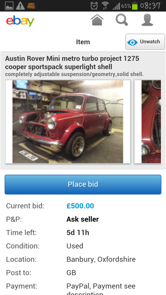

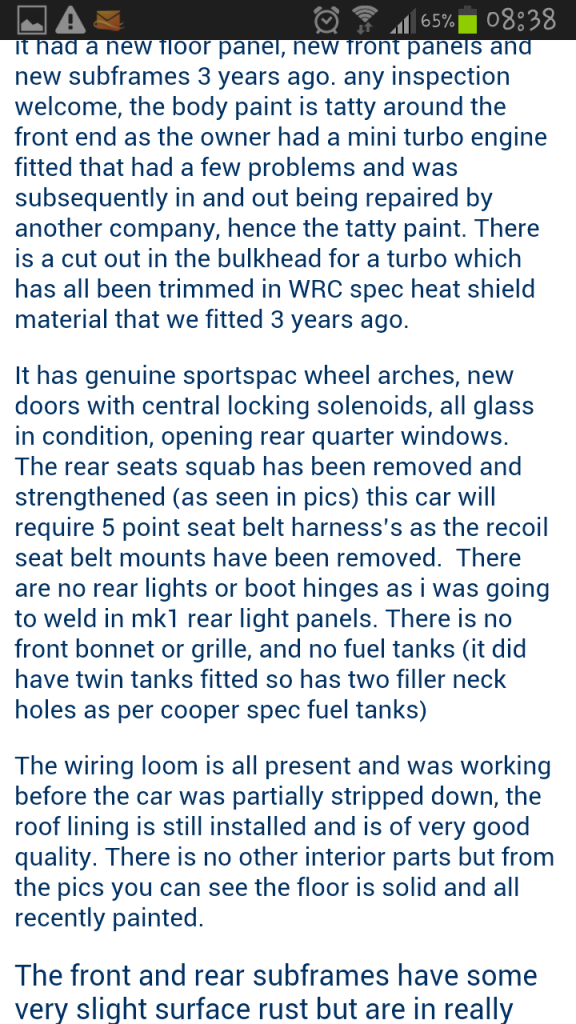

http://i1300.photobucket.com/albums/ag94/c...zps54b520dd.png
If you look through my photos on photobucket yous can see the full write up off ebay when i bought it.

Clearly states in the auction its all been removed, the advice has already been given you need to reinstall the pockets and seat base if you want to run standard seatbelts otherwise you are stuck with race harnesses
