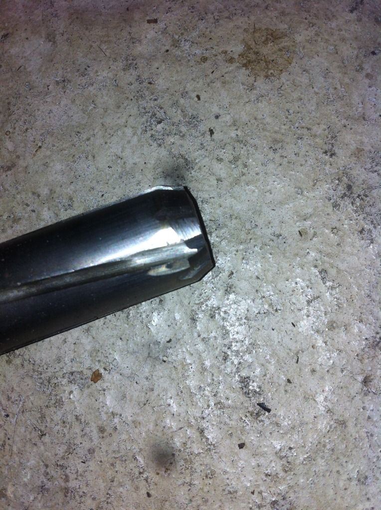

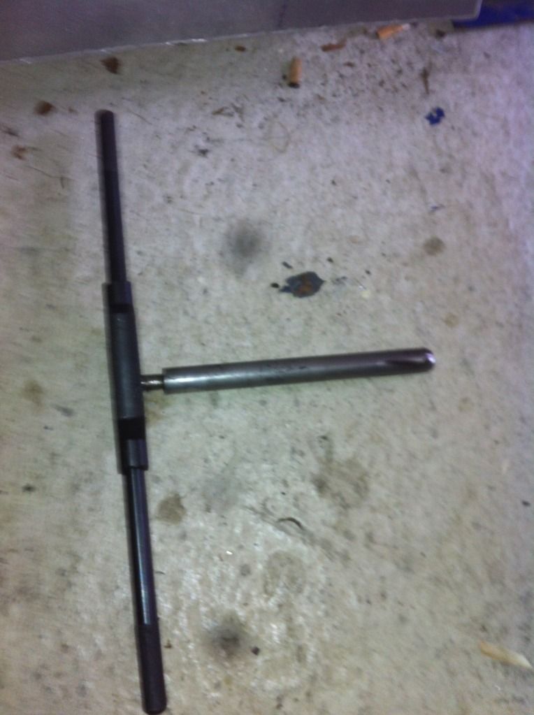

Baz_rsp
131 Posts
Member #: 10521
Aberdeen
Here's the one I use/ made. Just use a big tap wrench to work it.

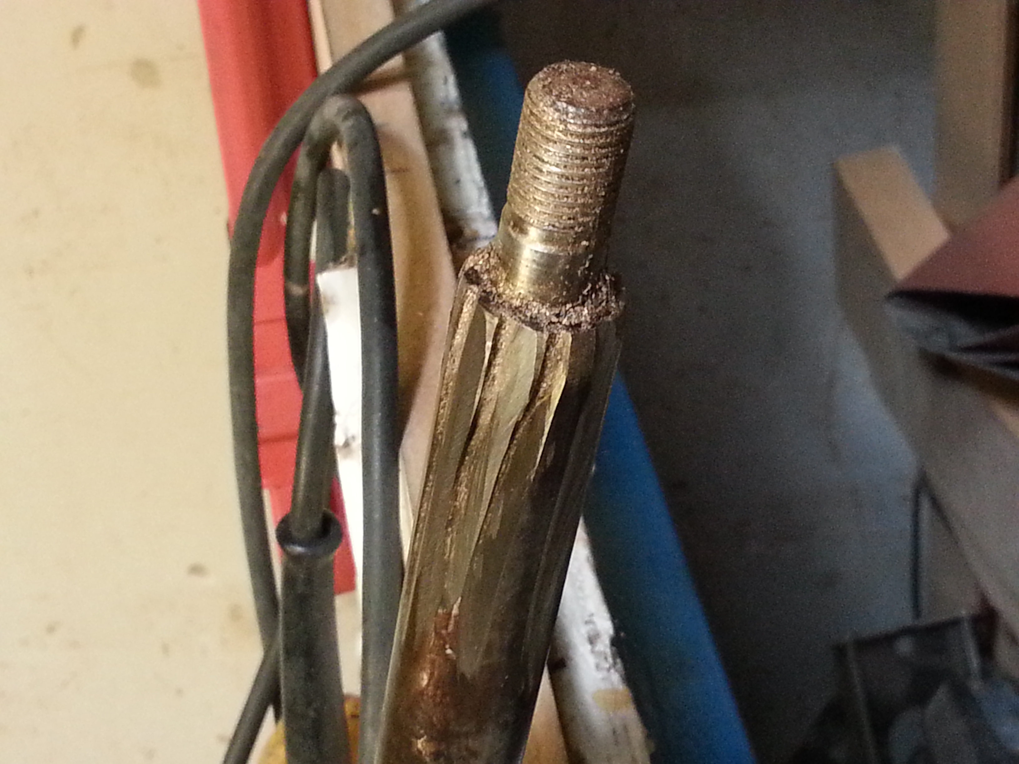

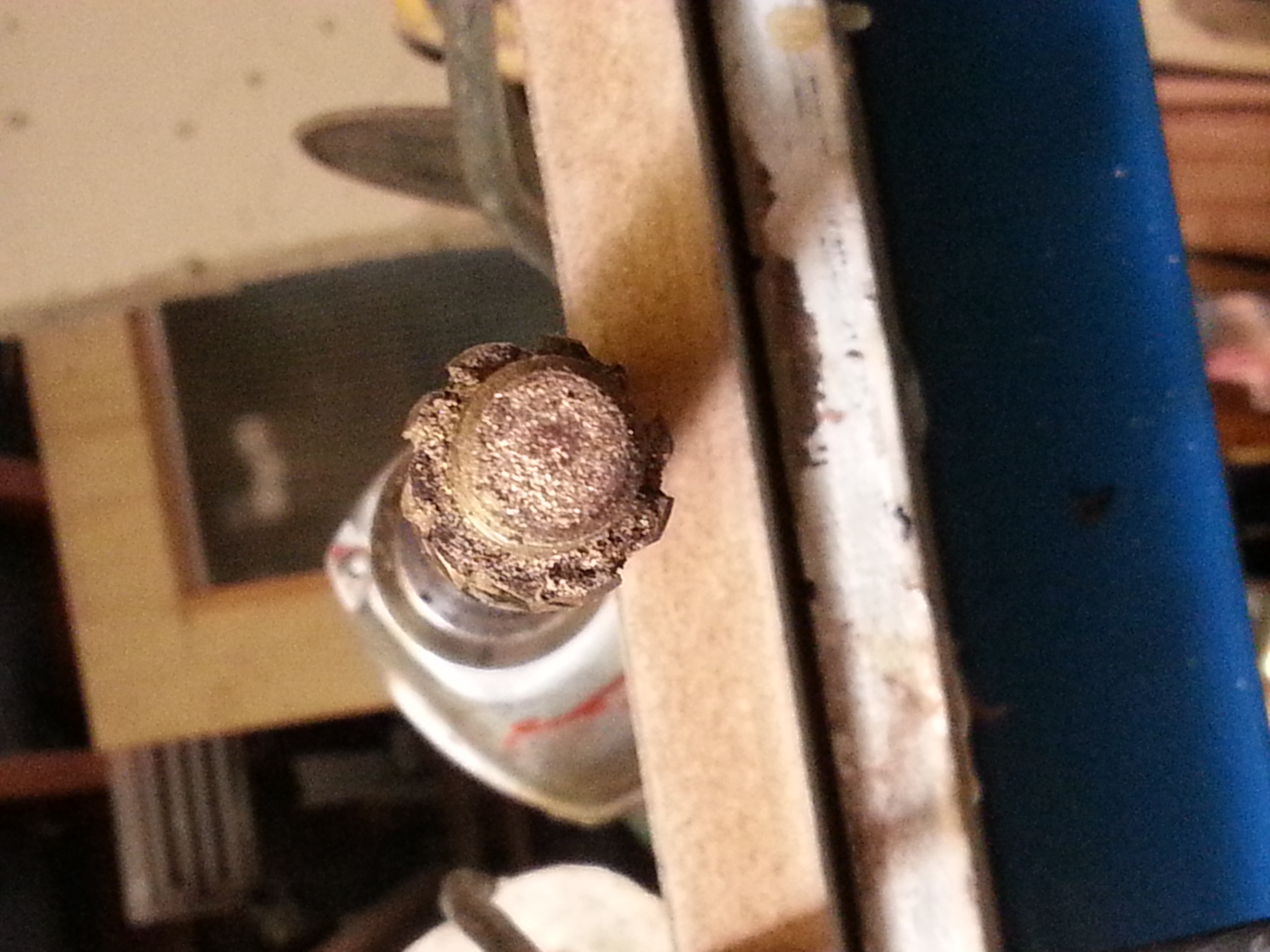

Rammie2000
1751 Posts
Member #: 10190
belgium
So this is it. Made the top a bit in a cone so it would centre and then cut in angled grooves with an angle grinder and a thinblade. Put in on a dril and let it turn slow with slight ppressure and some wd 40 sprayed in to keep it cooler. Basic yes but works like a treat. . It toke me 40 minutes to find the old axle 15 minutes to make one. Finally the rear arms ar assembled!
