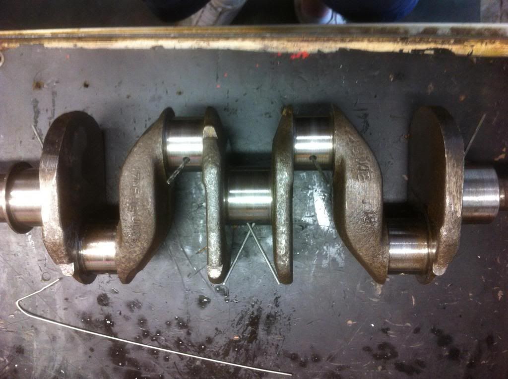

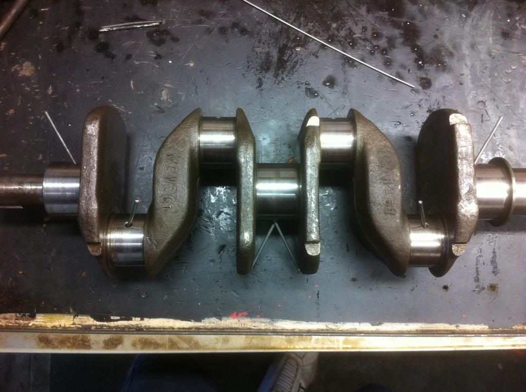

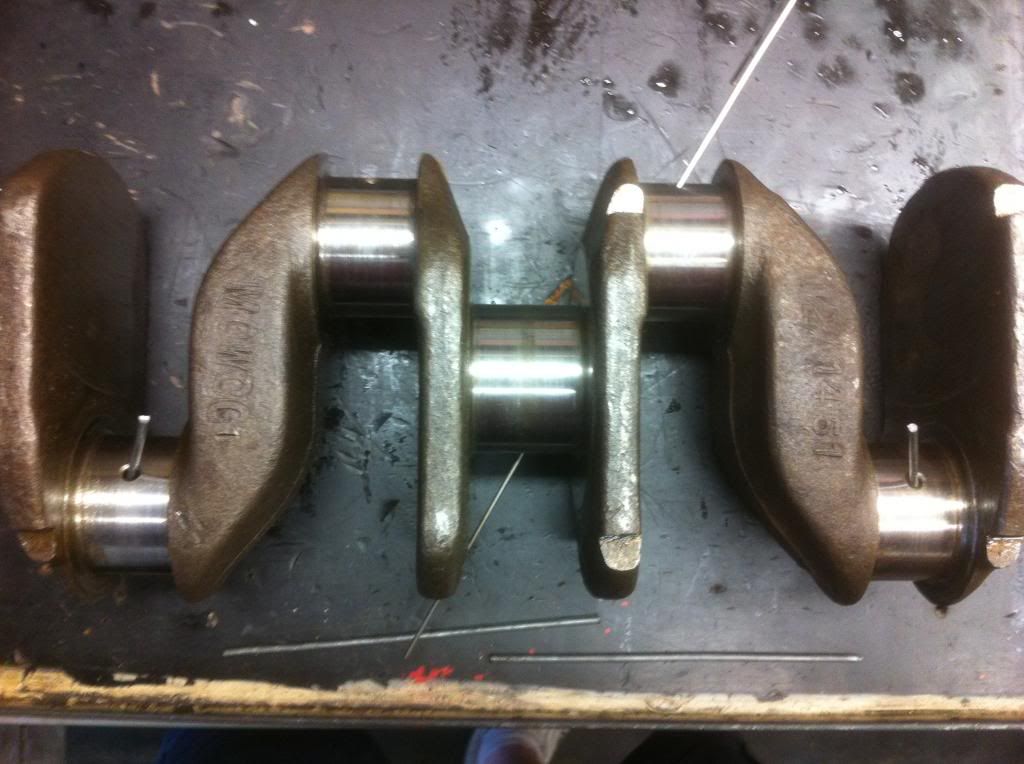

lest start with my main concern the mains as seen in the link it seems well know that the big ends draw oil from the mains via centrifugal force so in my mind we need to ether restrict the big end flow or increase flow on the main two options said many times in the search function so how do we do such a thing?
i think i dont like the idea of restricting oil as that may lead to problems!

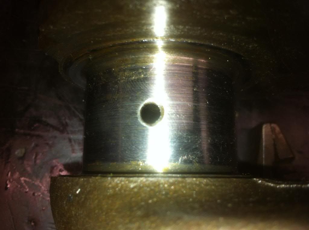

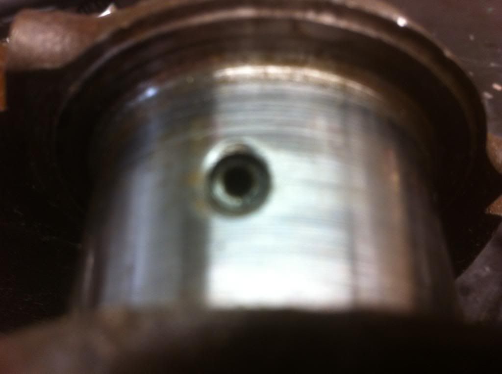

looking at the crank i see what looks like a restrictor in one of the holes on the big end this hole goes right throw to the main the other hole is only intersecting the other
i think you want to introduce oil to the big end at bdc just as it builds compression and also as it passes down on the first half of the power stroke or in other words just before/in front of the bearing is at max load
as for the mains im thinking i will use the grove all round ones to give a constant equal film also so long as there is oil the big ends will be feeding the big ends vs a plain bottom bearing that is mostly not feeding oil for half the cycle
to me it looks like its feeding oil behind the peak load? is this because it takes time to flow

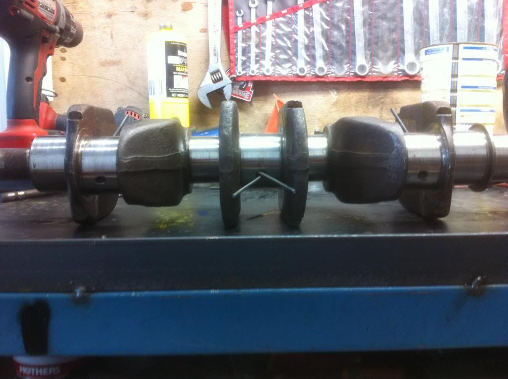

After my center main bearing failure, I went mad reading up on plain journal bearing lubrication in an effort to better understand why it happened in the first instance (forgetting that Oring for a minute *tongue*).
I cam to a conclusion quite quickly that the average cross drilled crank might actually reduce the load carrying of the big ends. This was because as you have pointed out, the oil feed hole is now in a highly loaded region during the power stroke. once I understood this, I have not used a cross drilled crank. Is there any real need to? What you do have to consider is that the center main bearing supplies two big end journals while the other main bearings only supply the one. This means that the center main bearing has to flow twice what the others do. The cross sectional area of the center main oil feed is much the same as that of the others two. This is the main restriction to oil flow.
I have spoken with a couple of wise and wonderful people on this subject and they both said the same thing without being asked. Open up the center main oil feed.
Don't go mad with it, as you only need to increase the diameter of the feed a little to increase the cross sectional area a lot.

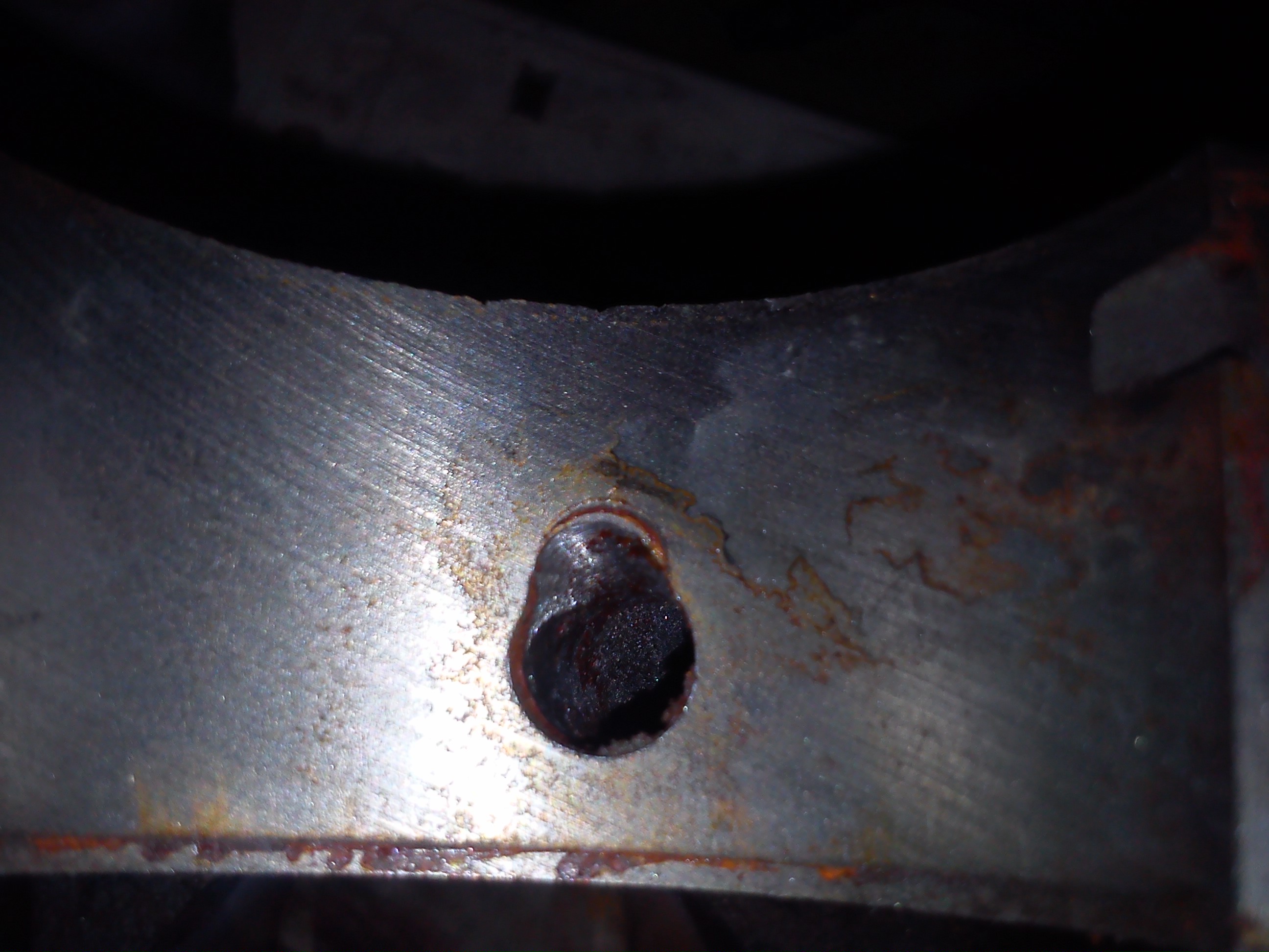

The end bearing near the clutch end needs dremling out ill grab some pictures
Before anything I've decided to get a high capacity 'turbo' oil pump, that way I know I have plenty of scope for anything like this when the time comes.
Chalkie
1909 Posts
Member #: 9764
Northamptonshire.
grinded it out so it matches the bearing hole
they are way out on small bore engines, half the hole was coverd before I did this needs a little bit more but other than that should help
Also going to do Oil pump end aswell

My mains cap and bearing holes were miles out. I eased the holes out so that the lined up with the bearings. At one end it was nearly 3/4 covered..

Do many people drill to the other side?

What way dose the oil flow down the crank?
When Nick Swift first built my engine he told me cross drilling is a waste of time, that crank did thousands of miles over 7000 rpm and up to 9000 very often

The fact remains that the cross drilled crank pictured above has been done wrong putting the oil feed hole on the big ends right in the high pressure region of the journal. Oil needs to be fed into the bearing on the unloaded side of the journal. The 'shaft' does not sit in the center of the bearing under load and it also tends to 'ride' up one side of the bearing in the direction of rotation. Oil is drawn into the loaded area of the bearing by hydrodynamic action maintaining the oil film that supports the journal.
While we are here, my center main bearing failure was just that, a center main bearing failure. The big ends were all fine. I used plain bottom bearing shells in the mains, so the theory that the plain bottom bearing starves the big ends in my situation caused no adverse effects even at 8krpm. Under crown cooling jets..... If they could flow more oil than the pump could deliver, then i'll eat my shorts. The BMW cooling jets have roughly a 1mm diameter nozzle which is equivelant to a 2mm diamter hole in the oil system. The other fact is that if the oil jets outstriped the flow to the center bearing, why did the oil pressure not drop, and why did the other two main bearings not suffer the same fate? (now that is a question, not a statement)
The MED crank I used had a 0.003" baggy fit on every journal had a lot to do with the failure, the baggy fit was said to be ok in the infamous yellow book, but then the auther spat his dummy out when I questioned it, only to contradict what he said in the book lol. The crank also had 0.0015" run out and cross drilled incorrectly, like the one above.
I knew nothing of how this would affect over all reliability as do alot of well known tuning companies (well at least with their every day punter stock). It wasn't untill I did some studying and reading up on the subject, not only for this, but also for a catastrophic failure of a high speed rotating machine at work, that I realised how wrong the cross drilling and baggy clearancies were.

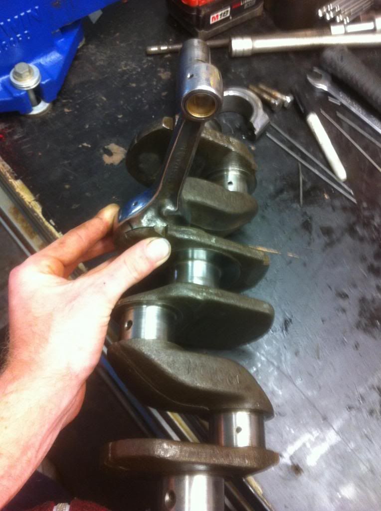

can we shed some light on the two holes on the big end? one looks like it has a restrictor in it? its a 998 crank in the picks..
