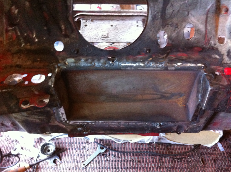

hello peeps basically as the title say is my turbo box fitted correctly :S cheers
You need to cut the piece on the right at an angle. There's a few threads lurking if you have a search.
Here's one... But there are plenty more...
http://www.turbominis.co.uk/forums/index.php?p=vt&tid=342979
medicalgradenitrous
37 Posts
Member #: 10620
what will hit it can somebody post a picture please :)

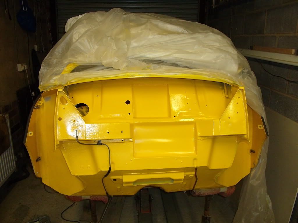

that was mine back in the day...

i see what you mean but what actually goes were the diagonal piece is ?? cheers

from the top of my head you will need room there for the air intake hose, possibly the actuator on a metty t3 setup, though its been a while since I had the metty t3 on my car.
dan
as dan says, make it as big as the one dan has posted you will thank your self later

Check out my thread. Speedwell t3 replica. Second pic on there should help you.
Edited by madonminis on 16th Oct, 2013.
The image of mine is missing in oneye's link as my photobucket account trashed itself a while ago.
Reloaded here
As stated above, actuator and a decent size/shape inlet hose on the T3.
for what it is worth, I don't have the angled section on mine, however I had the box made longer to start with.

looks like the sledge will be coming out haha

I don't have the diagonal section on mine either and never had a problem. But any space to be gained in that area will make life easier.
