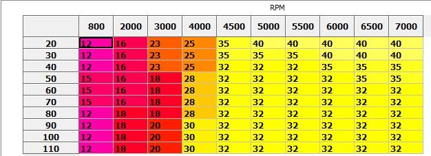

As for map i still have mine from the mini which was similar spec to yours.
There's a lot of 32's in there and still required some fine tuning but produced 106 bhp
