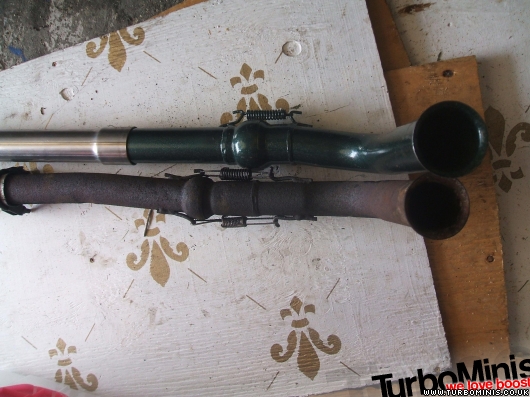

8th Feb, 2014 at 04:47:03pm
I managed to get out in the workshop today, and made a jig from my downpipe.

I managed to get out in the workshop today, and made a jig from my downpipe. What are people's thoughts on getting a 2 1/4" downpipe between the subframe and pot joint? What the mind can conceive the mini can achieve

Would 2 1/4" just sleeve straight onto a 2" exhaust? I'd be interested whether it be stainless or a modified Saab item If something is worth doing, it's worth doing half of. |

On 8th Feb, 2014 John said:
Would 2 1/4" just sleeve straight onto a 2" exhaust? I'd be interested whether it be stainless or a modified Saab item ![]() Same as what John said really. Iv already got the Saab down pipe just don't really have the skills or time to start grinding and welding it to fit. |

Ovaling the pipe could work quite well, but if its not needed, even better. lol

It fits Matty just a tight squeeze :) |

Would 2 1/4" just sleeve straight onto a 2" exhaust? I'd be interested whether it be stainless or a modified Saab item ![]() Same as what John said really. Iv already got the Saab down pipe just don't really have the skills or time to start grinding and welding it to fit. John has loaned me a Saab exhaust and when I looked at it, I came to the conclusion that i haven't got the skills to make it work and be a tidy install. Lol https://www.facebook.com/pages/Fusion-Fabri..._homepage_panel
