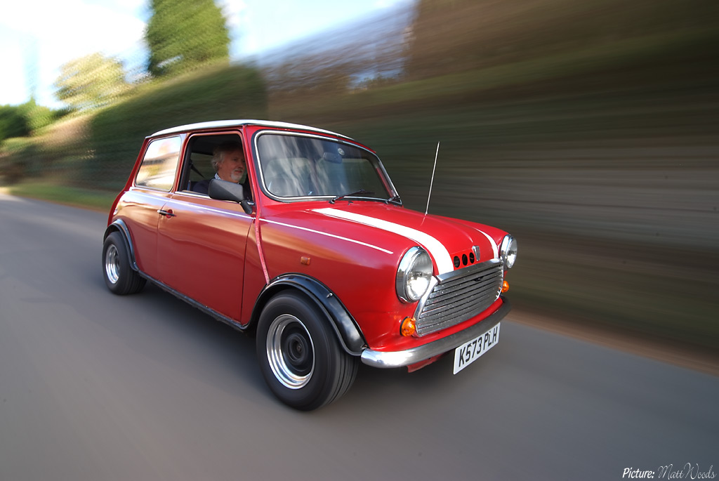

In it's prime:
All the good bits, apart from the engine are going on my new car *happy*

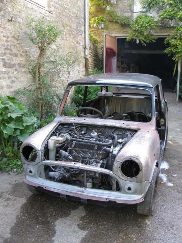

Long serving members will probably remember this car that I part prepared for one of the lads back in 2009. It has sat in the back of the barn since then.
Got it out and gave it a clean:

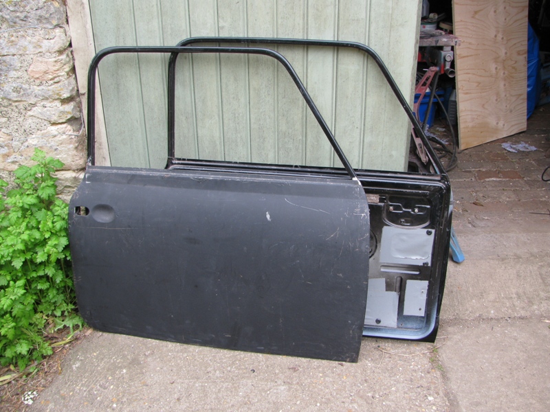

Fixed up the door frames and fitted new skins:

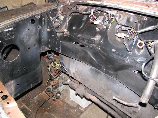

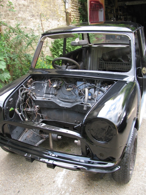

A bit of progress, engine and front subby out and a quick cosmetic tidy around the engine bay.
Needs another coat of paint, but that'll do.
I've removed the steady bracket as the remote turbo downpipe needs that space, plus I want to route the clutch hydraulics away from the heat. PDWA will also be located on the bulkhead.

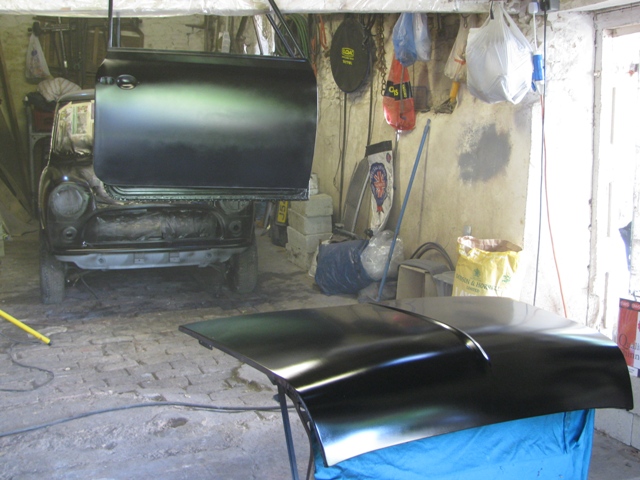

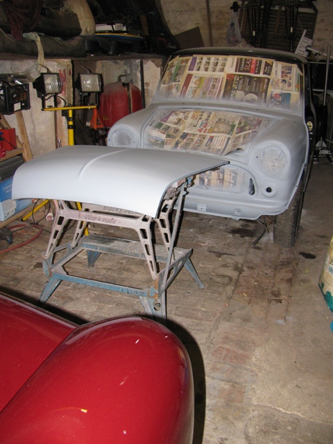

Started on the bodywork:
Lots of sanding and filling followed by rust inhibitor, etch primer and first coat of high-build primer.
Also primed the doors.
Next, dealing with all the minor imperfections, another coat of primer, then top coats.

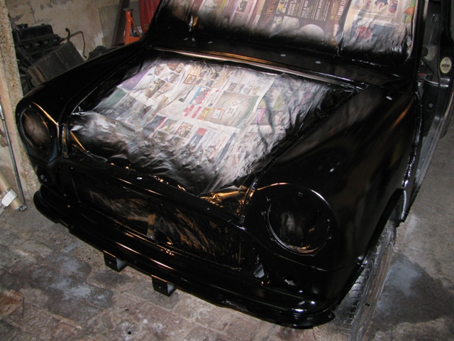

Getting the paint on *smiley*
1st coat of colour:
Now 3 coats:
Not perfect but not looking for a show finish.
Following the BENROSS guide here:
http://www.turbominis.co.uk/forums/index.php?p=vt&tid=9446
Tomorrow, flat it back and apply the finish coats using high gloss thinners.

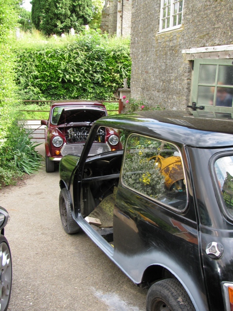

Tidying up the rest of the bodywork:
Drive busy today:
Your fairly getting on with this.
Yes, just realised it only a months or so since I dragged it out from the back of the barn.
We had been working on the 30 to get it mobile. Once it could be driven in and out of the barn with ease (seats fitted), then space became available to work on this one.
We've also got Sturgeo's Racing Flame sitting on my ramp since I welded it up 3 years ago. That's next years 250hp project.
