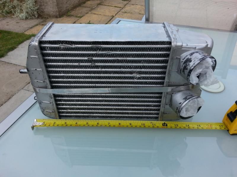

been looking at intercoolers and i am going to use a R5 cooler for a bit.
ive read up on a couple of things about it and one user said this "josh_tacon i think the r5 intercoolers are idea for minis, If there are flowed and strapped."
soes he mean in good air flow?
and strapped?
thanks

Ben H
3329 Posts
Member #: 184
Melton Mowbray, Pie Country
The thermostat needs removing. As for strapping, on high boost the ends can pop off, apparently. In my experience the cores actually split under high boost. Not a bad intercooler thouugh.

picked it up last night and its already strapped!!!
with shoe laces and zip ties :L

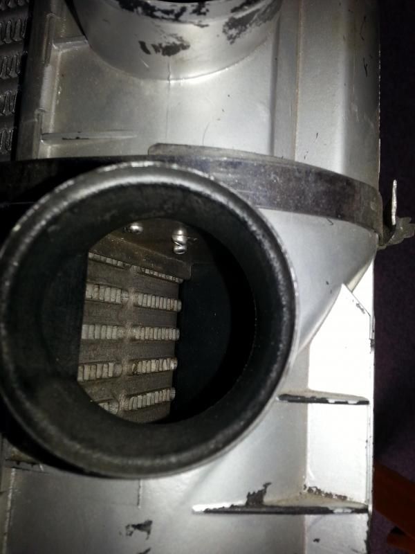

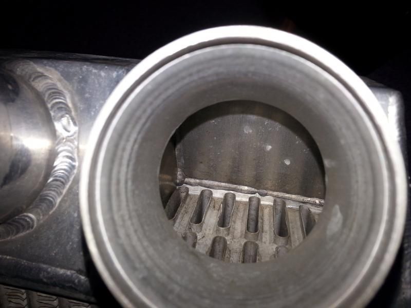

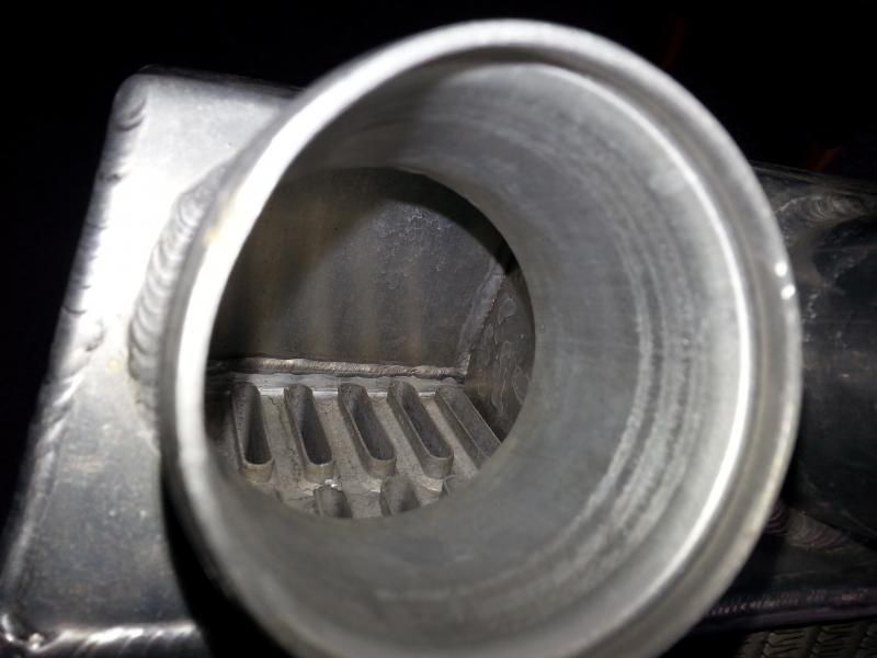

picked it up the other day,
is it supposed to have a gap between the ports?
stevieturbo
3597 Posts
Member #: 655
Northern Ireland
Jesus that looks rough inside.
WTF is going on there ? Has someone been filling it up with silicone or epoxy or something ?
R5 is a doddle to fit, I fitted one on mine 20 years ago.
Side mounted in the drives side inner guard.
The thermostat can be easily bolted into the open position.
End tanks can have a habit of blowing off, but it will depend on boost used. Say 5-10psi they should be fine...20psi+ and they will definitely need strapped.
Even at 15psi strapping makes sense.
Or just rip the plastic end tanks off and make up some aluminium ones instead. But if going to that trouble...probably no sense tying yourself to the R5 core unless it's cheap.
I know that's what I thought :L
Is it meant to have a gap there though?
stevieturbo
3597 Posts
Member #: 655
Northern Ireland
The picture is very difficult to make out.
But an R5 intercooler is a dual pass.
Air travels up one half, into the open end tank, and back out the other.
The tank with the two pipes is divided.
Havent a clue what that picture is showing other than a huge whack of silicone or something

coopdog
330 Posts
Member #: 9628
Yeah this one isn't divided, there is a gap at the bottom of the devision, I'm guessing that gap isn't supposed to be there
stevieturbo
3597 Posts
Member #: 655
Northern Ireland
Nor should whatever that thing is in the middle !! lol
If it's that rough inside,...it must be pretty terrible looking on the outside too ?
9.85 @ 145mph
202mph standing mile
Does that pic not show part of the divider missing?
If so, then it'll be useless.

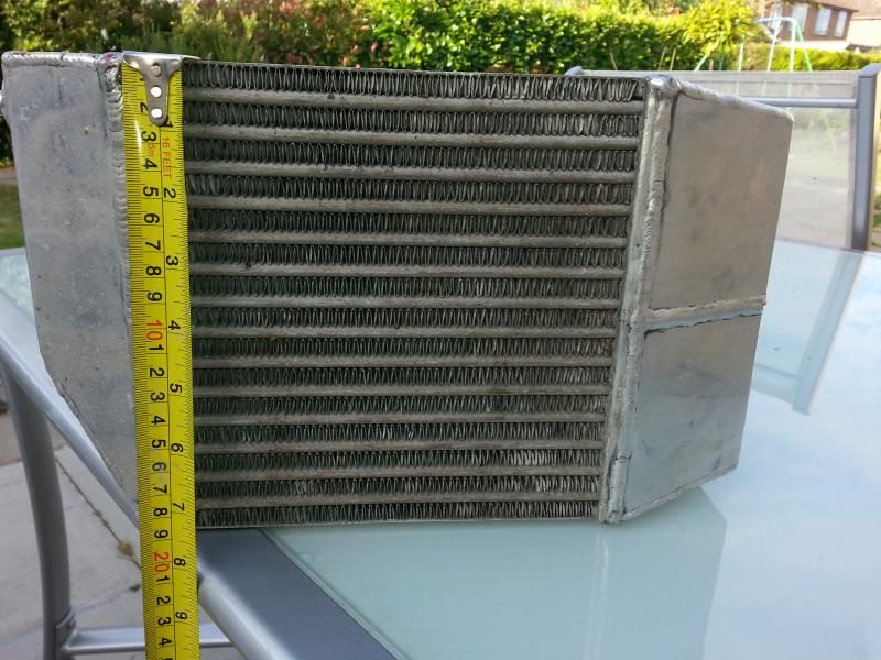

Not sure I would trust that with what looks like fibreglass filling where thermostate would have been. I have a flowed and strapped (with a giant jubilee clip) R5 that you can have for beer tokens or a pace ally one for £15. Could send pics if your interested
-MINI CLUBMAN 1380 TURBO-
coopdog
330 Posts
Member #: 9628
yeah mate that would be awesome,
and you pm me pics of both please?
thanks *happy*
