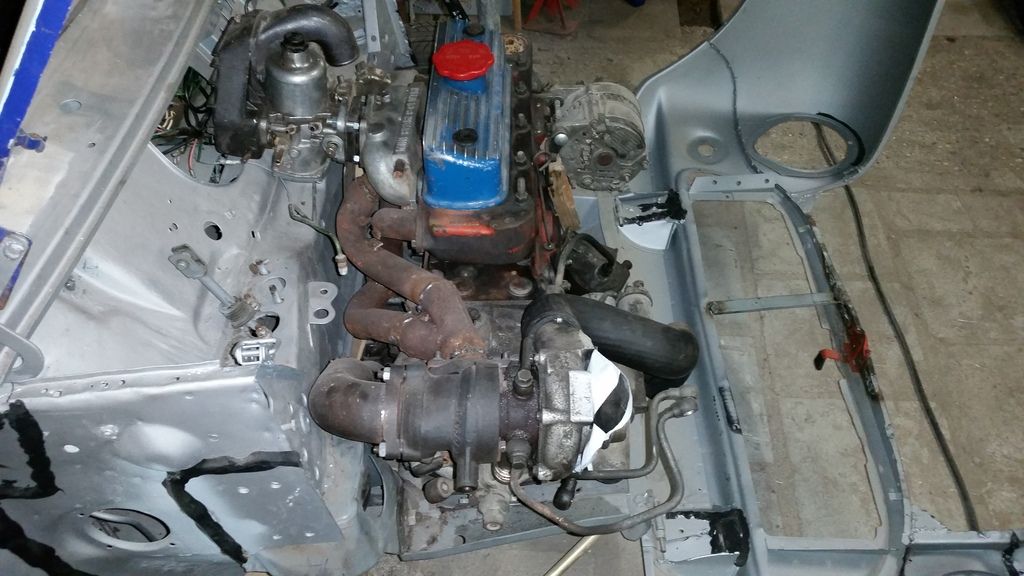

Is there an ideal length for an turbo exhaust? And how much damping is needed to make slilent enough so your ears won't bleed. I have some clearence issues and have to options. 1 i re - drill the holes in my galvenised subframe but then I'm worried about the space to the front. Or 2 i take the exhaust down the wing drill it trough the a panel and leave it there. Maybe with enough room for a small motorcycle damper.

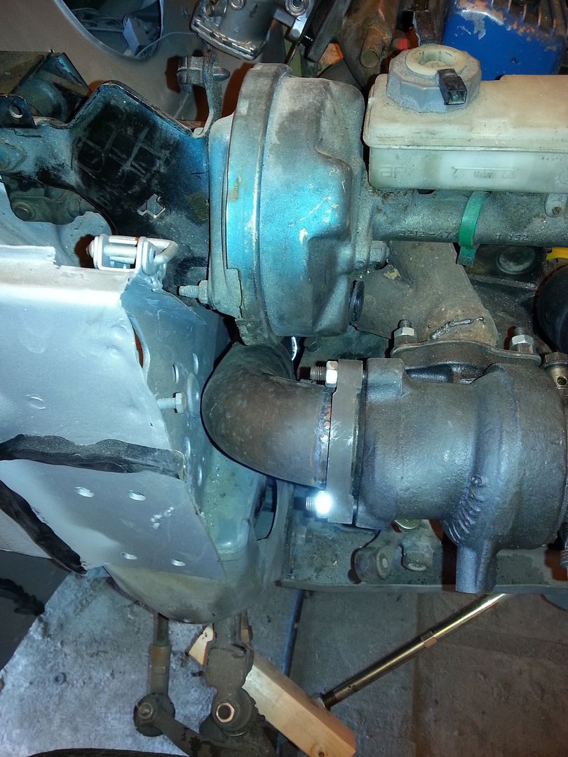

Could i have the holes like from a mpi frame. But thing is. That only leaves me with about 12 mm of free space between the exhaust and the body. Once wraped in heat wrap wont be much left ( bit over 2 inch exhaust pipe. ) can go and tilt the engine more forward but then the alternator and starter engine get realy close to the nose and grill. Not impossible though. But was lookinginto the options.

I would have to take a look for pics but as being thight it looks the same as the pics in Paul s his tread ( link)
Looks closer than it is.
Full mockup ( old exhaust used to find al the bends and twists hollow engine to. . )
Bend commes from a original saab exhaust but is shortened. ( nearly 60 mm)
Servo is out. No longer keeping that.
