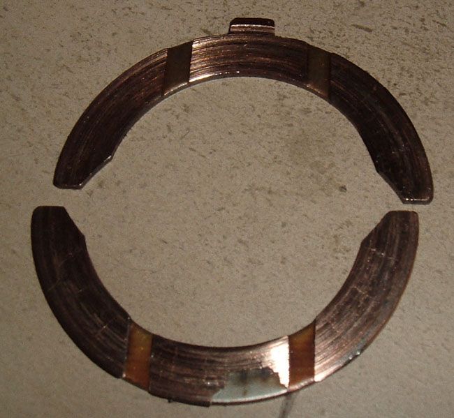

Alright, new similar problem, I have an just built engine here, checked crank endfloat myself, and its good. But still it stalls when clutch is depressed, what else can this be?????
So André what was the reason for the rpms dropping?
miniminor63
1849 Posts
Member #: 672
The oversills police
Oslo, Norway
you like to pull my leg dont you VeRg? I will admit I was a big jerk and had one of the thrusts the wrong way around, luckily I understood it early. Will post a piccy of the thrusts later on.
miniminor63
1849 Posts
Member #: 672
Oslo, Norway
Nice eh?
cranks okay though, as I used the clutch only 10 times before I understood that something had to be fundamentaly wrong*evil* yes I am a FOOL:)

Bat
4559 Posts
Member #: 786
Bermingum
A very lucky one though! *wink* If that happened to me , I'd be needing a crank re-grind :(
