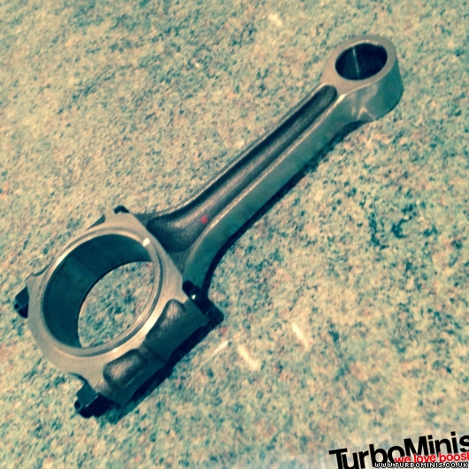

I had Oz from OAP sort out four of these little beasties for me, they're available too
632 grams each, Turned down/lightened big ends. Radiused/stress relived. Modified for ARP bolts. Oil spray for underside of piston crown. Balanced end to end after each stage.
I'll get back to you on the other stuff next week if interested?
6966 Posts
Those rods certainly don't look stress relieved to me, far too many sharp corners
carl
Hi Carl,
It must be the photo, I'll take better pics for you to scrutinise when I put them up for sale :)
Regards Wayne
