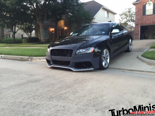

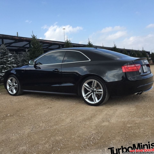

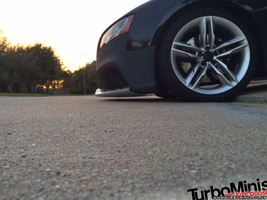

Please correct me if I am wrong, but I still think this looks fecking awesome for a 10 year old car ? (Taken at christmas.
they are still putting these wheels on the new s7's so feel still in style lol!
Looks great,

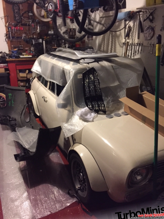

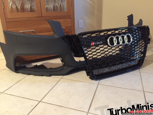

well chaps, not mini related, but thought you might like this, I decided it was time to toughen up the look of the S5...got some cracking RS5 bumpers / con vo kit from x-uk. These are RS style bumper, but fit the S5 direct, without having to widen the front and rear wings to suit.
Bumpers fit great to the body but quite a bit of standard equipment positioning mods to do
had to start with trimming back the "under bumper quad pipes...
then trial fit for clearance, since the tail pipes now exit through the rear bumper...
So glad I did this with them in primer as a posed to getting them delivered in the colour matched option.
Had to dispense with the rear steel internal bumper in the end after several attempts to re-shape..besides will save a couple of kilos!
Mini related - The poor old mini became a wee work bench during this, but rest assured, I was very gentle, I used to play hell at my mum, if she ever tried to put the washing basket on it when hanging out the washing !!

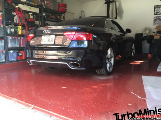

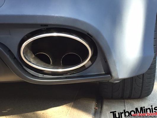

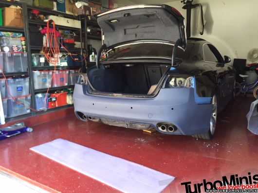

So this next pic shows rear bumper fully clipped in with ovals bolted up but back boxes clearly too low and close together, and not sprayed matt back yet either

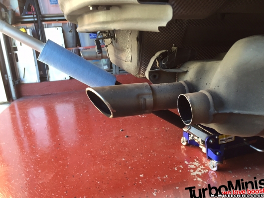

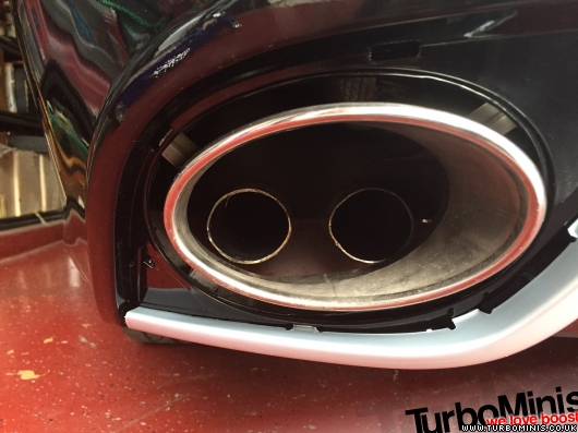

Next job was to spread the muffers which I did but putting two long bars down each of the inner tail pipes, then loosened the tie bracket nut, and bashed the stud plate out, then cut out the end of the adjuster slot to make an open slot, then put my feet on one bar and the back of my neck on the other and pushed them apart in a kind off reverse sit up crunch which actually ovalized the inner pipes a little to match the outers (positive side effect!) and then I fitted a bigger washer after re-instating the pinch bolt. Additionally, I had to cut off the hanger pins and relocate replacements lower down on the tail pipe bracket, I actually used mini manifold studs and MG metro rocker cover bolts who's smooth shank OD fitted a treat in the hanger ID.
Net effect, lifted and centered tail pipes....now happy with the look of the rear, removed and refitted rear bumper after spraying tail pipes with heat proof matt black, rear of car instantly lowered 2 inch looks wise...and diffuser silver alloy trim painted to match the wheels and mirror covers, now onto the front...

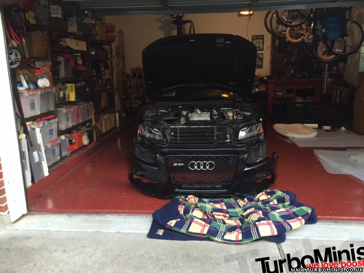

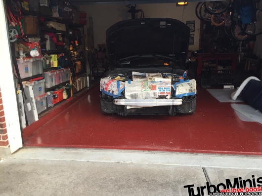

Old front bumper pulled off, a few broken bits just fell off, clearly ready to be replaced, ready for the new RS style custom "Quattro" grill!!
Pretty much the same on and off carry on with the rear bumper, but not quite as bad, as the final fit is bolted in both the in and up directions as aposed to bolt in and then clip, so a little more control.
Had to do a few clearance checks on the drive before committing to paint though....
Pretty close with the alloy trim on, no fast exits or entries needed here !

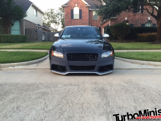

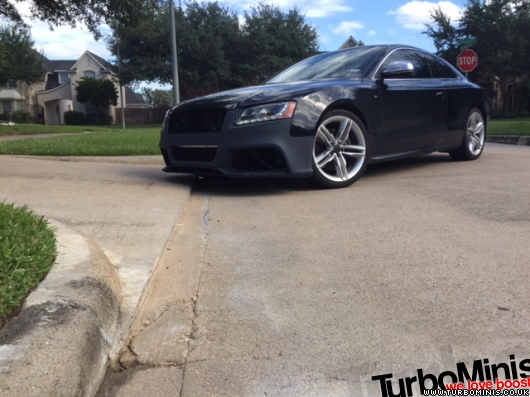

Next step was to black out the alloy bumper, since de-license plate barring would expose the alloy under bumper
Now ready for the final fit, don't get me wrong, I was wearing kit gloves the whole time and the procedure involved lots of big soft blankets ! (but no cod liver oil !!)
For some reason though, after spraying and baking the bumpers did seem to be a tighter fit !!? not sure if it was just because I was deliberately trying to be more gentle,
Rest assured, there was plenty of standing back and going "f**k, that looks nice !"
Need to get the big camera out and take some proper shots , this pic does not do it justice, the front intakes look really pronounced now they are in gloss black...
