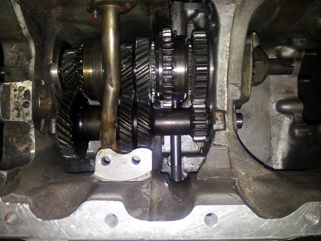

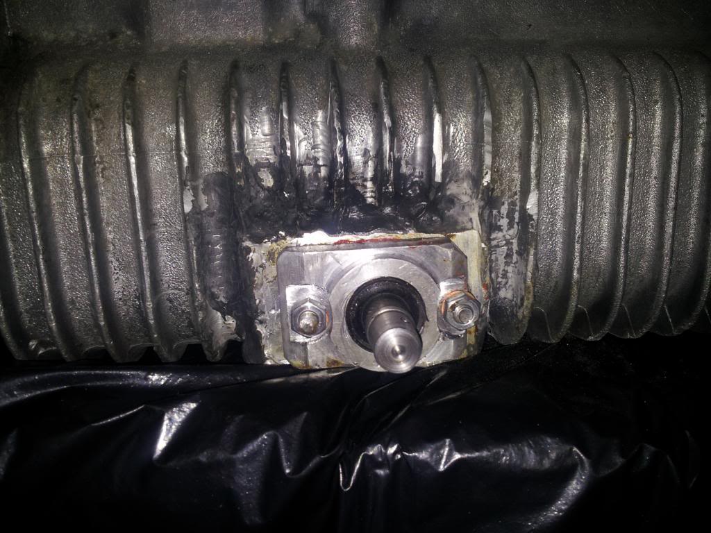

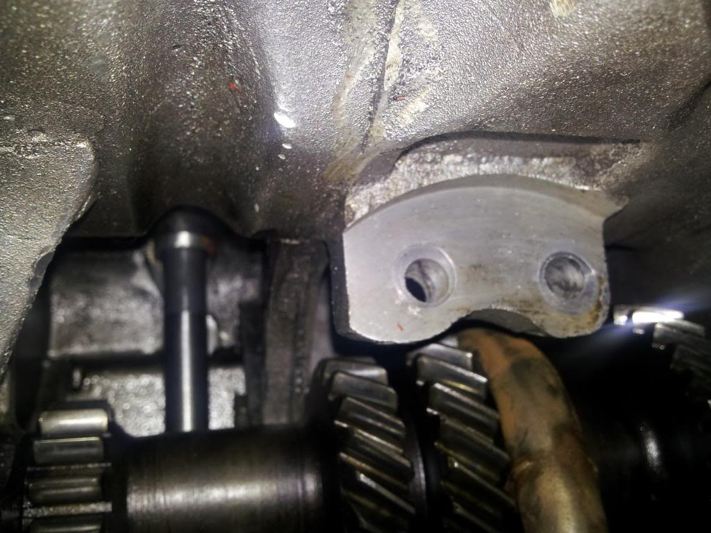

We have a rear engined Nota Fang and solved the gearbox by using a rod change box. removed reverse gar and lengthened the selector so it comes out the front of the case. Solid mounting ours made sense as it's a hillclimb toy but for rd use you could use a uni joint to soak up the vibrations / misalignment. Looking at a rod change { the bit in the tunnel } iirc you can have a forward and a reward gear shaft. shift pattern in both boxes stays the same.

So that does work. I had that in mind but didn't see it passing trough. Also drawn a rod going underneath the box and then up by 3 gears so motion stays the same. Yours looks better.

Although I'm using twin Suzuki motors the principle is the same as mini rod change boxes. I'm using a Daihatsu cable change to the rear box to make it easier.
