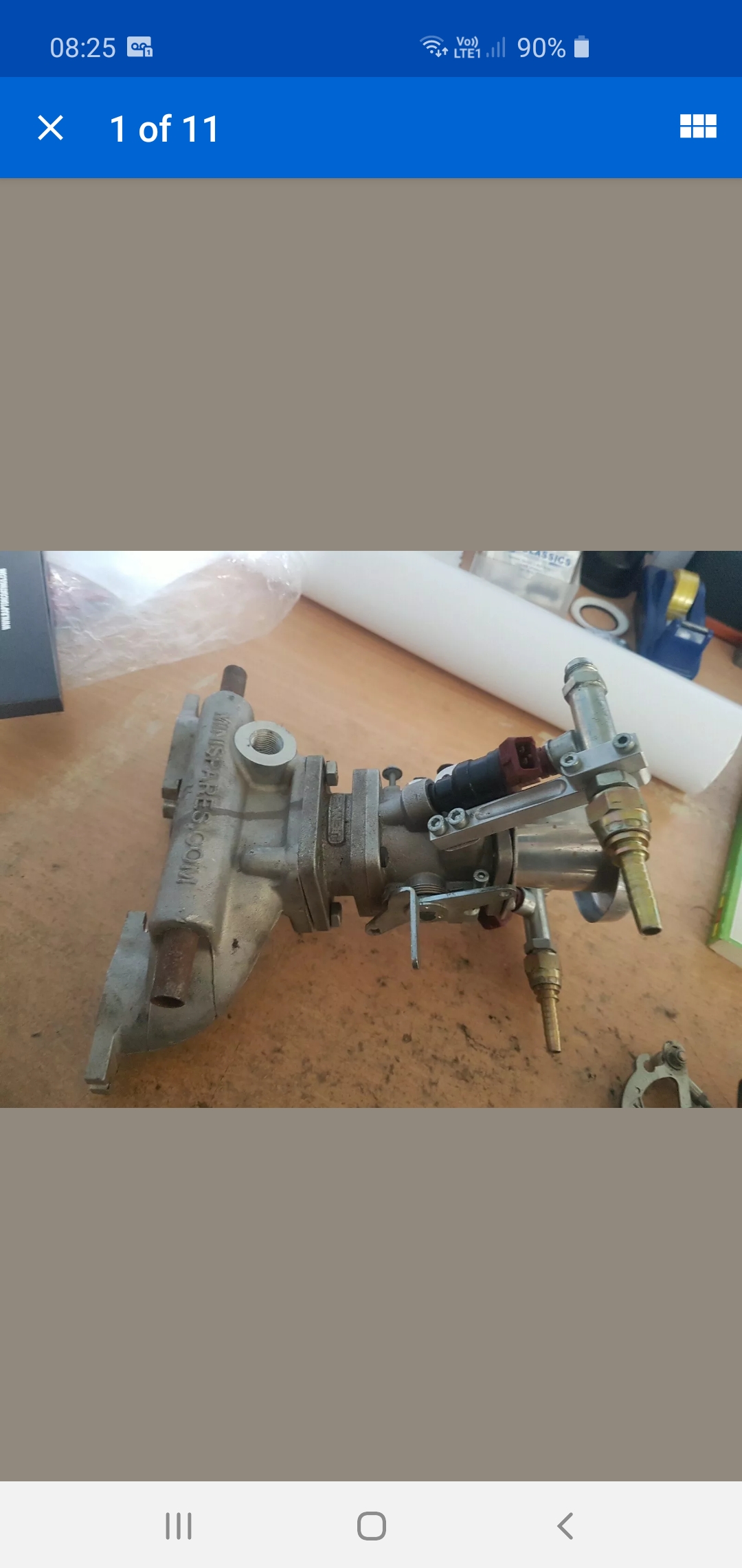

Hi thanks for the advice I've bought a jenvey throttle body with 2 injectors in it pretty much the same set up as a sc one so I've got something to play about with & see how I get on

with that Jenvey manifold your gonna be making an "electronic carb" setup, so you'll have some AFR imbalance between inners and outers, so I would suggest mapping it slightly on the rich side,

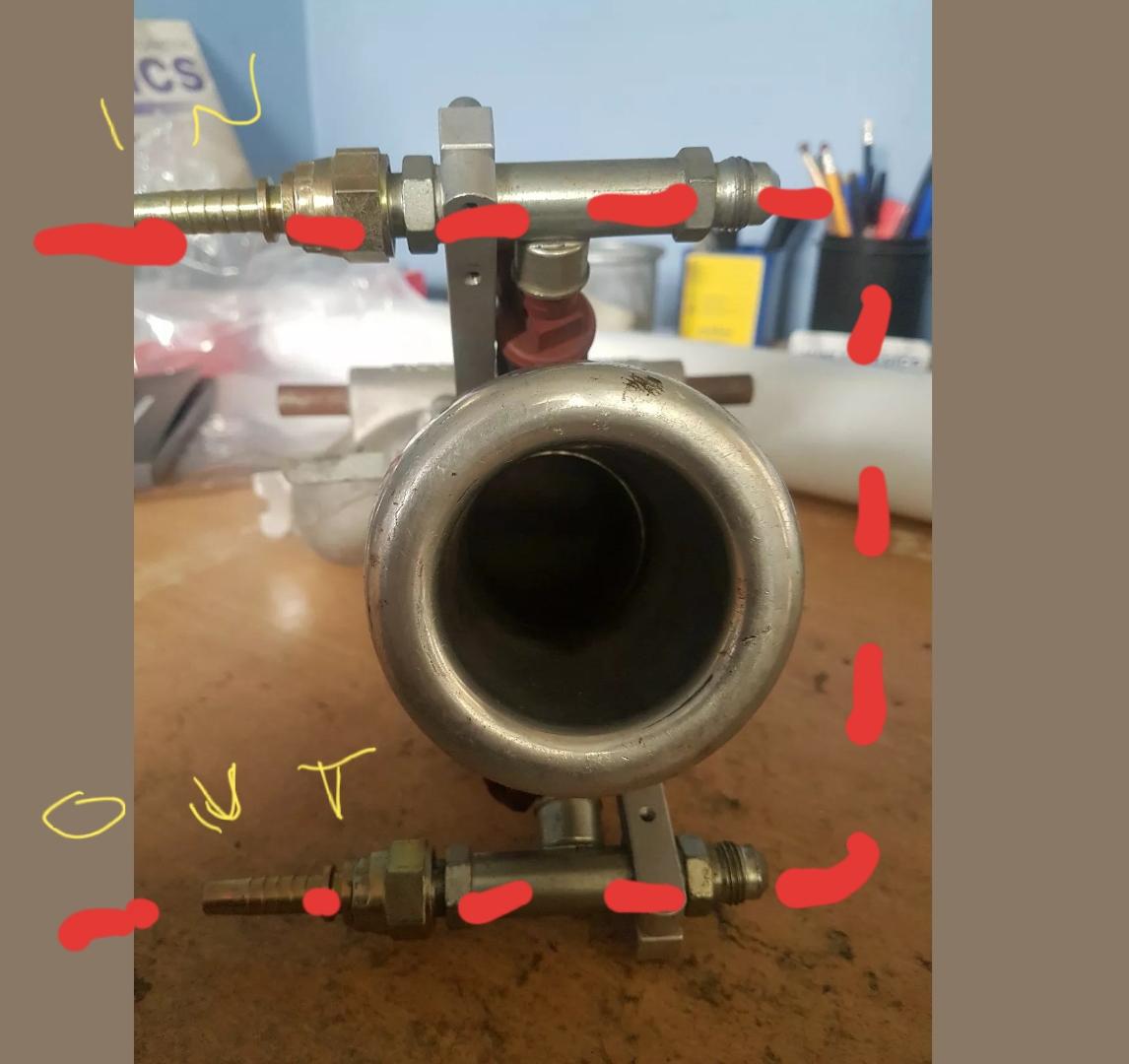

Thanks for the links it's all coming together in my head on what I need. It looks like a std metro turbo fuel pump will be powerful enough is this been tried? Also the jenvey has an injector on the top & one on the bottom could I split the fuel feed from the reg with a brass y piece or my other though was fuel in the top across the rail then down to the bottom inj & out the bottom rail directly under the feed so its basically running through like a c/u shape depending on the way you look at it? Appreciating all the help & inputs
I would run it like you have shown in the photo.
Although I would be tempted to replace that push on hose with a fitting for peace of mind.
My only thing to check would be clearance for that bottom injector with the turbo/bulkhead

I was thinking this would be the best way to run the fuelling but wasn't sure I could even tho i couldn't see why not & it's going to be fitted to a metro or my midas so there should be enough room I hope
