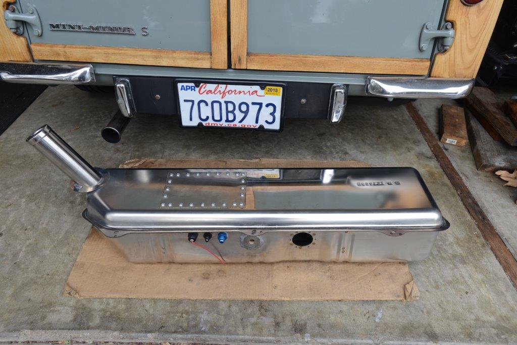

This is what Nick Upton of Woodland California did for us that we use in our wagon.

IronmanG
10 Posts
Member #: 11981
Very neat indeed. Thanks for the pictures

tmsmini
186 Posts
Member #: 7637
Fremont California
Ours is in a little box that acts as a baffle and seems to be working well enough.
The Hydramat looks great, but doubles the cost of a tank.
What some of the US aftermarket efi tank manufacturers have done is make a recessed area in the top of the tank where the electrical and fuel connections can be made. The whole pump and swirl pot in one just drops in. I am not sure this is possible with an LWB tank.
