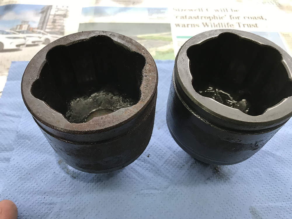

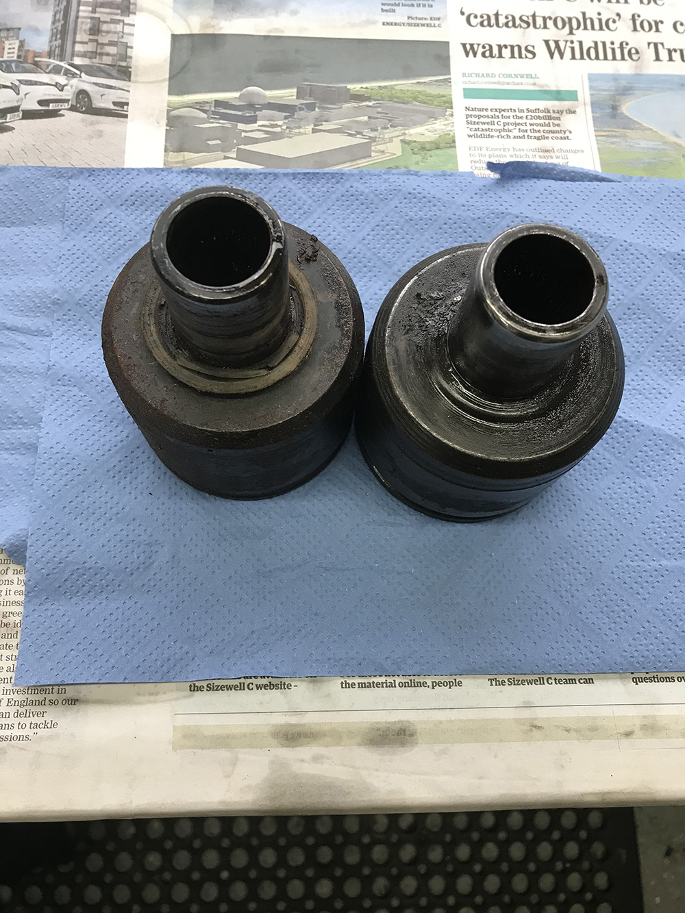

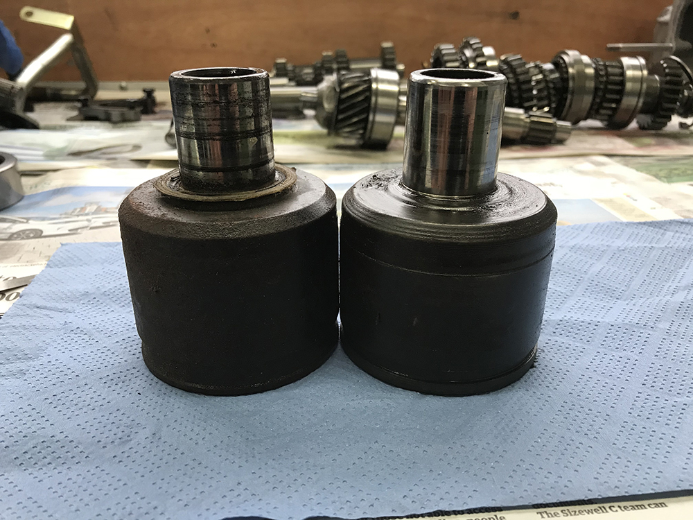

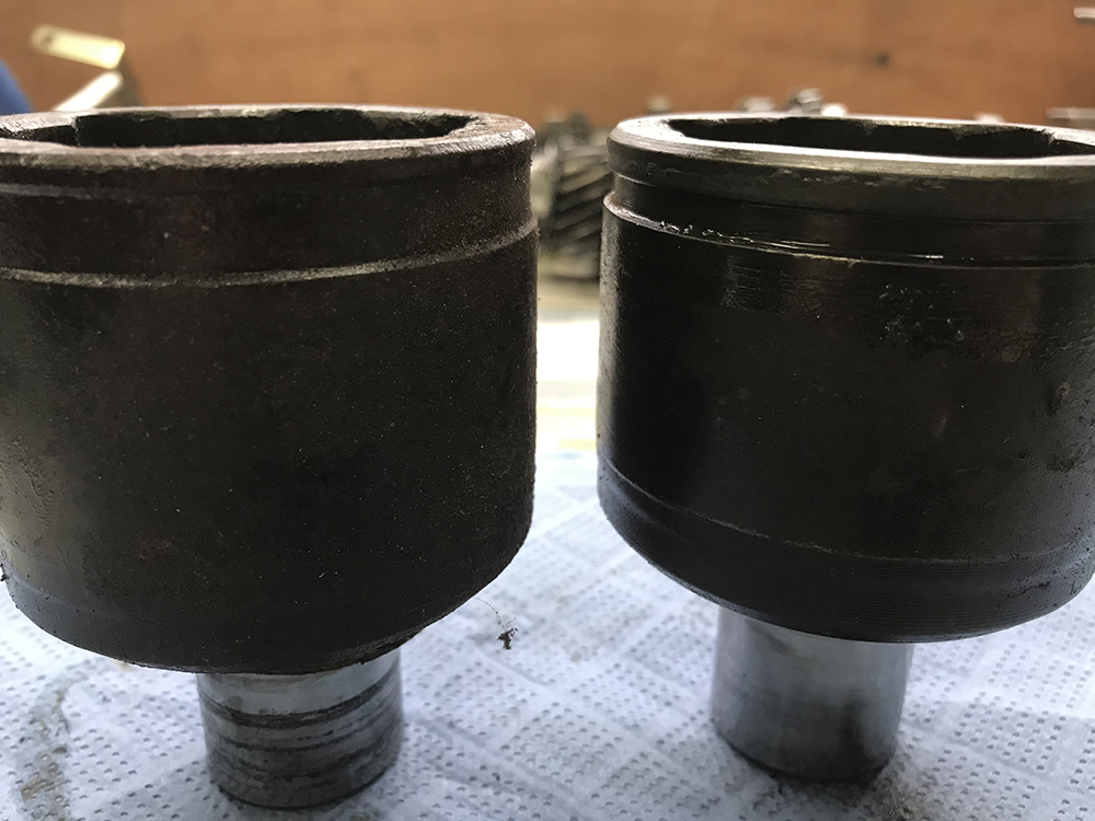

I dug out what I had in the garage this afternoon but the Metro joints I've got have no inners to provide complete comparison.
I've checked over the outers and the only difference (as mentioned above) is the type and retention groove for the CV boot.
Internal measurements appear to be the same but I am comparing a 40k mile metro pot to an unknown millage mini one.
Images below; Mini pot is on the left and Metro on the right.
Sorry I couldn't be more help.
Shane

4642 Posts
Thanks for that Shane, top effort.
Phil.

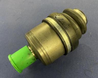

Phil,
There were some Metro 'heavy duty' ones which are what Rod is describing I think, these aren't that common. The Metro did also use one the same as the Mini.
The heavy duty Metro ones are like this:
If the ones you have 'found' are like these then I would gladly buy them from you - I use them on my rally car.
Edited by graemec on 9th Feb, 2021.
These are the ones I have on the mk1, they are sealed (boot is on a tube) and made by hardy spicer.

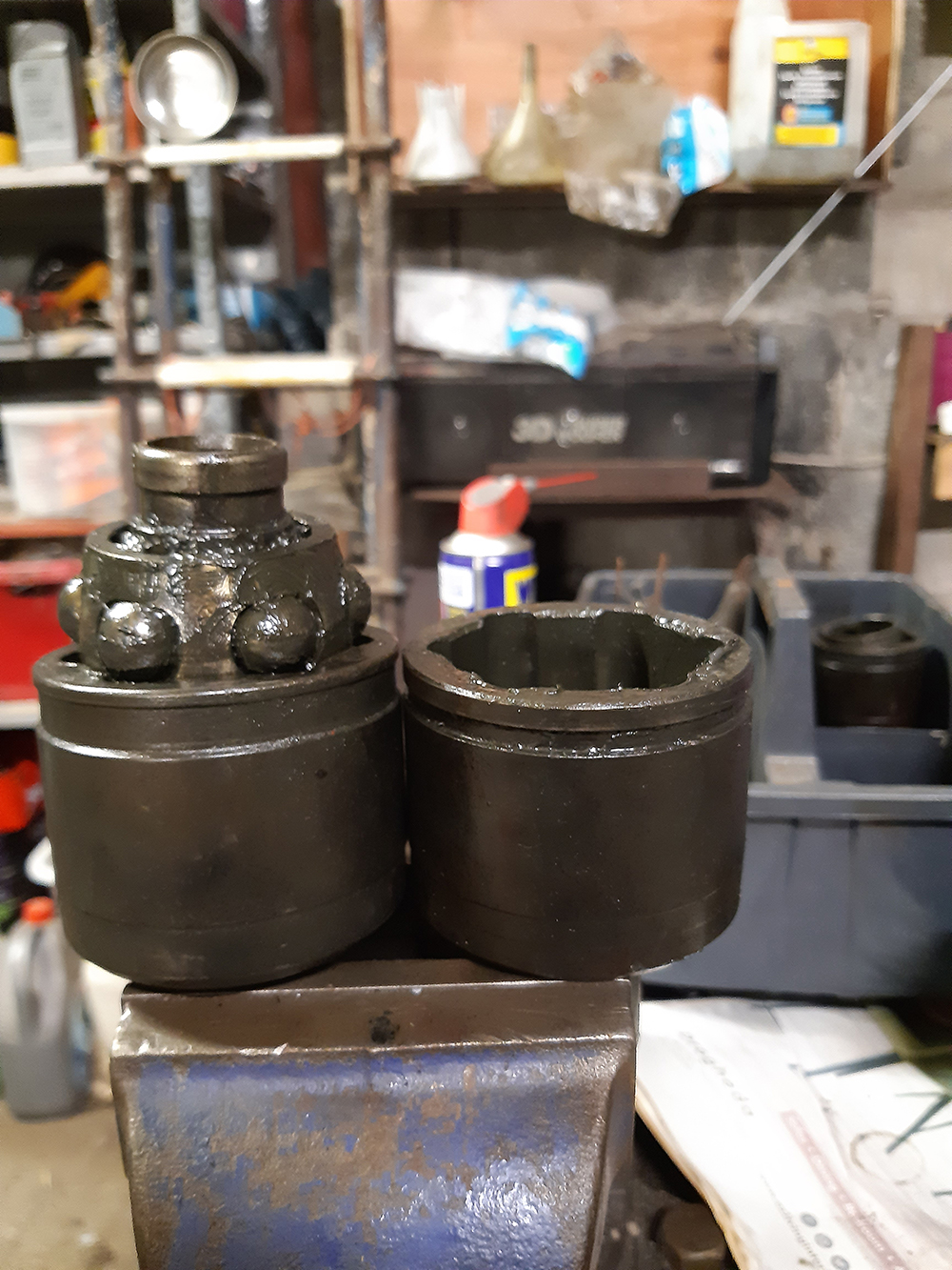

Member #: 9182
I found two of the odd CV in the workshop today.As per Shanes photo the difference on the outside is the width of the boot retainer ring.The difference in the outer part is the thickness of the wall between the ball bearings. The difference in the inner is the external diameter of the cage. Big cage will only fit thin wall but small cage will fit both.
viz139
108 Posts
Member #: 9182
Photo of large cage sitting on thickwall outer. The thicker wall would increase the contact area with the ball bearing
