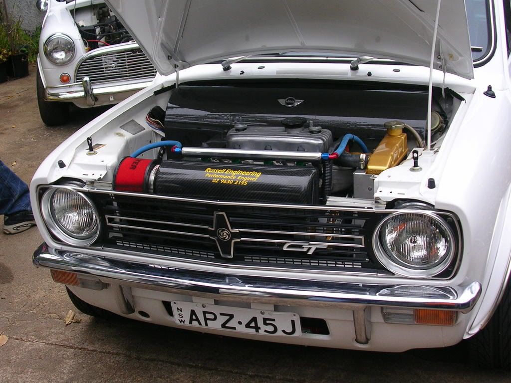

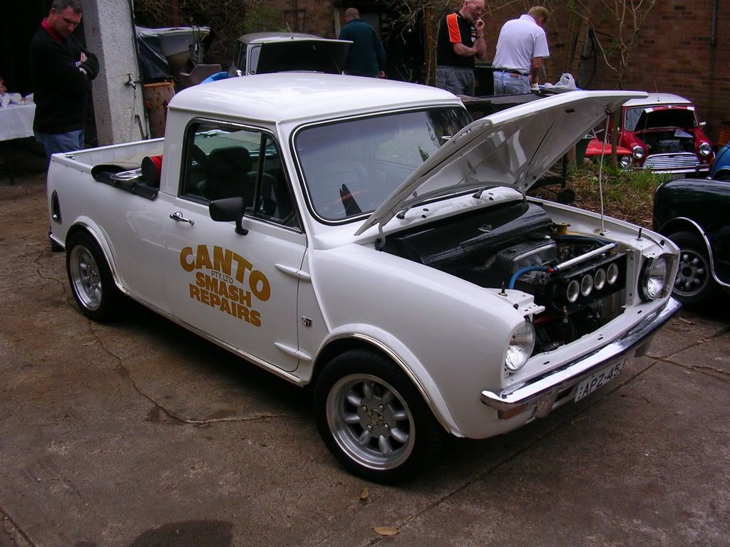

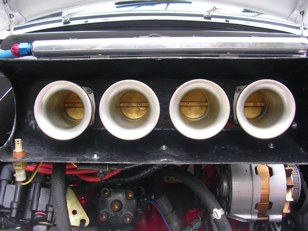

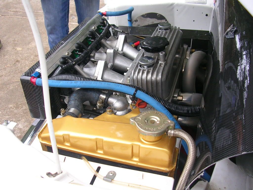

well i have got a secong complete A series engine to play with now so i will start to strip it and work from here.
here is a pic of a guys i know with an injected 8 port but no turbo

lol @ wolfie, very sexy! and in a pickup
Doodmeister, they guy you are on about is Graham Harvey. He is a member of this forum and has written a bit about is car here:
http://www.turbominis.co.uk/forums/index.php?p=vt&tid=4952
