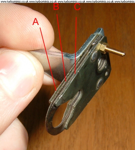

ok then, im feeling a little slow when it comes to this, so:
(ignore that long bolt)
When i refit the jet holder (b) do i need parts A and C? presumably ill need A to keep the correct height
and where does this washer go? is it in place of C if i get rid of it?

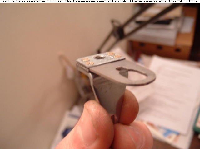

Ive put the middle piece on the hob before and that is bi-metallic too, i cut/filed one out of stainless to the same shape.
Pic courtesy of mw
And then used two 1mm thick washers under the screw to make up for the other 2 bi-met pieces that are removed. Also used rivets to line up then welded made up jet holder to bracket.

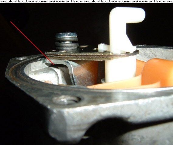

next question:
ok then, so if i do the holder like t3tone has, and then stick 2x 1mm washers under it in the area arrowed.
however it appears this area needs movement to allow for an adjustment screw. will fitting the washers under here stop the pivot required?
I thought the idea of using 2 packing washers was so you could use Dan's cut plate between them, and do without the two either side of it, as shown in Nic's picture above?
As it is arranged above is the same dimensionally as the standard setup. Losing the two "outer" plates would mean the jet holder would be higher in the carb, hence the washers needed to pack it back to the standard position.
i agree with you there tom, thats what i was originally thinking

One thing I don't get is:
Dave mentions that you need to fit two washers under the jet, to tak out any slop. As you remove one small piece of steel on each side of the new peice of steel jet holder. Wouldn't it be better to fit one washer UNDER the entire holder, and one under the spring?
If not, the jet is moved 0,8mm one way. I guess this can easily be adjusted afterwards, but wouldn't it be easier to fit one on each side like this:

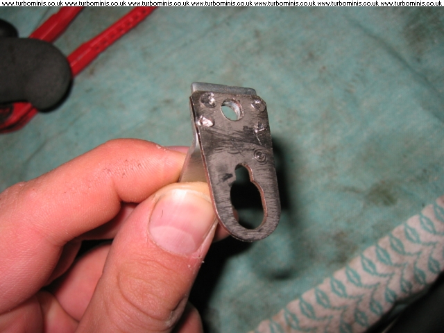

this is what i ended up coming up with:
i measured the thickness of the orginal and compared it to the new jet holder (which was slightly thicker than the old middle bit)
i then new that for it to be the same total height i needed to have something 0.7mm on either side, so a hunt around the garage and i found some metal and using hammers, chisels, and a pick axe i cut it to shape.
Then for the rivets, i put in the brass bolts i had, trimmed them down a lttle, but so they were still above the surface and gave them a good hitting with a hammer, to flatten then, and roberts your mothers brother-1x unimetallic jet holder

Looks fine Nic.
I too used both washers between spring and fabricated holder. The washers are need to make up for the 2 bi met plates that are removed so the spring regains the same clamping pressure.
