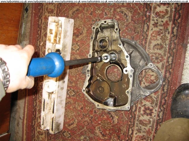

Well - The bearings weren't coming out of my gearbox so easilly today; So - I made a tool to do the job. Last one I made disappeared and I've been talking about making another for a long time....
So - firstly - you need a tool like this from machine mart:
It's called a slide hammer. You can make one VERY easilly however - a piece of 2ft long 1/2"diameter bar with a cap / sleeve welded onto one end. You then need a suitable 'lump' of metal to act as a mass. Use your imagination / initiative - but it obviously needs to 'slide' along the bar and not past the cap/sleeve you've welded on there already!
On the other end of the bar, weld a M12 bolt - thread outwards of course. Congrats - your Very own slide hammer!
Now - this is the adaptor you need to make:
It's a 1st motion (bottom drop gear) nut welded to a 2" length of 1" diameter thin-wall tube. At the other end, weld in a M12 nut (will fall nicely inside the tube). All done!
To use:
Well - a picture paints a thousand words!
Screw the adaptor onto the 1st motion shaft. Screw the slide hammer into the adaptor.
Now - to use:
Hold the outer end of the slide hammer. Hold the 'sliding element' with your other hand, and slide it towards the transmission, then whack it backwards. Stand in amazement as the whole 1st motion bearing and shaft comes out with ease.
If it doesn't come out, then remove the slide hammer and hit yourself over the head with it before removing the circlip holding the bearing into the casing.

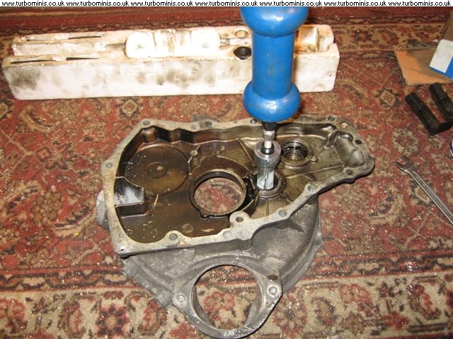

Now - the mainshaft dounble roller also benefits from this tool because the thread is the same in the 1st motion and mainshaft:
You need caution here though, as you can only draw the bearing out around 4/5mm before the 1st gear contacts the centre web - so don't use a lot of force...
What you can do though, is push the whole mainshaft assy back into the gearbox whilst putting a suitable wedge / spacer between the bearing circlip and web - hence preventing the bearing sliding back in.
Now you'll have a gap of around 10mm between lip on the end of the mainshaft and inner race of the bearing. Drop something in there like a small piece of aluminium to take up the clearance.
Now pull the mainshaft back and operate the hammer again.
By now you'll have enough of the mainshaft bearing ciclip exposed to get some pry bars (or screwdrivers for non-engineers) on to fully withdraw the bearing.
Jobs a goodun!
