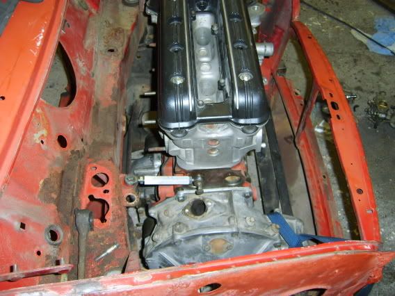

hi mini sprocket,
i too am doing the 16v build. Mine is mainly being done for college and on a std 1275 bottom end. I only have a very short time to finish it and was wondering what cam pulleys you are using for the cam drives. Time is getting very tight ans i need to at least get the engine looking together even if it does not run!!!
Cheers, Anthony

Mine needs a tiny weeny bump on the bonnet for the front of the head, your timing gears look to be a tad bigger than mine, maybe yours will touch a bit more even?
lookin good tho & excellent to see so many more of these getting off the ground (so to speak) *smiley*

Well i dunno about the turbo installs for fitting under bonnets but i have got about maybe 1/2 inch of clearance on the top of the cam cover to the bonnet. Mine has been tilted slighty back to allow for the carbs i am using to begin with, and the fact i am not putting a turbo in to start helps.
This is how mine is currently sitting waiting for me to get some spare time from work and college!!!

its only everything bolted together for me to do my exhausts and inlets to fit inside the bonnet!!! Have got to get the guts sorted, oil feeds and drains, coolant system and cam drives!!! Not much really!!! So long as i can get it too look like an engine by may 24th for my presentation i will be happy!!!
Looks great, one thing is there only 4 bolts holding on the head? can only see 4 hold in block.?

Looking good Ant! I'll bolt mine together again and post a pic. I think Sproket uses puma and 1.25 zetec bits though could be wrong.
Yup, Fiesta 1.25 Zetec sprockets.
9407 Posts
looking good guys! I spent the day on my block today. It's going to get bored on Monday, thn mid next week I'll do a dry build and then get the block skimmed

wheres this head idea come from as id not heard of it before and now there seems to be quite a few of people doing it.

Well i found it first from MadMatt, then 1071s who pointed me onto a bloke who done an 8v version on a 998 or 850?? in 1989? Then i heard of Simon at Morspeed doing it and then Jimster and then Mini sprocket. Although everyone has slightly different ideas about things which is good!!!

I think the 8v claim is the canadian, the first 16v was a frenchman named Bruno Roulle - Matt's was the next i saw before the Morspeed unit.
