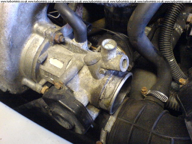

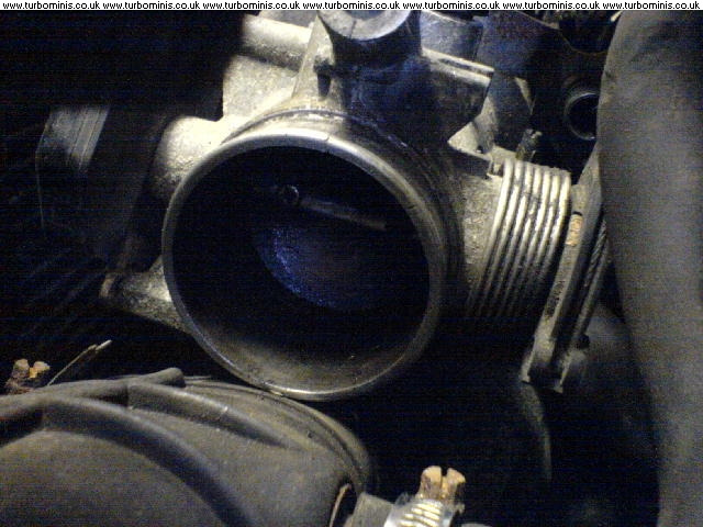

Dave, I think I will not be using that rover turbo one which I have, you want that one?
205 1.9 8v Throttle body. The 1.6 8v one is the same.
51mm butterfly size. It is a three bolt mounting, on a PCD by the looks of it.
This is the RS Turbo TB
50mm at the butterfly now I've measured it.
Is that the Bosch TPS to avoid?
Edited by Paul S on 25th May, 2006.
