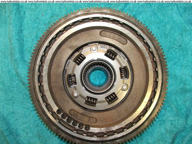

And the MPi reluctor is deffo 36 -4, I have seen one, if it was not good enough that Rover say it is. The picture above is of the SPi flywheel, by the way.
To quote from the Rover workshop manual
"The flywheel incorporates a reluctor ring which
consists of 32 poles spaced at 10° intervals, with 4
missing poles at 30°,60°, 210° and 250°. The
missing poles inform the ECM when to operate the
groups of injectors.
The camshaft position sensor has two functions. The
first is to enable the ECM to run a sequential fuelling
mode. The second is to measure the actual cam
period, this measurement is achieved using teeth on
the camshaft to indicate when the valve opens and
closes."
If you look at the end of the crank sensor, although it is 14mm O/D, it has the actual pickup encased in the centre, this is approx 5mm diameter.
I personally think it could work, assuming there is enough width on the pulley.
