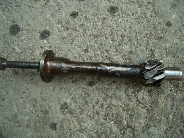

What was wrong when it only ran for a few seconds?

Haha did you not see the photos??
It fell inside the engine!

feebs i think he means what was the outcome of this http://www.turbominis.co.uk/forums/index.php?p=vt&tid=9825

Oh sorry i forgot about that post!!
Well i took the carb off and took it all apart and everything was fine, and as new, no gunk or anything. Put the carb back on, and did daves T piece trick (after checking everything in his guide like renewing the balance pipe etc) and it started fine!
Carb rebuild will be on the list for after avonpark :) Planning on driving it to lake district this weekend though if i can get it tuned and MOT'd in time

You plonker I knew about the dizy drive.
Thanks for the update and keep the 17mm spaners*wink* out of your engine.
