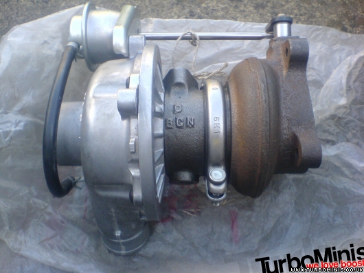

1- inlet
2- the little ID thing
it says, spec- as12 0608
rhf4- 22 306d
parts- 135756180
3- its says ihi turbo (on the inlet side)
4- exhaust side

right, here is the turbo
and this is the spec
From my calcs, for a small bore running 15psi it looks to be ok from a compressor side. the map to look at is the pink one.
thanks alot for doing this wil
but to be honest if anything it has confused me quite a bit,
i dont really know much about turbos themselfs or the conversion really
will it be good enough for the job, how much boost will that max at and any idea of price of them???
Jack Jones
No idea of cost, you'll need to reserch that yourself.
As for max boost, it's all in the table, max pressure ratio od 2.7 which is around 25psi. It looks like the turbo will flow enough for 180 bhp, but as that's right at the edge of the map and it wont make the boost needed at this point for a 998.
Depending on how efficient the comp is, 15 psi should net between 140 and 150bhp.
