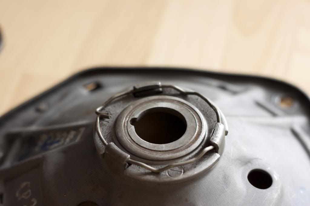

After further inspection i have taken the pressure plate off and it is rather worn all ready! It's only done a 1000 miles or so, it looks like the release bearing has been riding on it.
So is this an adjustment issue, and can i get a replacement thrust plate or is it a new pressure plate i'm going to have to get. It's a grey diaphragm.
That is caused by not adjusting the return stop correctly which inturn will mean the throwout stop adjustment is also wrong.
You can get just a thrust plate, you dont need to replace the whole diaphragm
We had this often with the upside down skip. We ran a bent clutch arm. I reckon it was bent to far, so the release bearing was always engaged slightly. We ended up with two very worn centres like that and several sets of munched thrusts.

I see, well there was no stalling when i dipped the clutch so i don't think its munched the thrusts yet. I have bought an MED clutch arm and new clevis pins ect. Whats does having a longer pin achieve?
It makes it so that it doesn't have about 8-10mm of travel at the slave cylinder before engaging the pin...

Were older thrust plates hardened? i have heard of a number of issues around new clutches similar to this . some builders are reusing the old plates
I have been running with my thrust bearing permanently pushing on the thrust plate for a long time, but never seen that issue before.
I'd take a look at the bearing first - and make sure it is spinning freely. To wear like that,,, something is definately amiss.
What earwax says might be worth a look - I have never bought a new thrust plate, so mine would have been old-school parts.
I take it you have the correct release bearing fitted? Not a verto or an odd ball bearing?

Yeah got the correct bearing fitted and it's spinning freely, doesn't feel like its full of grit or anything.
Thats an interesting one on the thrust plate. I've had a look and can't seem to find anywhere that sells them separately.
