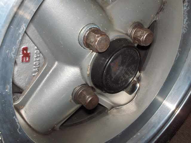

I still don't get why he disc has moved 3mm toward the hub,
obviously you have changed something but i can't see what.
6749 Posts
iv changed how far the hub sticks out from the bearing .
ahhh,
can you do that? have you made up a thicker split washer for the other side or some thing?
6749 Posts
if the nut bottoms out then ill have to make a spacer ,but i think it may be ok ,and just pull the cv through more ,,,time will tell when i assemble it . *happy*
So, you've taken some material from where i have marked in red?
will the splines not bottom out where the area marked in green has been removed or have you modded that also?
6749 Posts
NICE PICCY!!
yes m13 iv modded the splined area 3mm in today and got some packing for the wheel studs..oh and took all the edges off the wheels and any stress risers off everywhere ,
tomorrow should be test build to see if iv machined it all ok !!
Can you guess where i robbed it from? LOL
6749 Posts
dang nab it !!!!!
the thicker mounting flange on the disc is a mm thicker than the old discs, so it just grazes the oil seal on the hub carrier !!!oh pooh ,just have to take another mm off the disc mouting face .no biggy .
or take a mm out of the inside of the bell?
6749 Posts
yes thats another option ,easier to get at the face though ,just so long as the 4pot doesnt hit the wheel *surprised* *surprised* *tired* *wink*
6749 Posts
hurrah!!!
all on and functioning now have a 20mm narrower track at the front than it was ,10mm in each side ,and a total of 13mm inset ,with the mini flange ,same total inset as a 19mm inset wheel using a metro flange .
feels v stable and almost power steeringy,will have to take it to a nice bumpy rd and do the 70mph overtaknig test with it but it seems a lot better ,may drop the castor back to 4.5 to lighten the steering now . *smiley*
6749 Posts
close enough ?!

What's the clearance on that? Fag paper? *wink*

nic good point , i have a total of
3mm off bearing face of drive flange
2mm off wheel face of drive flange ,
5mm off wheel itself
4mm off disc face that mounts to flange .
2mm off cone split washer so it dont hit the cv spline
3mm off spline inside face so cv dont bottom out
4mm hardened steel washer from astra to pack out hub nut so it dont bottom out on threads ,
edge of washer tapered to avoid contact with the hub before reaching proper torque on nut .
5mm packing washers under wheel nuts to avoid bottoming out.
phew dont these things mount up !!

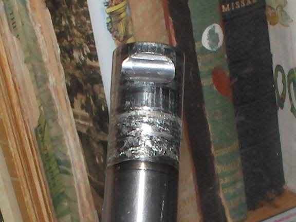

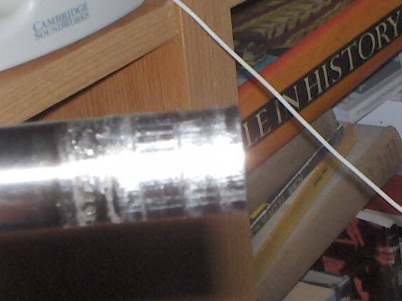

well bit of an update here ,
after various nightmares on the diff front and the same prob being there when using the higher power ,
i decided to get a 4 pin diff and see if i could get it in there withuot taking the engine out ..
well the good news is yes you can and you can also get the pinion out with the engine in ,
so you can change diff ratio which im doing .
the bad news is ,
i was thinking i could sell my comp diff pin new everything single pin diff that was coming out ....

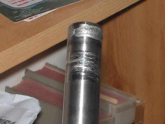

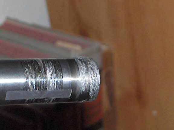

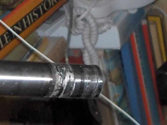

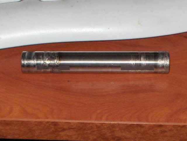

so i looked at the diff after getting it out and thought hmmm ,should that diff pin be rotating when i spin the gears
I DONT THINK SO !!!!!!!
yep .
the pin was welded to the planet gear ,and had eaten the roll pin !!
it was freely spinning ,and how far i was from a self dissasembling diff case i shudder to think ....P.H.E.W.!! here are some pictures
this pin a genuine competition pin ,,with all new gears and bushes etc,run on valvolene vr1 20/50 ,and has done about 3 k miles ..enjoy
*happy* happy to have got away with this so far , i feel this was the steering prob .
Edited by robert on 6th Jun, 2007.

That's fooked!
I think you've been real lucky with that!

Lucky escape for sure ..... now I don't feel bad at all for winding you up over not having a 4-pin in .... maybe you owe me a pint thinking about it ... lol
TurboDave16V
How about a 'file test' to see how hard this pin really is at the surface?
That looks like it was significantly softer than the pinions?
