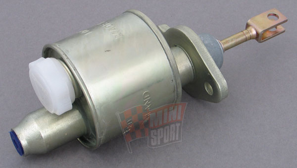

yeah they look like you have spacers in front. by the way will my master cylinder do the job? its the one like a baked beans can. (see attachment)

stefaz
1252 Posts
Member #: 1656
stoke-on-trent
yes mate - will tone your legs up too lol. tbh wish i had one for mine, but knee problems mean i need a servo

iain
8506 Posts
Member #: 16
Near Lincoln
there's 2 different sized bean can's.
one i think doesnt contain enough fluid to operate the brakes correctly, the other is a bit bigger and is fine.

mine slike the one in the attachment

15300 Posts
Either size work fine, the taller one is a cooper S type, internally exactly the same, only difference is it holds more fluid, so that if the pads are worn right the way down without the fluid being checked, there is enough capacity so that the master cylinder will not introduce air into the brake hydraulics.
If you use the shorter type with disc brakes (even more so 4 pots) just ensure you check the brake fluid periodically and top up if reqd.
sheldon
18 Posts
Member #: 1758
Malta
cheers so im safe :)
