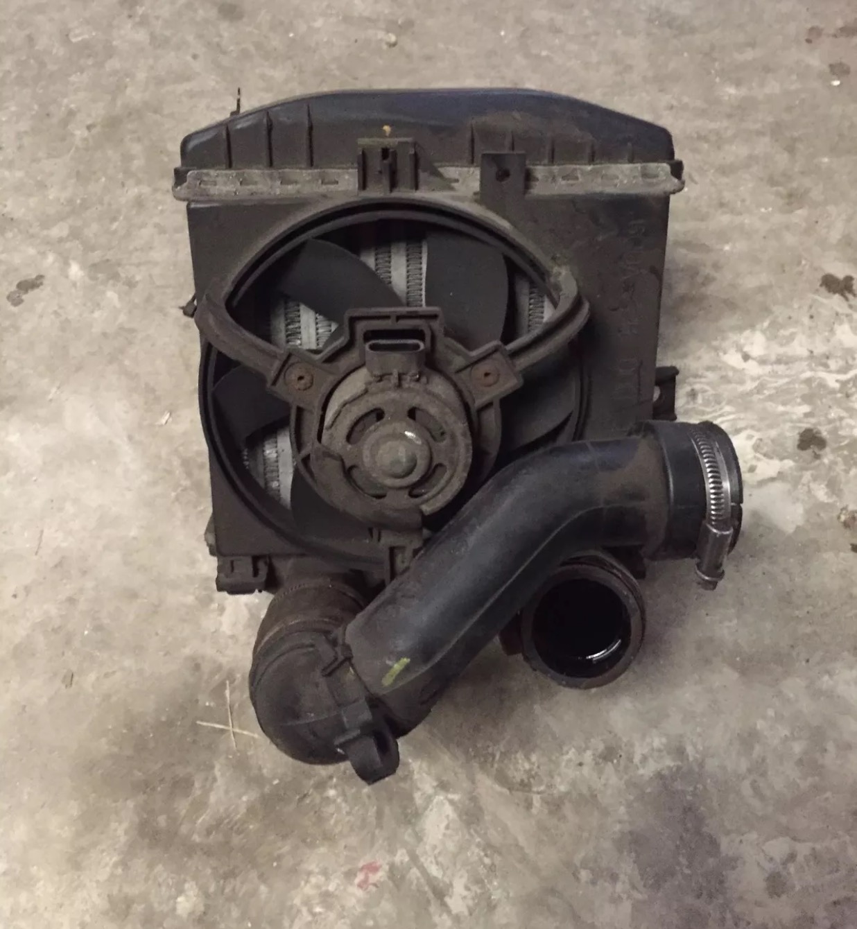

Intercooler - dunno how big it is or tech specs but 20 quid worth a looksy and I like the fan 😂 The kid in me 😂👍

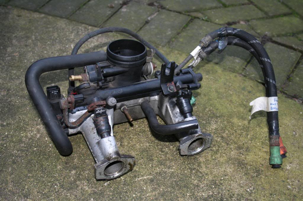

Hi all , another 24 hours of being awake cooking the books on fueling ... did any of you ever come across a thread when a guy added 2 additional mpi injectors into the standard intake - fareplay to him fucking hell of an effort - if it's OK with the mods I'll post a link it's an absolute fab read ... there's nothing to pick apart but let's have a thumbs up for him 'legend'

Paul on here put 2 x 3 injectors in one manifold..!
