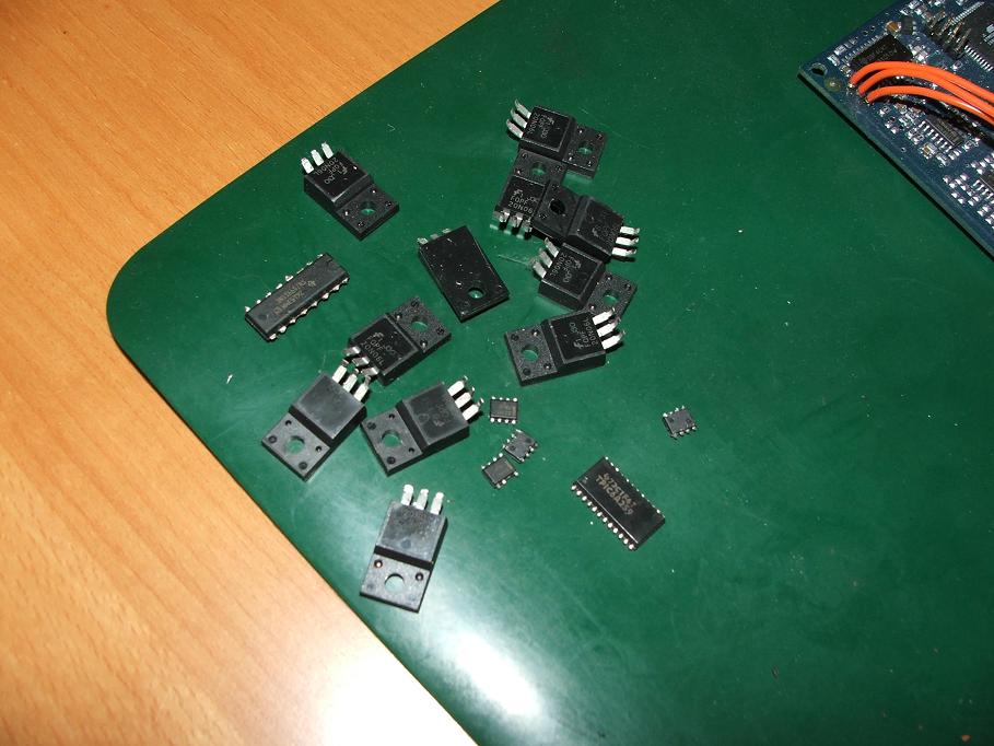

This the carnage that was my ECU problem*happy*
Those surface mount chips are a bit of a bastard*happy*
Edited by Sprocket on 17th Jan, 2009.
What have you done with your ECU & why?
The ECU kept smoking FET injector drivers within 10 - 15 seconds of starting the engine.
I havent been able to find out why, but i suspect it had something to do with the stepper driver chip, thats the big through hole chip in the middle left of the pic. The stepper motor failed just shortly after I had the engine running, which damaged the chip. From that point on I had endles problems with the injector drivers.
That doesn't quite add up in my little brain do you have a schematic?
Nor mine, but that was the sequence of events*happy*
you think theyre bad, try getting those 4 sided buggers off with the .5mm pitch
