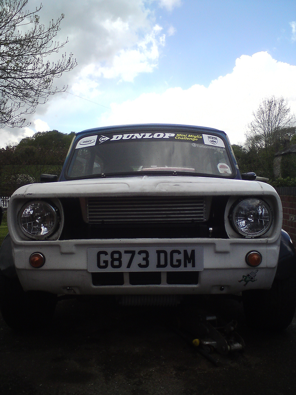

Haha yeah it does make life alot easier, though im finding it tricky fitting everything in (dont ask about the fan! :S) I dunno how you round nose guys manage front mount setups.
Just poked the intercooler in the hole, if I can drop the rad by about 20mm the badboy will fit in there nice and snug, with two thirds of the intercooler in the air flow (kind of a shame, if I got the right one it'd fit perfectly behind the grille!).
I'm thinking I might do something with the numberplate and put some holes in the front for the rad aswell.

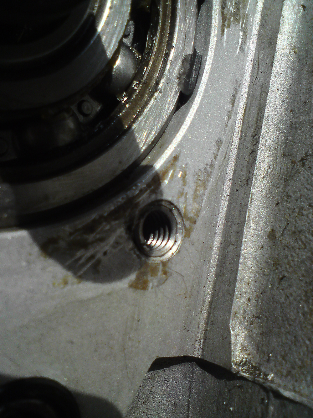

I went out on sunday morning to see what I could do next, only to be met by a puddle of oil under the sump - fork. Turns out theres a leak from the drivers side outputshaft cover, from behind the detent spring and ball cover.
When I was building the gearbox my torque wrench had an odd moment and I over tightened the bolt closest to the detent spring, stripping the thread in the ally box casing. In the end I just built it back up will alot of sealant around that thinking it should seal-wronnnng. It was leaking just from being full of oil having not even been under pressure yet.
So I thought right, i'm going to have to helicoil the thread but to make acess easier i'll take the engine out, disconnected it all sunday afternoon and just hoiked it out today with dad helping.
Upon closer inspection i'd already put a helicoil in the hole!:
I was wondering why i'd never put the bolt back in, but for some really really odd reason beyond me, the bolt hole didnt line up whatsover with the output shaft cover on.
I took the other bolts out and had a look, by the looks of things the standard bolt hole wouldnt have lined up properly anyway, but when I took it apart it all seemed ok so fook knows.
In the end I had to file about 3mm out of the cover so I could get the bolt in square. Bodge. But its done and all sealed properly.

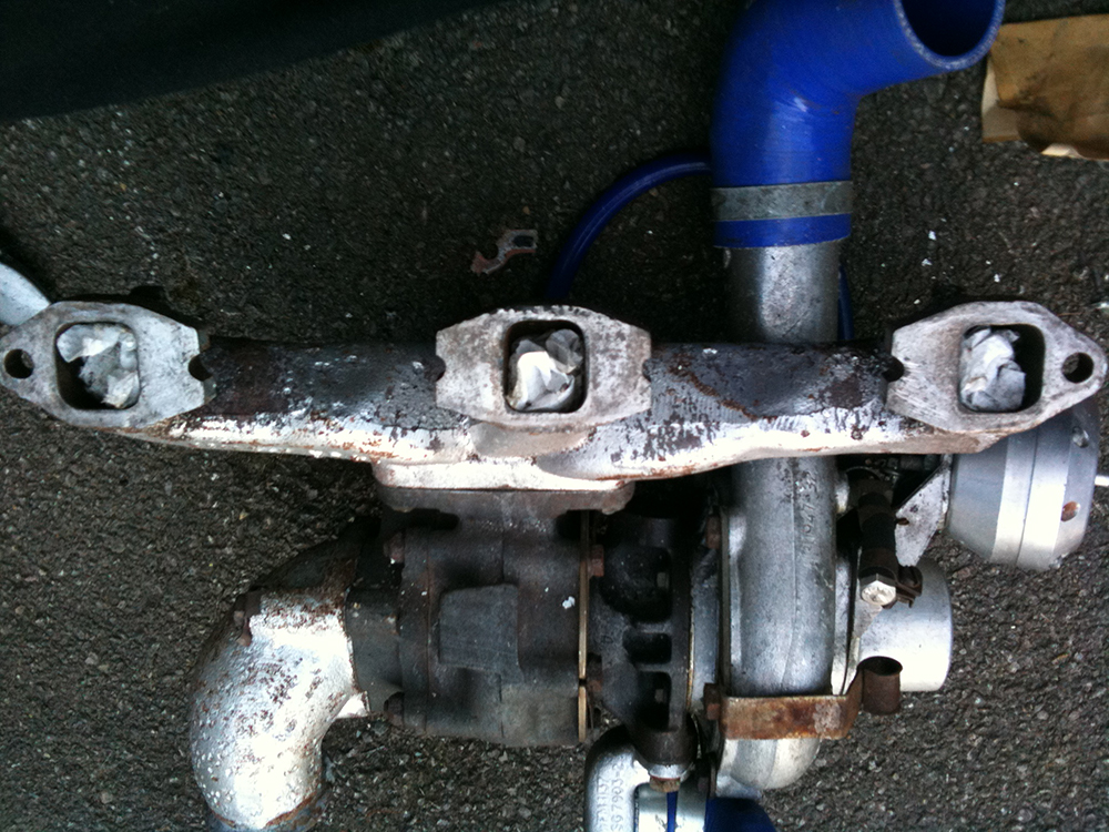

Set about refitting the turbo, remains of the old manifold gasket were fused to the head quite bad where its been sat for a while. Got it all off and cleaned it up nicely for the new gasket to go on.
Had recieved two "large bore" gaskets from minispares, slighlty less rigid to the one I had before so its a different type, no need to enlarge the port holes on this one so fingers crossed itll go on fine and not need to be replaced any time soon.

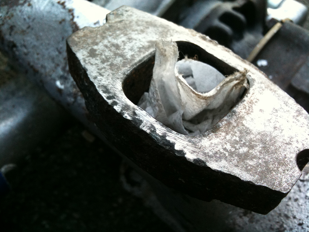

Double checked my inlet and exhaust manifold flanges, inlets ok but im not happy with the exhaust manifold. Looking at the centre exhaust port flange, the "top" edge of it is very worn/pitted and skinny in comparison to the other two. This was the one that leaked when I had the engine running for the first time.
See for yourself (excuse the shite iPhone pics) -
Not too great. The edge seems alot thinner in comparison to the others and its broken away at the edges as you can see. Would it be best to get the manifold re-faced at a machine shop or what?
Post a pic of the gasket you are using
