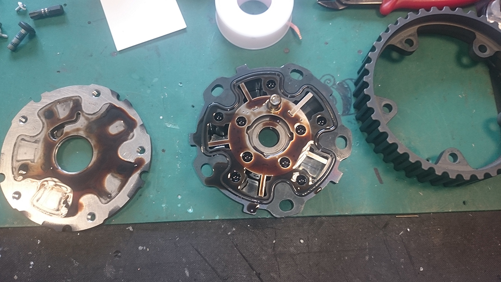

Somewhere in the garage I have a complete spare duplex set (if only I could remember where...)
Hmmmm....
OK Joe, stop teasing....
What is that ???
It looks a bit like a hydraulic phase wheel but I thought they only used the hydraulic ones on engines with chain driven cams.
(for obvious reasons).
Actually, I'll take that back, I think the Volvo derived 5 pot engines used hydraulic phase wheels with belt driven cams (I'm not 100% sure but I know my current daily is chain driven VVT so it's all in oil).

I think Its from the 5 cyl volvo lump used in the focus RS's,
esentially there are two oil inlets, one feeding to either side of some "vanes" solenoids balence the oil pressure to change the cam timing, its got 15deg retard marked on it.
I imagine one side is fed from a lower presure regulated feed for the lifters, and the other side has a solenoid. there must be a cam sensor for feedback too, I imagine it must be a closed loop PID type thing to stop the timing going awol.

LOL - mine's the later 4 cylinder ecoboost version with chain driven VVT cams but there is a lot of technical info on the owners club forum, probably more info on the MK2 (with the Volvo lump) than the Mk3.
The technical stuff is all behind a paywall but, as I'm paid up at the moment, I'll have a dig around later.

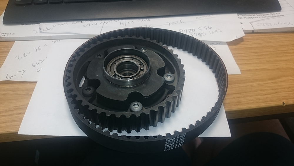

Joe,
What's the max OD of the left and middle bits (ie, would it fit into a machined out duplex sprocket), and what's the rear view like ? - The Ford ones I've seen actually only use the oil pressure in one direction and have a massive clock type spring on the back for the return.
105mm, but probably enough meet to trim a little off the outside, maybe down to 100mm.
I thought the same about putting it into a chain sprocket.
That could be do-able then.
The cast recess in the duplex sprocket I've got in front of me is 96mm but the inner face of the chain runs at 112mm so the cast recess could safely be machined out to at least 105mm. (there will be some pictures up later).
What about th rear face, is a return hair/clock spring (like the Ford ones) or is it twin oil feeds like you suggested before ?
