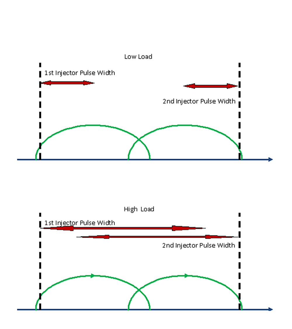

I built a four injector manifold to run on the standard mpi ecu, it wasn’t entirely successful but thanks to the graph in this thread I had reason as to why that might be. I’m now developing a manifold in which the injector angles aren’t as extreme that will hopefully provide better running. But to cut a long story short, which can be found here: http://www.theminiforum.co.uk/forums/topic...r-mpi-manifold/ . During my trials I came up with this theory about fuel injecting Siamese ports using four injectors.
(see attachment)
Obviously we’re looking at only one of the two inlet tracts here, but what this suggests is the potential duty cycle can be doubled to 50% as the two opposing injection pulses can overlap to each other’s fixed point.
The reason for posting it here is that I certainly don’t have the knowledge, tools or talent to take this any further even if it’s possible, but there are obviously very talented people on here that could tell me if it’s workable or might find the theory of some use.
Slight change to the diagram as it may not of been too clear.
Edited by Dylan8660 on 18th Mar, 2012.
Dylan,
Although this is added onto a very old thread dragged up, I'll add a "current" point of view.
As you rightly say in your TMF post, the two MPI injectors are indeed driven by a 4 channel MEMS with the outputs paired up.
However, so far as we know, this is because they needed 4 channels to alter the timing of the first/second injector pulse to compensate for the siamese "port robbing" issue and meet emissions targets for the final years of the (classic) Mini production, and wanted to do it with parts readily available.
The limit of MPI is the ECU can't easily be reprogrammed for higher outputs (note I said can't easily Colin).....
So if you look to replicate what Rover did with a modern programmable ECU, you can do it with two injectors, four or six if staged, but you simply need an ECU that can vary the injection timing between the inner and outer cylinders.
MS2 (siamese code) or MS3 (with outputs doubled up) are the preferred on this forum for a 5 port head.
If you are just looking to double the injection capacity on an MPI setup, well I don't think you can as you can't (easily) re-programme the inputs.
I'd had a lot of success with mid-pulse timing and firing two/three injectors per port all at the same time. Timed so that the AFRs are equal in the inner and outer cylinders.
Dylan8660
3 Posts

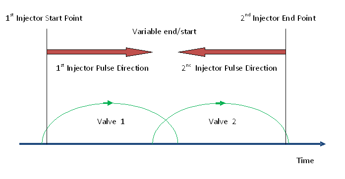

Thanks for the replies, I'm sorry for dragging up an old topic but considering its title and content I didn't feel it inappropriate. Although it could be looked at as being staged I feel the reference points for injector events could give a little more finesse of control. I’m not just thinking about simply doubling or tripling up but rather if the use of four injectors could open possibilities that two don’t offer.
Another diagram hopefully offering better clarity of thought.
OK, so how do you account for wall wetting ???

You're better off using 4 injectors in a staged setup with the current dual pulse or single pulse modes of the siamese code rather than what you propose.
This way you can size the primary injectors for optimal low load behaviour with the secondary injectors for maximum power instead of having to use 4 identical injectors which will compromise low load behaviour.
And as Paul mentions, you'll have to control the individual pulse widths and/or timing as a function of load and RPM to take into account wall wetting.
Jean
Dylan,
What you show in that plot is what the MS2-Extra (siamese code) was designed by Jean to do, with the ability to vary the timing points over the whole RPM/load range by setting start/mid/end pulse values at any given load/RPM value.
Whether you do it with two injectors, double them up but still acting as two, or stage them from four or six, isn't really the issue.
Staging is best IMO but, to achieve the spread you desire in the plots you show is quite straightforward with the siamese code.
What I'm not quite sure of from your first post is whether you are attempting to do this with the Rover MPI MEMS CPU which you first mentioned.
MEMS is "fixed" code (unless you re-programme at machine code level) so can't be altered like an MS2/3 which is just done from a laptop.
Hope that makes sense.
