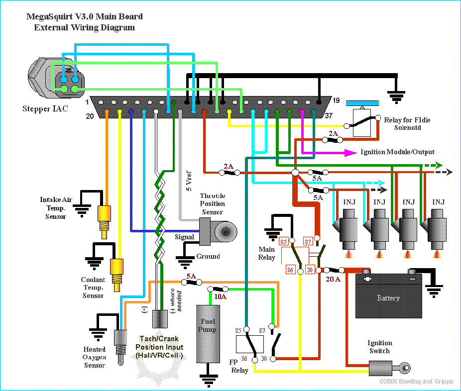

OK,
So what ignitor chips are in your MS - the standard VB921 chips are internally limited to 7amps so should not melt a 20Amp fuse holder
The ISL9V5036P3 (which i'm going to use and some of the MS suppliers are now supplying instead anyway) are not current limited so need the fuse, and if the dwell is set wrong they will pull too much current and cook the fuse and/or coilpack.
Rod.
On 23rd Feb, 2008 Sprocket said:
wind it up to 6 and 3 for and see if it makes a difference.
I ran 3.1 on my Sagem coil pack and had nice fat blue spark.
Just something to consider

921 datasheet if its any use to anyone.
OK,
If they're original VB921 chips, are they both inside the MS box and, if so, do the connections to the coilpack come out through the standard BD37 connector or is there an additional connector to the MS box specifically for the coilpack ???
Sorry if that sounds a stupid question (again) but it's all down to current carrying capacity, which is my dilema at the moment.
(hence my first question - which fuse holder melted...)
Rod.
Both the VB921s are in the box and come out through the DB37 connector.
I've fitted an extra wire to connect SPR4 directly to the DB37 pin as recommended:
http://www.msextra.com/ms2extra/MS2-Extra_...tion.htm#2coils
Edited by Paul S on 23rd Feb, 2008.
