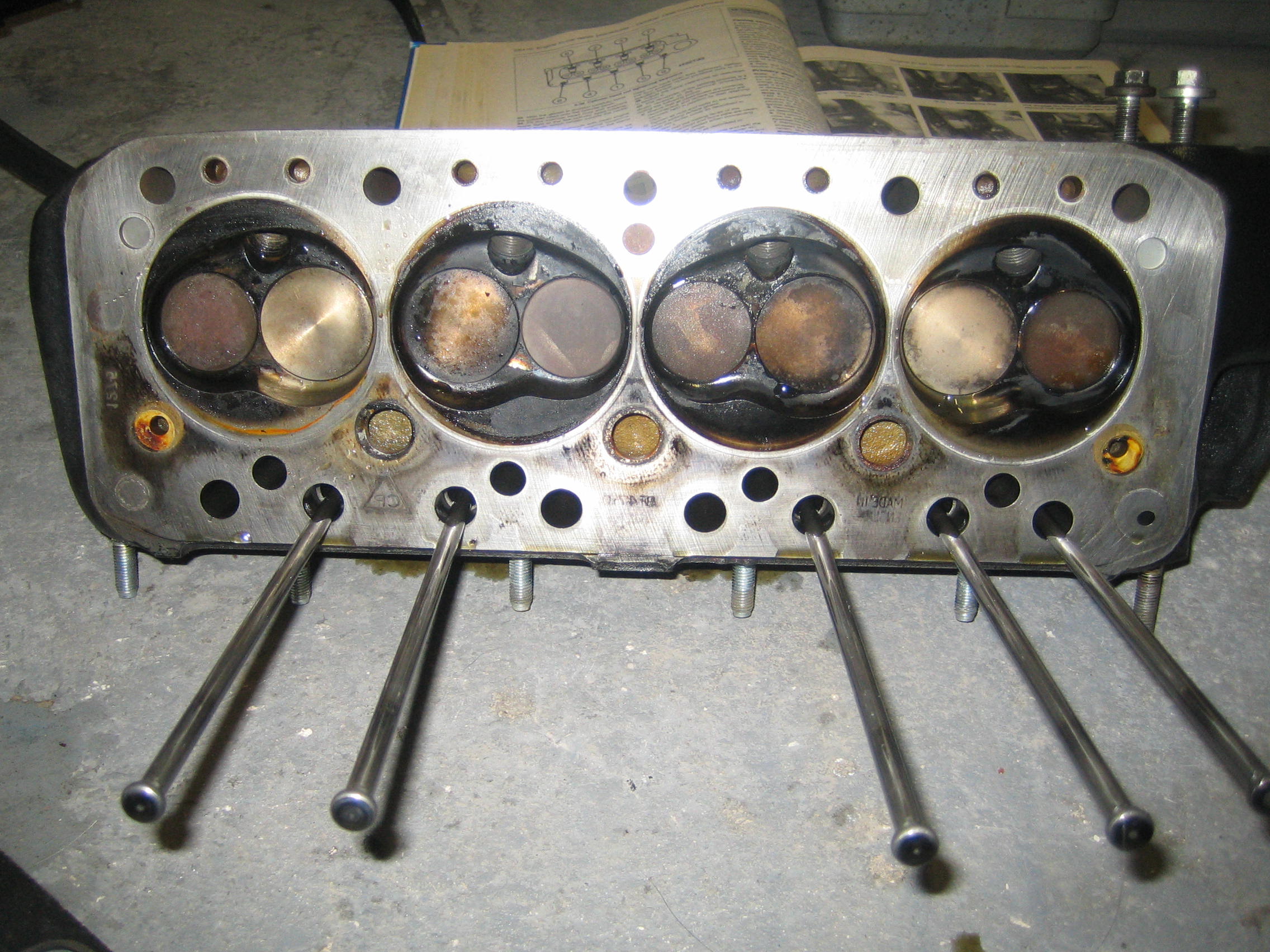

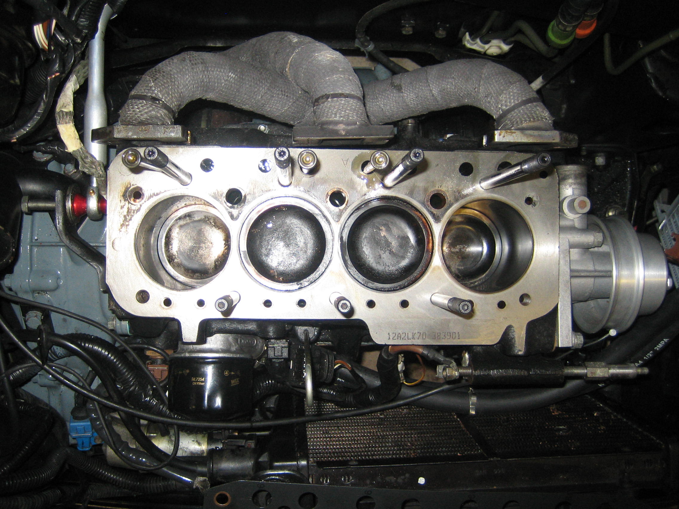

Right chaps, just got the head off an i measured the crank pulley at the same time. I struggled to get my verynear on the pulley but i got it at 115mm which as gives me a ratio of 1.77:1 with the standard 65mm blower pulley.
I cant see any damage at all to the pistons but the centre 2 have much heavier deposits on than number 1 and 4. I take it this is probably whats left from the oil i tipped in to the bores in the couple of weeks before i started the engine.

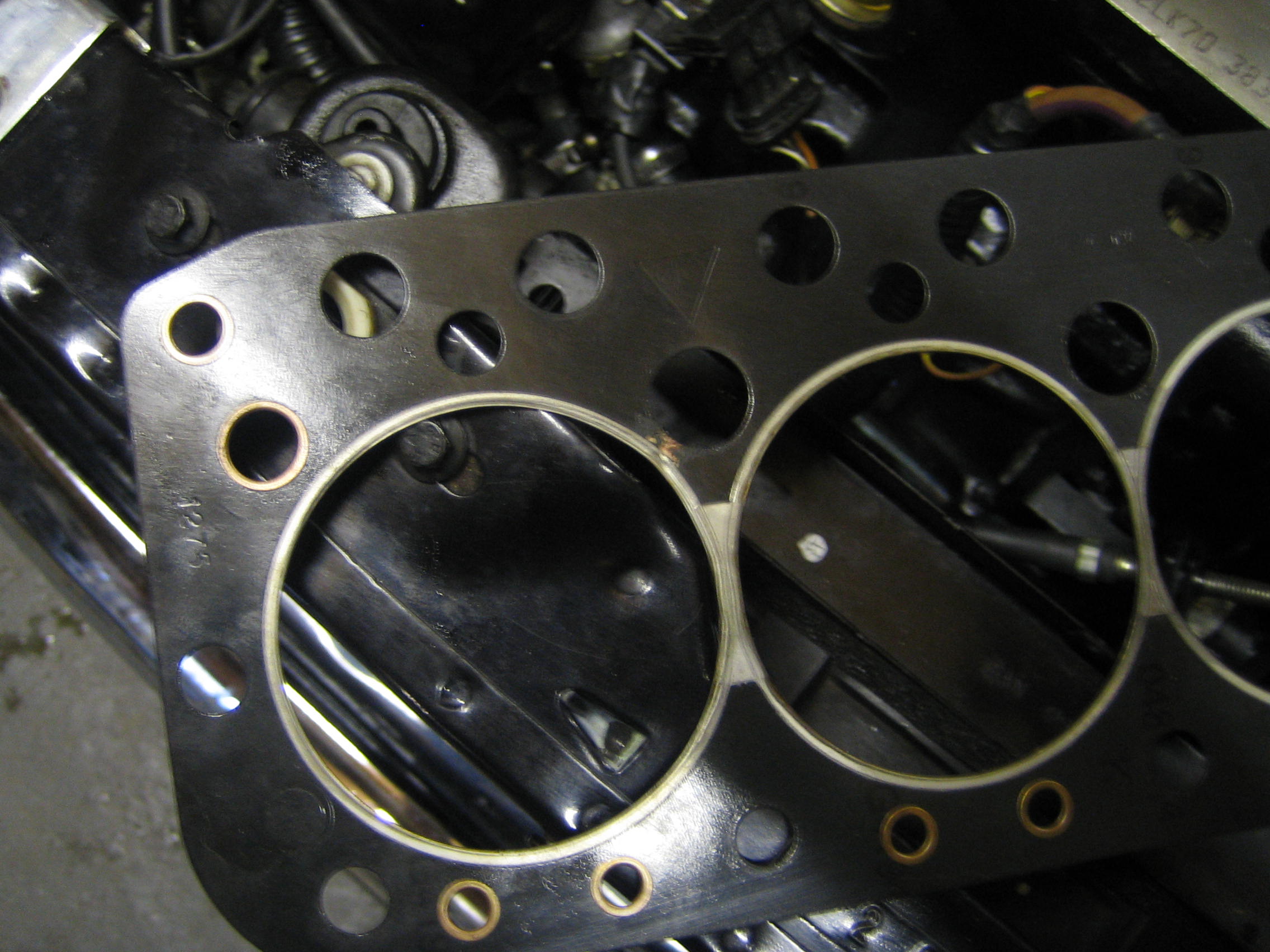

The HG has gone between cylinder 4 and a waterway as expected. See attatched pics

More likelly it's because your outer cylinders re running leaner than the inners as the fuel is not being injected at the right time. This will continue to happen.
Stick an AF460 gasket on it *wink*
Some people have no problems with the BK450, while I have had them all. Swapped to the AF460 and i havent had an issue yet.
IMO *wink*

The gasket in the picture above is a BK450

That almost looks like something was trapped in the fire ring when it was bolted down (2nd pic)

Hi sprox the gasket is stamped with AF470 not AF460.
I know about the charge robbing but i take it that there is nothing i can do about it? as it already runs a 'wet' manifold set up?. Is it likely to cause any trouble?
As for the HG thats what i thought as there didnt look to be any specific damage to the firing ring but there was a little pile of corroded shit out of the head sitting on it. Maybe it wasnt cleaned out properly? or maybe it just came out when i lifted the head off? i guess i will never know?

Its a BK450 with some extra copper rings around the smaller coolant passages *wink*
