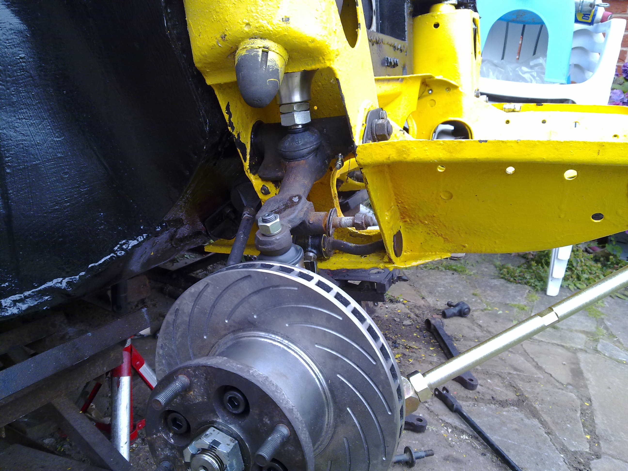

Wohooo my brakes have arrived, well some brakes have lol, i ordered the 8.4 kit and got the 7.9inch kit, i couldn't decide witch to get in the first place, im just going to keep these, no pics as yet bum im hoping to get the rear subby back on next week, its all go!! :)

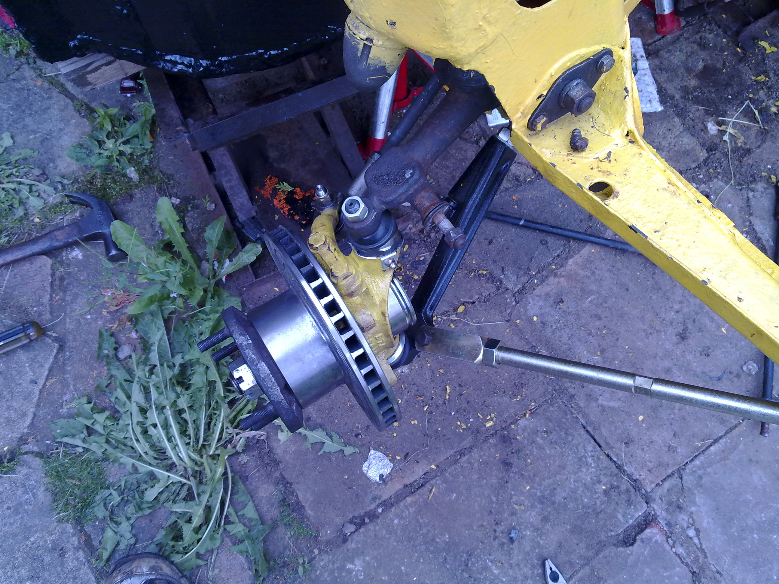

there is a few bits and bobs left to do on the front subby, the top arms never got painted because the hamerite yellow paint is shite and just flakes off :( and rather woryingly the ride hight at the front is stupid, i know there is no engine and it needs to settle but its got maybe 3-4 inches to drop before im happy and the adjustable cones are fully wound down :(
It will drop a lot more once the engine is back in.

Where did you get those bolts for your disks? They've given me a a semi!
there high tensile Allen bolts think there tensile rating is 10.9
came with the discs, i had to bore the wheel hubs out by 0.4mm as there slightly larger than normal
a semi over the bolts *surprised* wait for the calipers *happy*

Ahh mate, the black and yelow looks wicked!

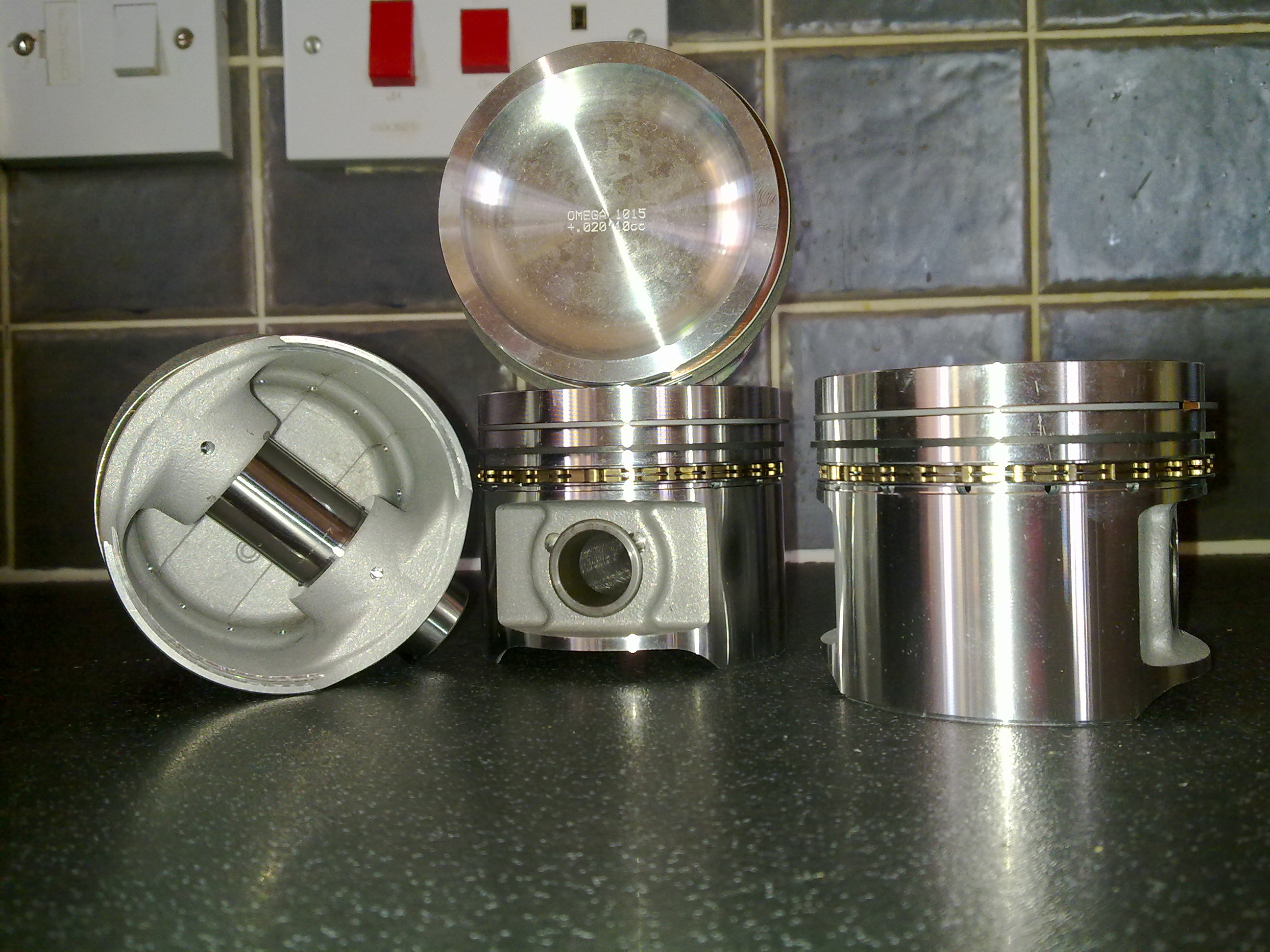

just a quick update, the engine from minimadmotorman is fully stripped, and been to the machine shop to have everything priced up, all the work on the block can start as soon as i get my hands on some pistons, accralite are out of stock in +20 and +40 thou 18cc.. witch leaves avonbar or some cheaper pistons

Have Accralite got any 73.5mm's in stock?
Otherwise go with the cast omega's they are well proven.

i didnt ask only asked for 20's n 40's dont want to waste too many rebores 'just' in case *happy*
i just bought some cast omega's in +0.020 from MED aswell *happy*
they was very helpfull, may i add aswell :)
10cc one's? If so they do look the nuts.

yup*happy* just done a quick compression ration calculation and im at about 9.6:1 ish

well to my surprise my pistons turned up at 11:30 this morning so i make that 19hours and 38 minutes from paying to delivery *happy*
mmmm pistons
