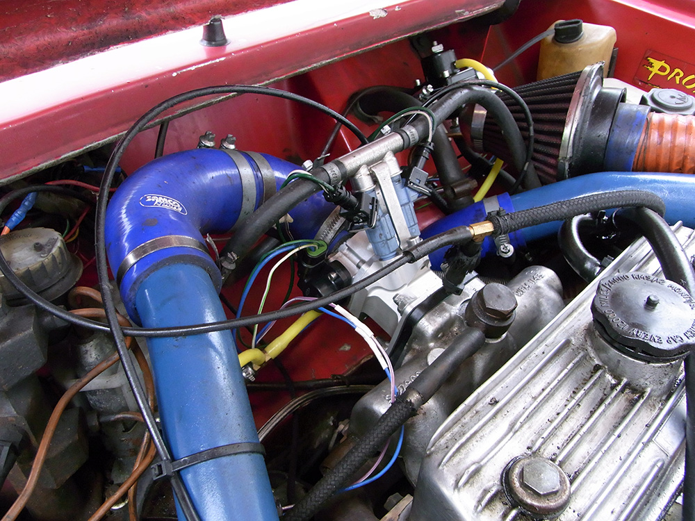

Any more pics I can look at? You got MAP only or TPS there?
1132cc Turbo ~120 bananas ATW - Fun Fun Fun
When I looked at the car pretty sure there is a MAP sensor on there.
MAP and TPS, yes. All fuel and ignition referenced to MAP, TPS used for acceleration enrichment.
That's the best photo I have really, this one show's less.

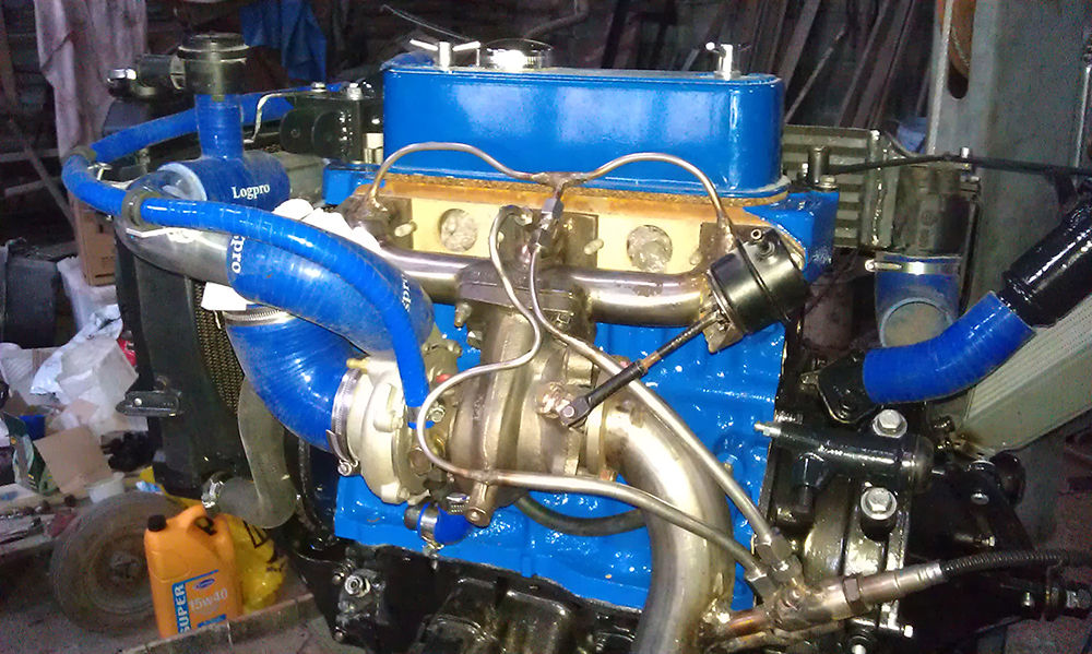

Rod/Paul - can you please do me one thing, I looked at a photo with the pipes coming up to measure your AFRs but not 100% on how its done on yours.
I am thinking a 5mm s/s pipe welded onto the 2/3 runner and 4 runner with the fitting for the O2 sensor on the end right? Have I mis-read your AFR sampling setup?
Peter (the SC TBI/Blow Through Turbo/ Smallbore) Pioneer lol
I used 6mm stainless pipe.
You can also make them out on this picture between the turbo and the head:
Edited by Paul S on 2nd Nov, 2011.
6mm OD for me too (compression fittings, not welded).
Then about 16mm after the chambers down to the exhaust after the turbo.
The principle is to keep the sample chambers at post turbo uniform pressure irrespective of the pre-turbo pressure and temperature.
Thermocouples also in this photo.
Hope that helps.

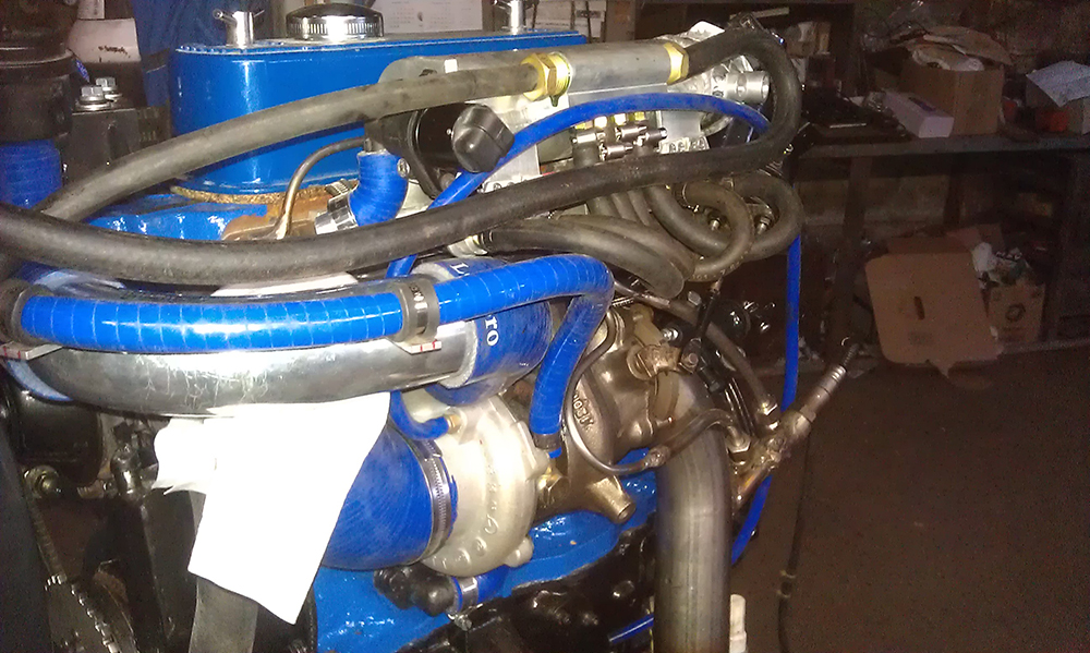

A bit late, but here is how I have my O2 sensors piped up.
