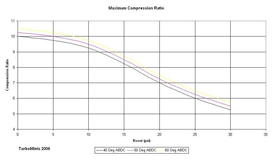

Head is 28cc's, it's one Benross did for me,
I've been using the AFRacing cr sheet,
The block deck isn't in bad shape, and is original heigh, without a scim I think I'm looking at 8.15 static? with BK450, MG NA will be cam choice.
Based on this chart, I am looking to run upto 15psi, reliably:
Nice intercooler, super unleaded etc.
I just think 8.15 might be a little on/off in terms of power ? Although I guess 8.2 won't be much of a difference ? Having said that my last set up on a 1310 same head, came in at 8.38 static and drove ok.
Perhaps I should leave as is ? What grit paper should I clean the deck up with ?

What CC in the head do you have that has brought thr CR down below 8.2?
There is not much to come off the block before the pistons are flush with the top, the turbo pistons are already near the top.
Edited by Brocky on 6th Nov, 2012.
Which turbo? 15 psi is conservative. We had a 28cc head on the same bottom end and worked it out to about 8.3:1. Lots of scope for more boost in there!
It was more like 8.16:1 *wink*

T3 with Benross ported/knife edged manifold and ported elbow, 2" dp and Avonbar modified actuator,
How much boost can you get before you go 360 thrust?
Have also been looking at doing a GT1752, but quite like the T3 driving experience...
I don't think I would run a standard Metro T3 much above 15psi.
How about a GT2056?
