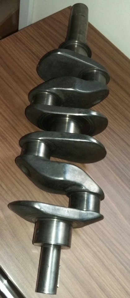

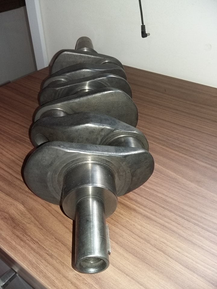

So this week a worked crankshaft from Carl at Force Racing arrived *wink* It has been wedged, bladed, back drilled, balanced and hardened.
4310 Posts
Shame to put that in an engine, work of art.

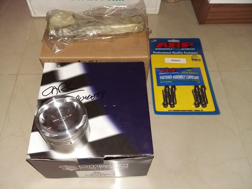

So just a little bit of an update ... The pistons and rods have just been bought. Pistons are the 18cc +20 forged from MED with floating pins, and the rods are also forged from John at SC components. They will also be taking care of the valve cutouts. In total this should give me a CR of around 8.9 and planning to tuck in around 20psi boost.
The next thing ahead now is to plan for the main bearing support (just seen the new item from MED), and a decent gearbox.
Do you guys recommend a good read on a box choice ? I've never experimented with different gearbox configurations so far, so before spending any money I wish to give it some thinking.

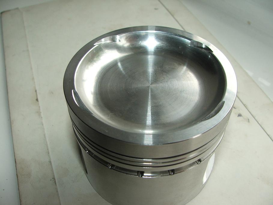

Evening chaps, looks like Christmas came early this year *wink*
Blimey, how much lift are you intending on running? Those are amazingly deep cut-outs...
Actually, I'm thinking they look deep enough to never contact the piston no matter what the timing - about the only thing that will hit the valve is the one across from it!

Yeah to be honest I thought so as well..
I guess SC do it like that to be able to run their big valve conversion ?
Yeah, I thought I had seen somwhere that these can be non interferance, (which I like the idea off despite the drawbacks) not managed to confirm it though.
I need to get a couple of sets of pistons done at some point so was going to find out then.

what are the drawbacks then of having deep valve pockets ?
I assume weakening the piston by having removed off excess material ?
basically that really,
weaking the piston, although not really seen any exidence of them giving issues due to this, also a it of a dead spot for the mixture to sit in.

I think the valves will still contact the pistons. Main reason the cut outs are so large is to get round the difference in valve positions in each cylinder, and, the difference in the head location on the various vintage of blocks, one size fits all sort of thing.
For comparison, these are my 18cc pistons machined to match the OEM BMW piston. Somewhat smaller, but the engine block has a significant more machine work done to get to that point!
