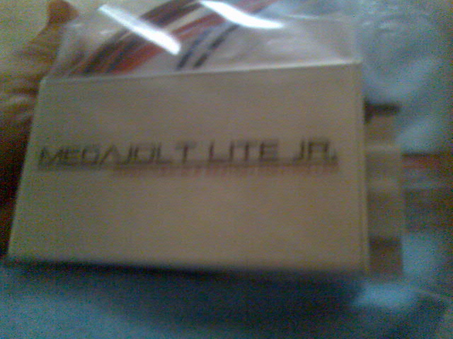

look what arrived today *tongue* i'm a happy chap! just gotta sort a trigger wheel & a trip to my local scrappy for the coil pack,eidis & sensor & i'll try to have a play to get her running on this, maybe i will have megajolt for the turbominis rolling road day if i can get there, should ok for it though

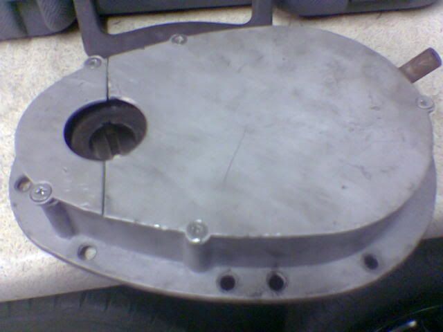

woo hoo! i got me a non-vernier belt drive today, 2nd hand but it seems all in order, gonna replace the seals & belt, best too anyhow! & i'll see if my dad is feeling friendly enough to po;ish the case *tongue* or if he cant be arsed then i'll clean it up & paint it! it was cheap too so i'm not complaining,

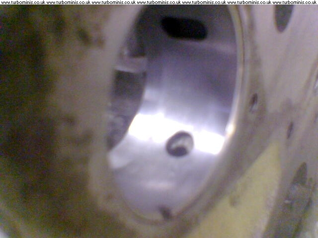

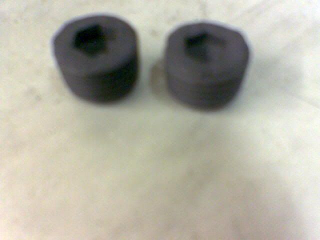

well i sorted my threaded galley plugs this eve, found some in the size i needed but had the cut them down 3.5mm, i hope the seal properly! i think they will though to be honest! super confident in my home engineering this eve hehe! i'vwe got them to sit just below the block face aswell so all will be well
oh they are allen headed bolts too!
pissin me off i cant get my pics up though!

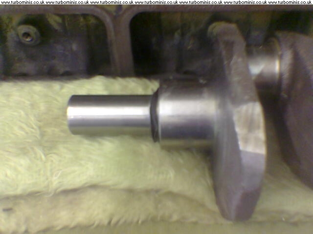

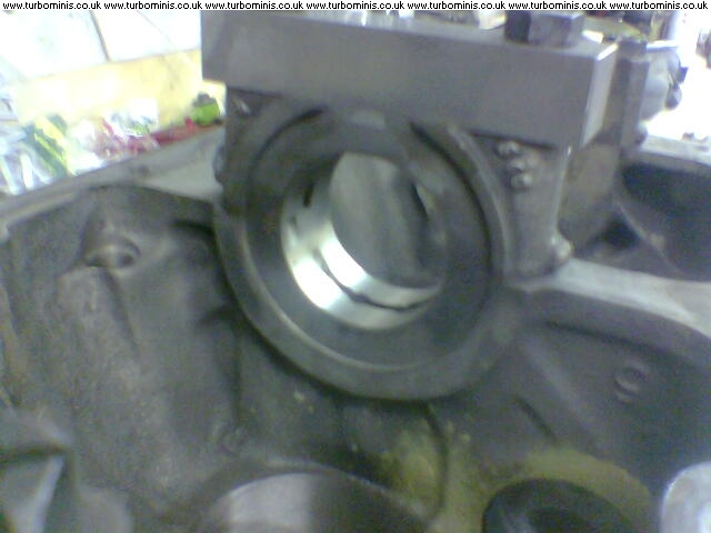

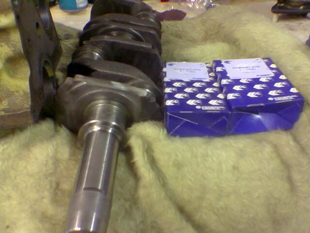

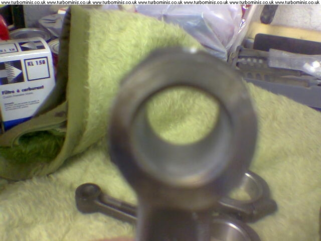

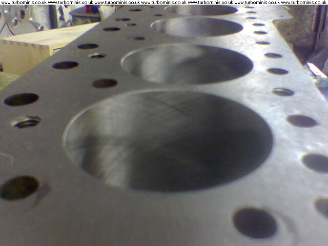

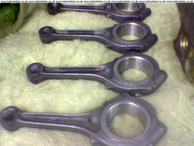

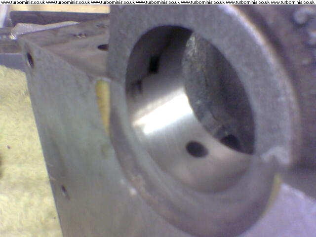

blummin heck at last i can put some pics up of some engine parts post machining! *happy*

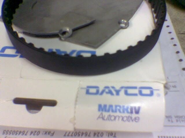

i'll get some pics of my belt drive setup later tonight, my local engine parts supplier got me a new belt for £11 which is a little cheaper than minispares i think, i still need to get some new oil seals for the belt drive but i think they are obly £4 for the two!
i'll do some better pics of parts & the engine build once it gets underway!
next step, block cleaning & painting!
any advice plz do! i am a novice to this lark!
hey! check out my pimp blanket *happy**tongue*hehe!
Edited by clubminiflip on 11th Jun, 2007.
mikemph
450 Posts
Member #: 449
Oxford
Make sure you run a countersink over those head stud holes it will help to reduce the chances of the threads pulling out and the head gasket blowing
clubminiflip
1840 Posts
Member #: 54
nr coventry
my oil gally way threaded plugs!!! they look ok dont they?

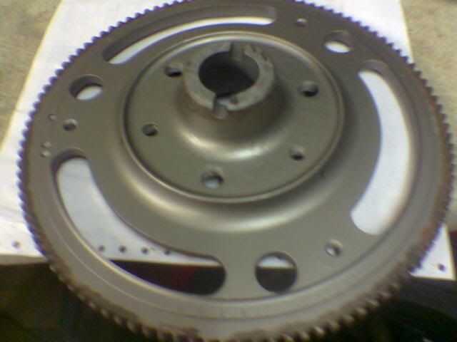

flywheel

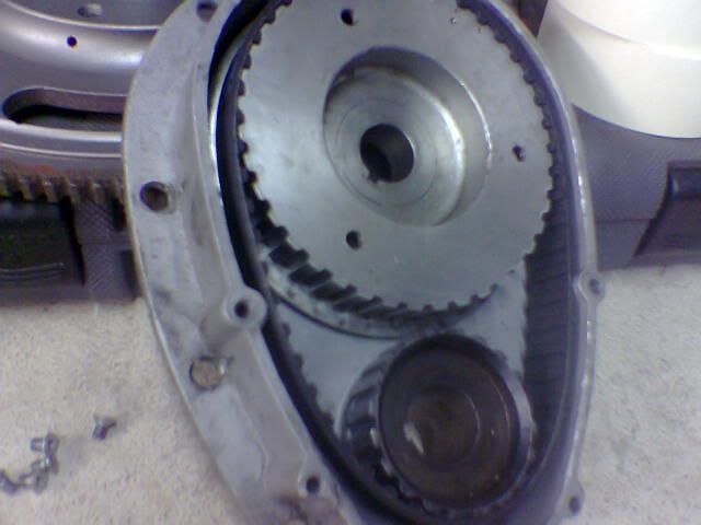

bargain (i hope) non-vernier belt-drive kit with new belt!!! it'll get new oil seals & a clean up/painted, if it looks like any parts are missing plz say! i did'nt pay much for it
is it best i countersink the headstud threads then? any other block mods i can do at home before i clean/paint the block & start bolting bits togther!

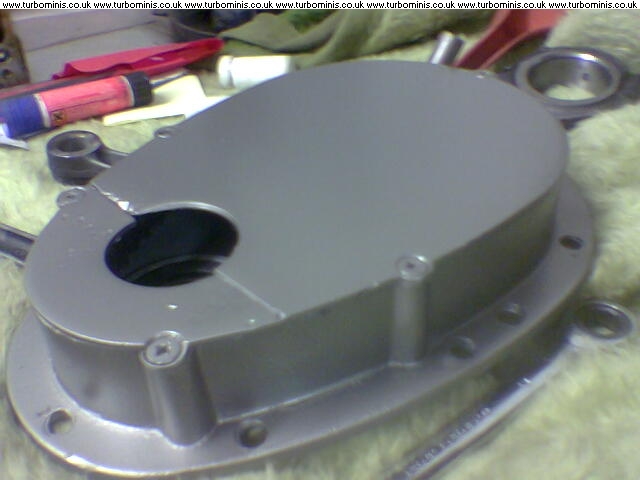

cleaned & painted the belt drive housing & the pulleys this eve, also remebered the correct bolts for all the parts of the block, ie alternator bracket, oild filter housing etc etc, next job is paint the block i reckon, i have a can of yellow smoothrite!!! i'll sort some pics as the build progress's

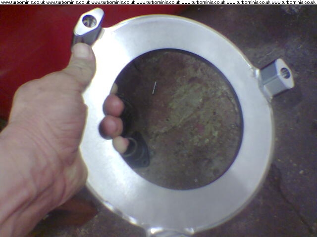

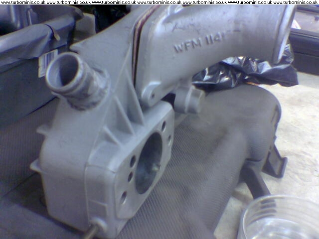

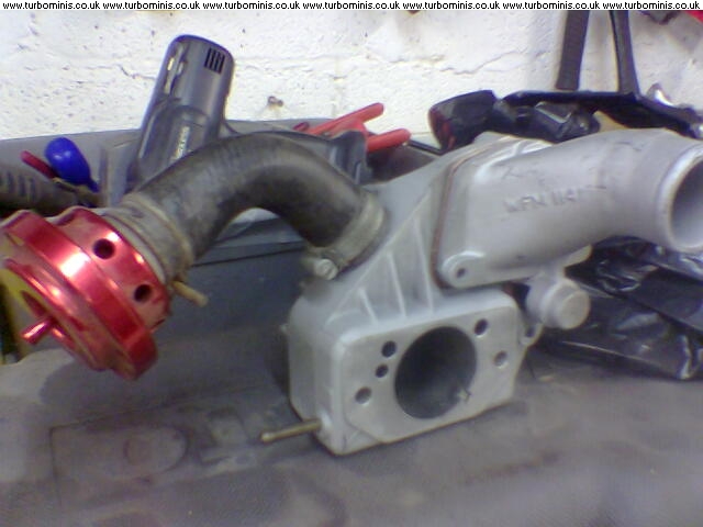

made this today! the dump pipe probobly wont be the on i use & the dump valve itself i cant remeber where i got it, what do ya think chaps!
also splashed out on this to go with my flywheel *happy* lol
i really should have stuck with a triangle QH type but i got tempted & feel silly for getting it! it matches the flywheel though i thought
cleaned up my belt drive casings & fitted new screws as the old ones were foobared!
i've beed setting the straps on my flywheel/backplate too! i made spacers for the flywheel bolts from the tubing that goes inside the poly bushes on engine steadys, seems to be plent tough enough, i'll get pics of that soon, i think i'll do my 998turbo engine build as a separate thread so its clearer as to what i've done & if you chaps give me advice on it its contained to the that thread, hopefully start that this week if i get my crank pully & rotating assembly balanced! fingers crossed *smiley*
