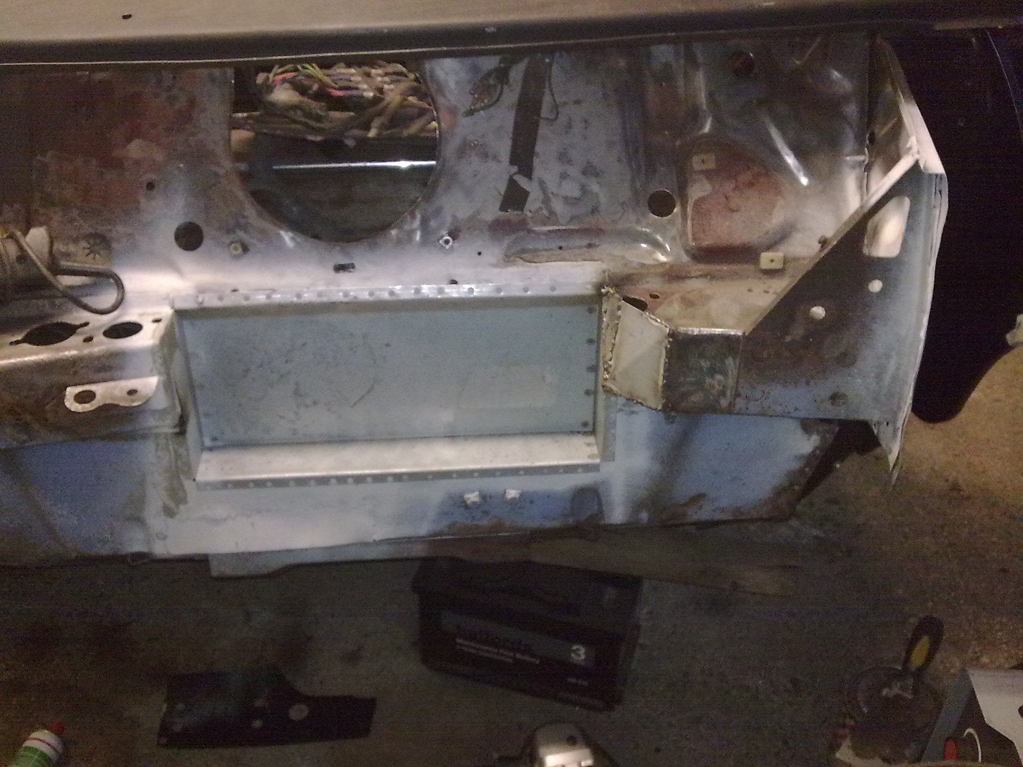

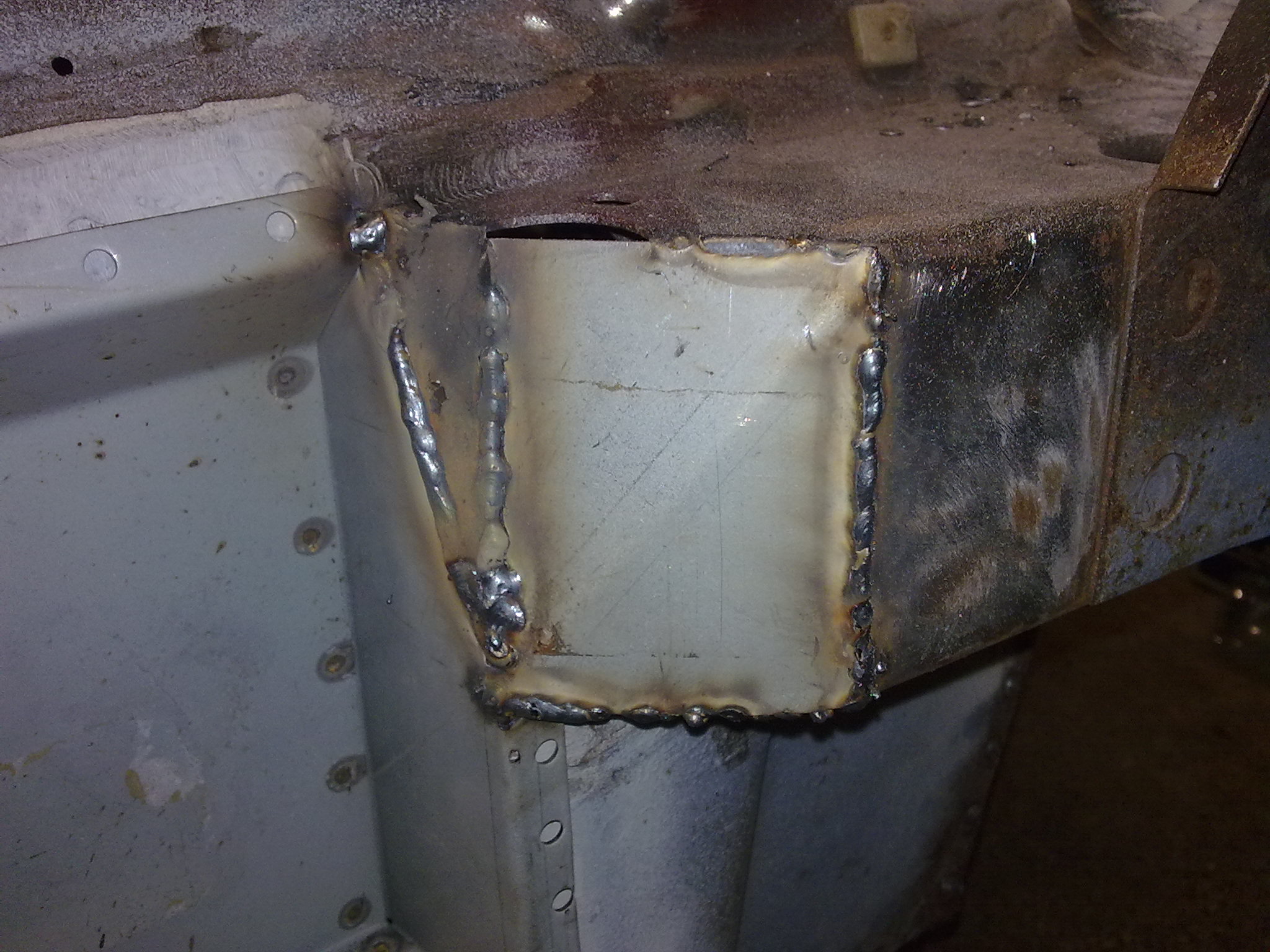

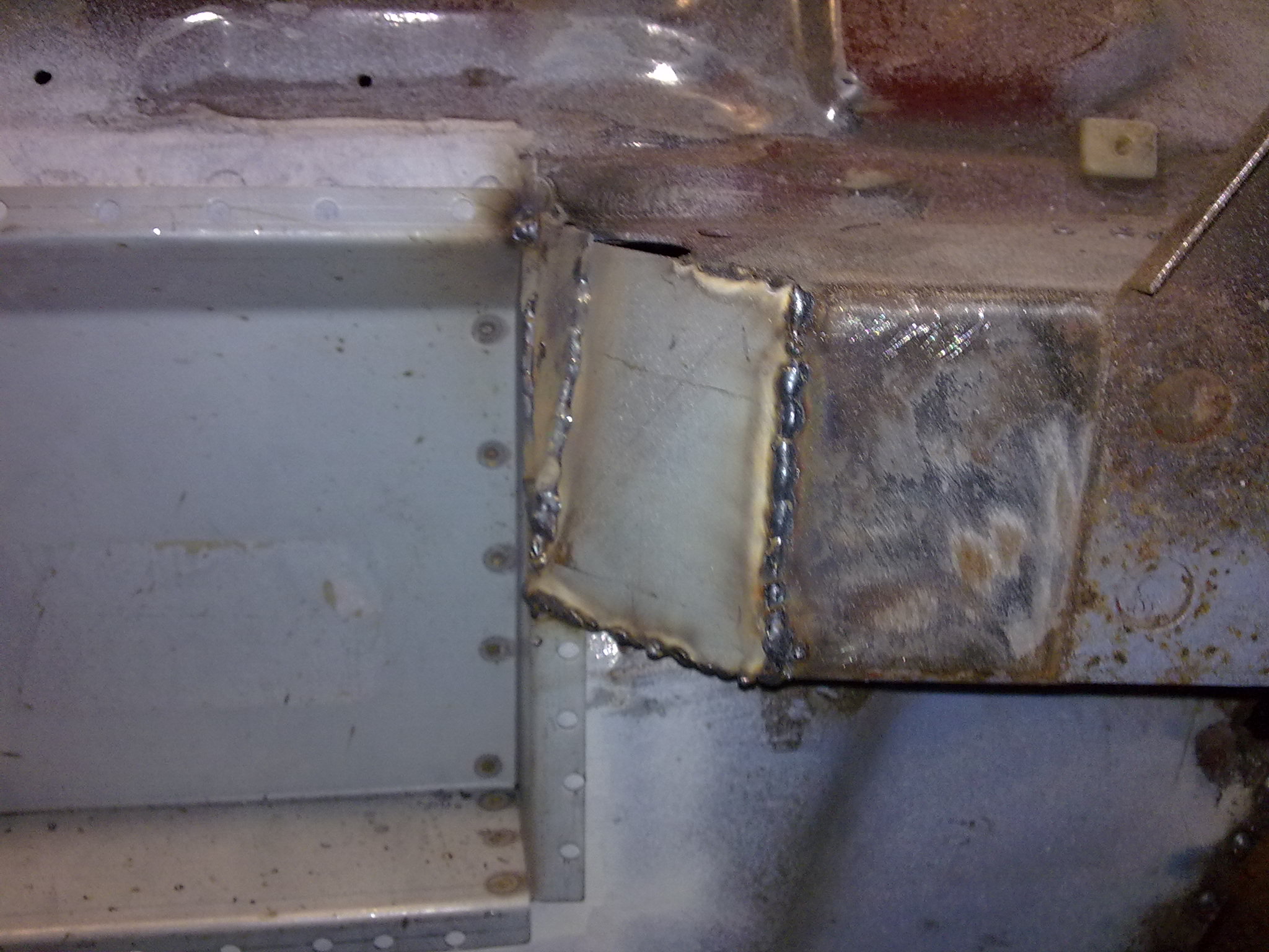

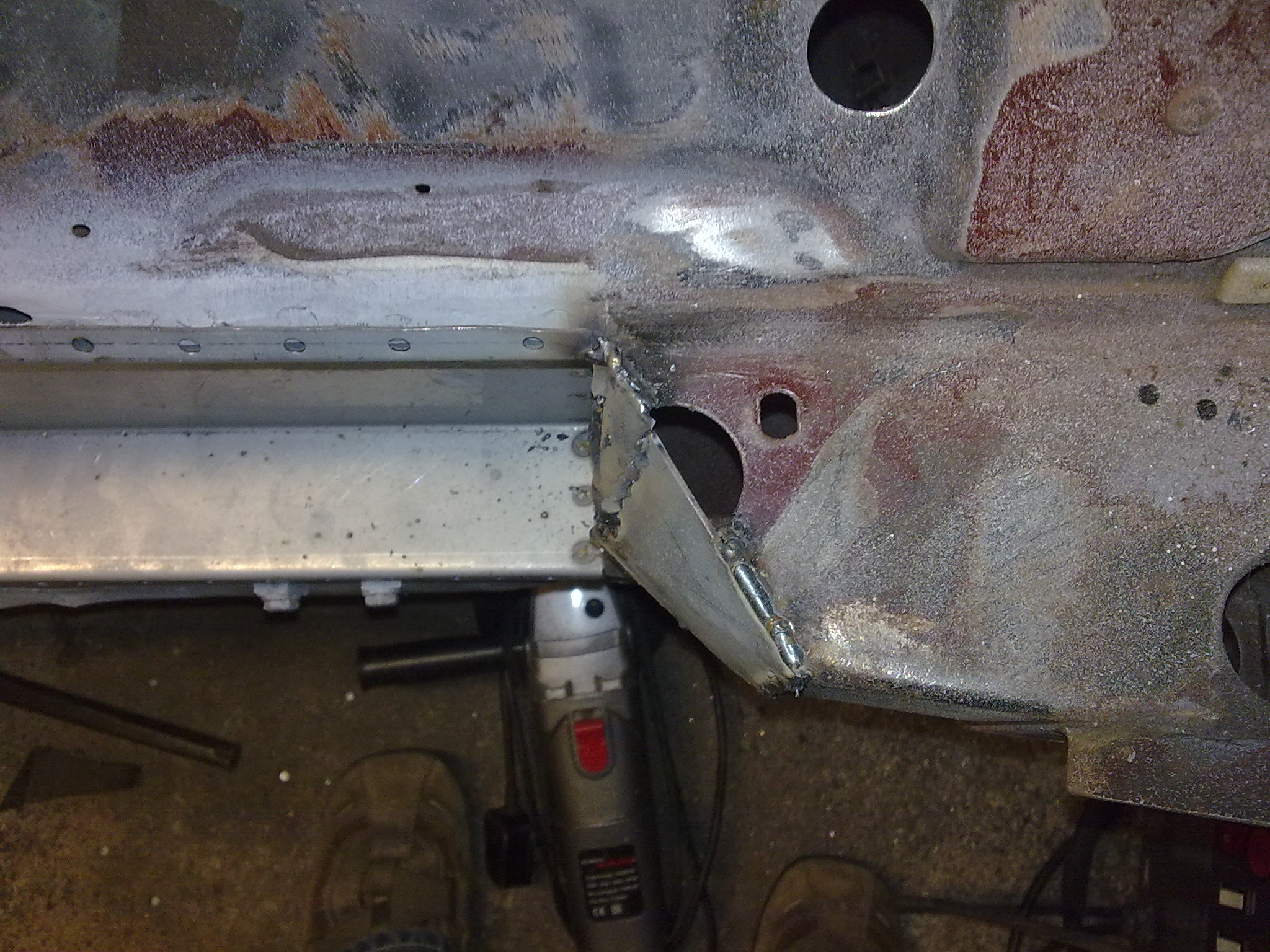

I bought a turbo box from Avonbar some time ago but only just got round to building the car. It came with the main box plus a separate blanking plate for the nearside end of the box. I couldn't work out how on earth that plate should be fitted. It just didn't seem big enough. So using the pictures here, I think I've got it roughly right. Here are some pictures. I am slightly worried there's too much bulkhead left. Perhaps someone could give me their oppinion. As you can see, I've had to add an extra triangle of metal to bridge the gap between the plate and the box and I'll have to fill in the old heater hose hole.

I cut my cross member out all th way to the brace on the near side. That gave me the extra space for the induction pipe. It also looks like my box is slightly wider than yours.

I see on the Avonbar website that they recommend moving the engine forward half an inch. I assume this will help clearance at this point too.
Mr Joshua
2498 Posts
Member #: 1954
Luton Bedfordshire
Stop the turbo smacking into your new lovely box.
