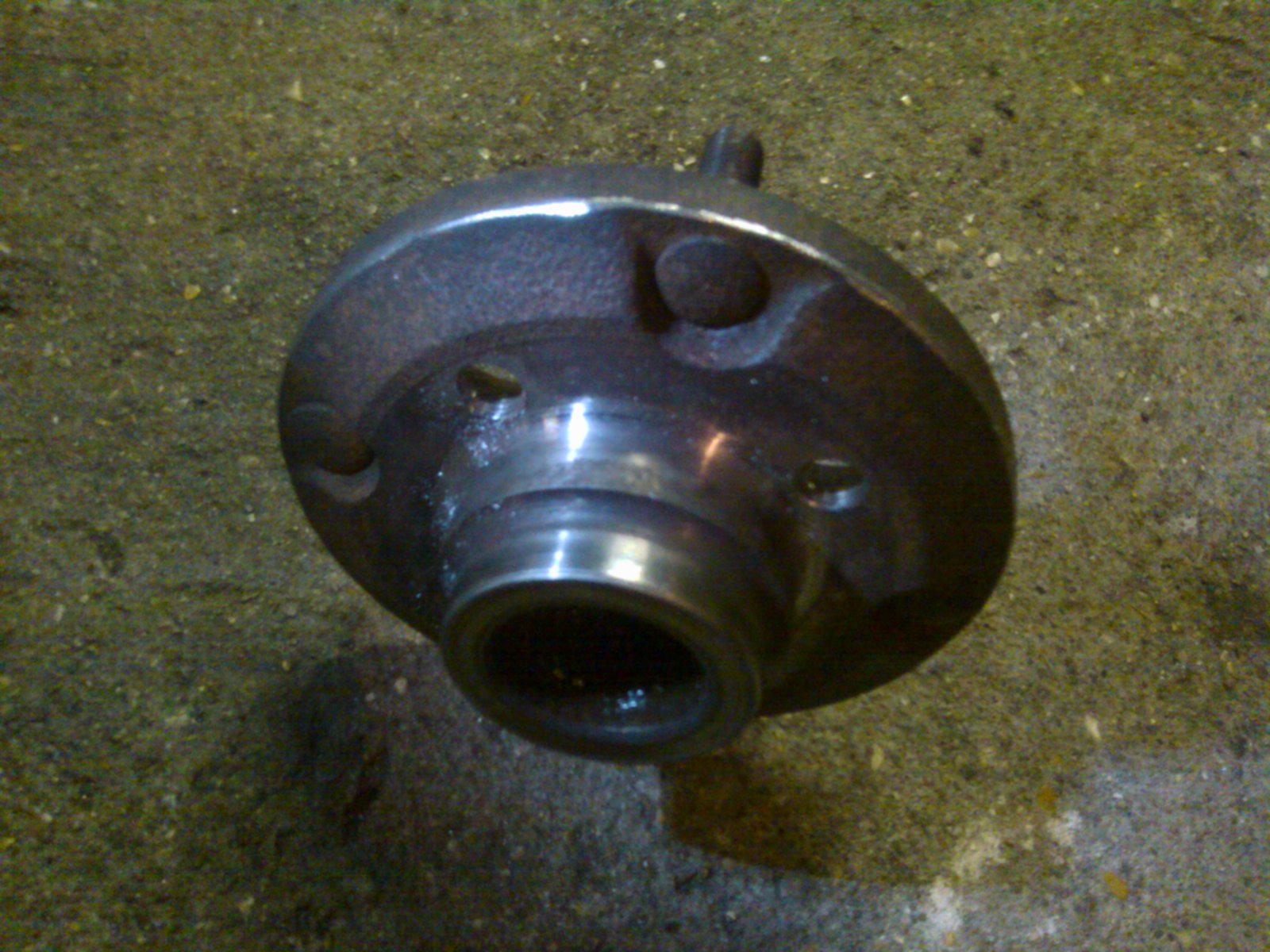

Downside is I found the LHS as got a Metro hub and bearings falling off for no reason ...
Second downside is I found out I'm better off with Metro hubs as they help with the wheel not hitting the front of the wing when turning on full lock ...

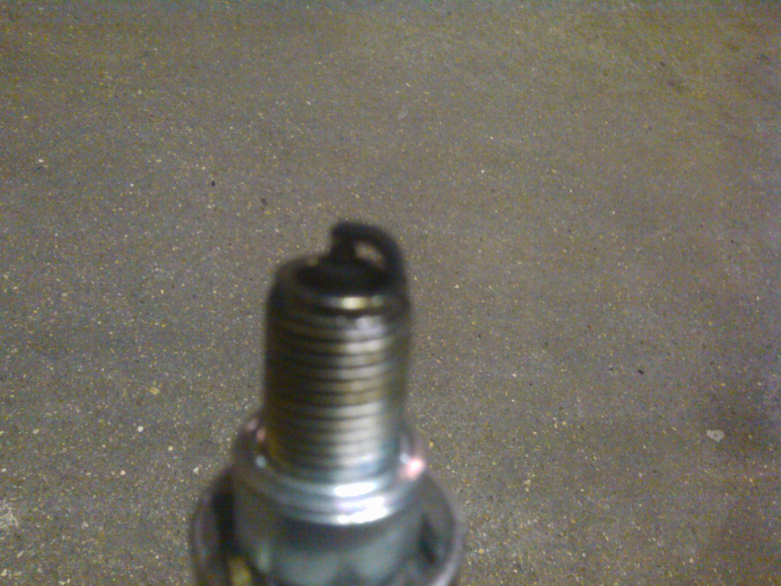

Plug n°4 (clutch side)

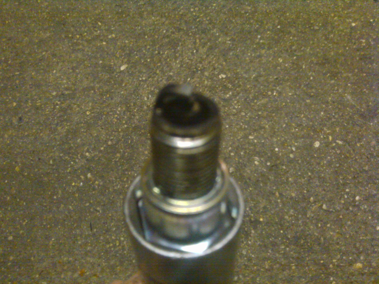

Plug n°3

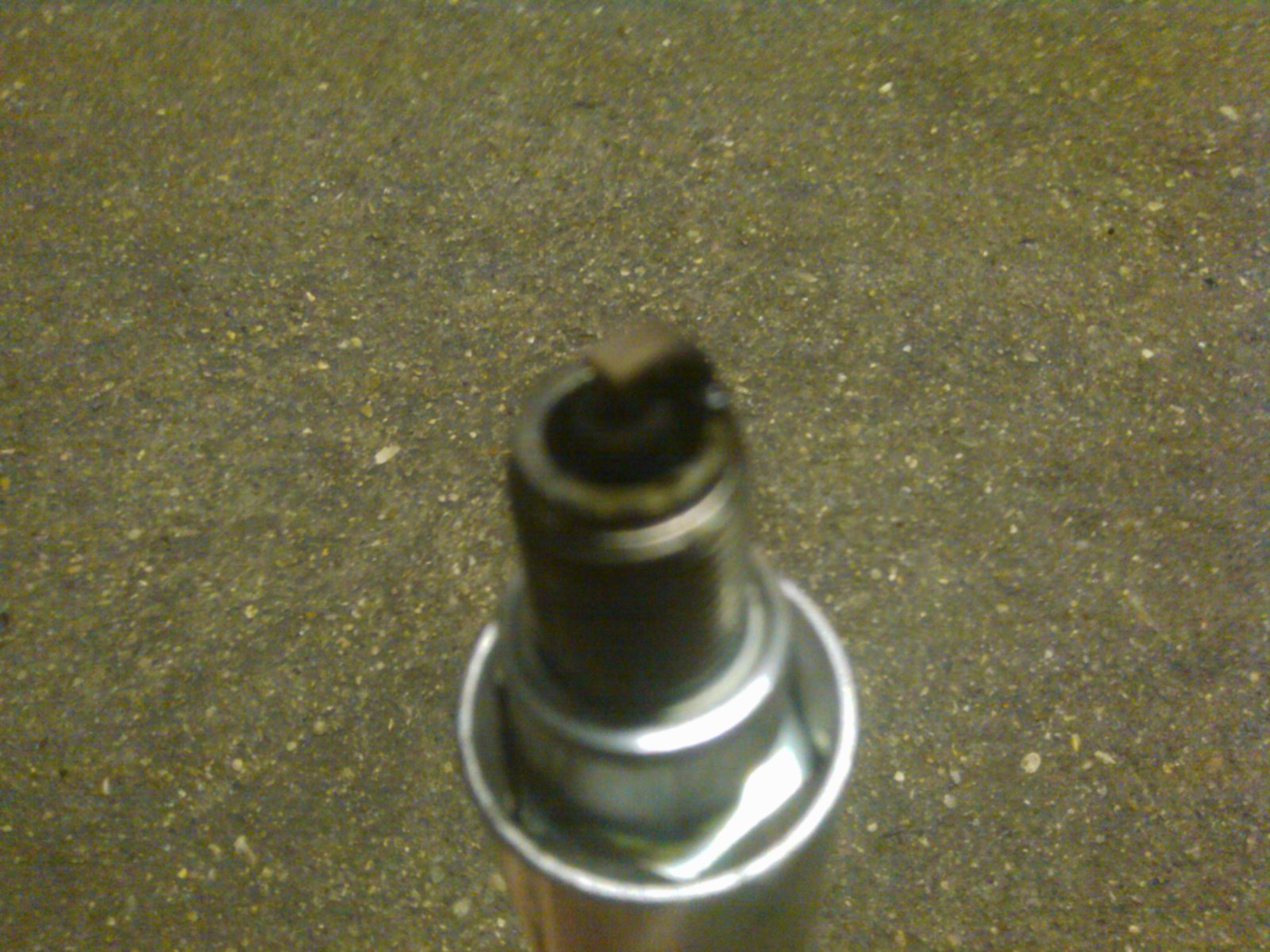

Plug n°2

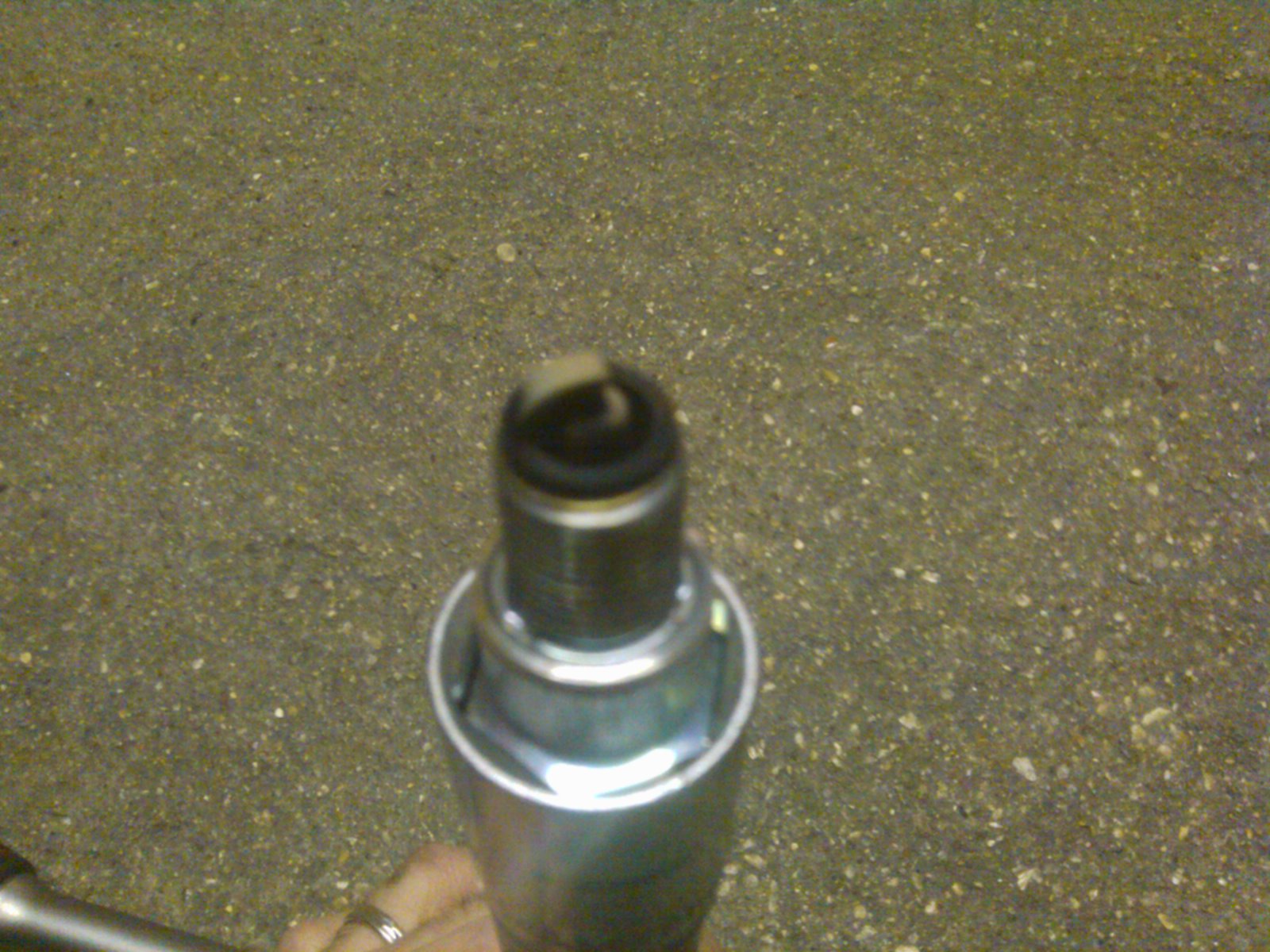

And the loser is :
Plug n°1
And that is after roughly 10 minutes of running.
Trouble is I cranked the engine over with plug n°3 then plug n°1 out and they both have sparks so this kind of rules out electronics problems.
Now I'll have to have a leakdown test done because I have been told that if the compression is very weak, the mixture can not be ignited hence the wet and black plug.

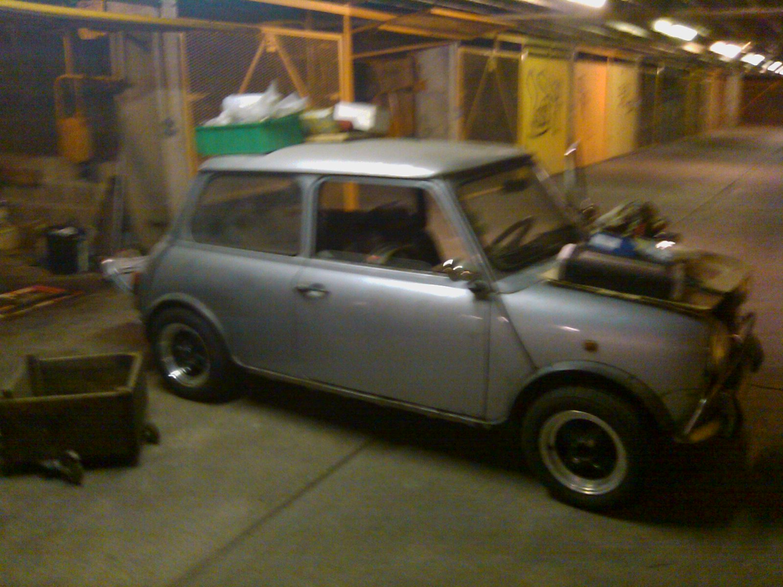

pic of my car
Rear need to go up a little but first I have to get rid of that oil leak from the transmission.
